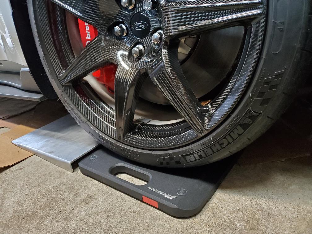

Thought it would be a lot heavier. Roll bar was advertised @ 52 lbs, DOCOL R8 and I turned
2 point kickers, into 6 point kickers, using slightly thicker wall DOM. I didn't weigh full cage/bar , but calculated about 70 lbs.

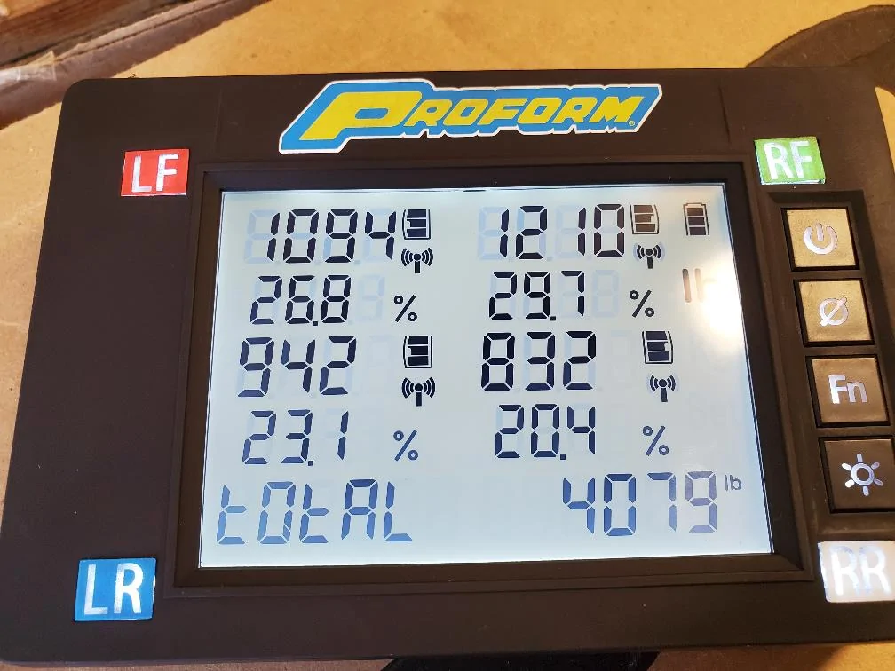

My CFTP was 4010 from the factory with less than half a tank of fuel.
Last time I weighed mine before the cage, I had 4079, 5/8th tank.
Only non stock things then was Radar/lidar system, PPF on nose (only),
IRS supports/lockouts, and CAI. I think I removed spare kit/stock tow hook/floor mats.
4010 is I think the lightest I've ever heard (from someone that weighed it themselves).
Anyway, I'm surprised with cage and IRS supports, to be only a hair over 4100, but
my car with the same amount of gas as you, could never have reached 4000ish.
(assuming things I added/removed @ 4079 weight mostly canceled each other out,
and the 24ish lbs difference in gas weight of 5/8 vs 3/8).
Maybe my scales are "heavy" (which would make me happy)
other ref's I found
4006....... (1 gallon gas)
https://www.steeda.com/steeda-2020-shelby-gt500-build
4054 (gas not disclosed)
https://www.motortrend.com/reviews/2020-ford-mustang-shelby-gt500-first-test
4052 (gas not disclosed)
https://fastestlaps.com/models/ford-mustang-shelby-gt500-s550
4067 (gas not disclosed)
https://www.caranddriver.com/features/a35368171/2020-ford-mustang-shelby-gt500-lightning-lap/
4120 (with full tank, which supposedly weighs 99 lbs)
With all that and your weight, my scales might be reading high.
But upside is I "corner weighted" the car by accident
(was 25% difference, now 13%) and moved weight distr
from 56.5/43.5 to 55.6/44.4, so there's that ...:)

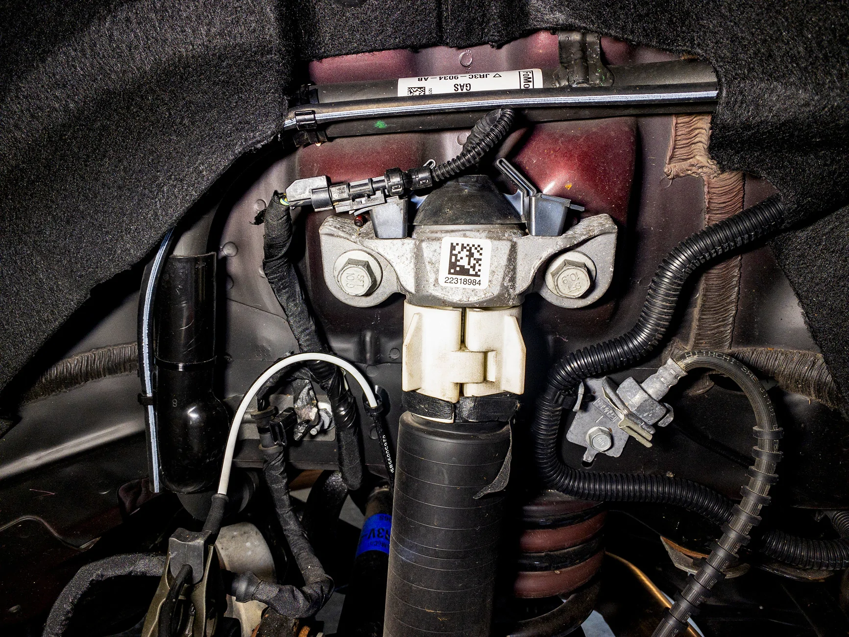

Oh, and how could I forget. Big weight savings from removing front spring shipping supports.
On the car for it's first 2600 miles until I got it.
Lmfao great PDI eh !!
Ditto but in my case, it was the rear shipping blocks. The wife and I both kept saying,
"This car rides like an empty truck!"
Only took about 800 miles. <laughing>
