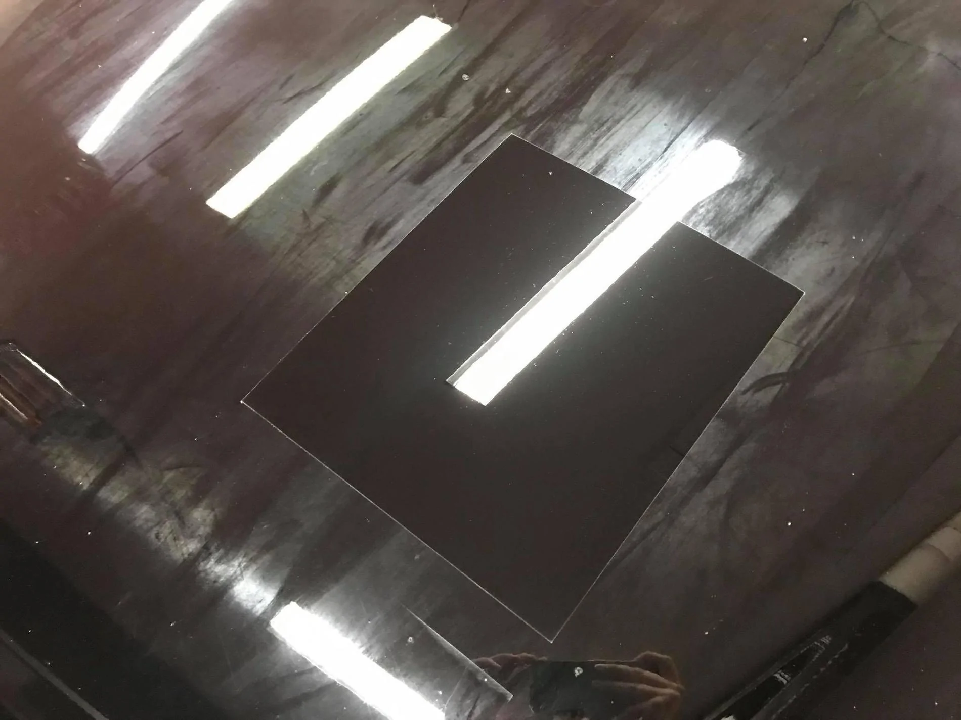

Ceramic coatings are really easy to apply. Have you guys not tried doing it yourselves? I can't fathom paying over 1k to have someone do that. A wrap maybe but ceramic coatings are as easy as waxing a car. Maybe easier.
And that's why a detailer near me just had to work on this car after a guy "tried doing it themselves"

Ok I think the person that did not knew nothing about CC or car paint care short of maybe washiing. With the amount of information on the web on showing you every detail of the process, you really can't f up that bad. Sure maybe a couple high spots or a small smear from not wiping properly all the time, but not like what the picture shows. That is just a complete fail. I agree with others that the hardest part is the prep, putting the coating on just tales some patience and attention to detail. Heck my 13 yr old did a couple panels on my R32 and it looked great. Sure I was there and but I am pretty sure he would have done ok without me. He prepped himself by watching multiple videos. He also did the prep work on most of the car. I guess there are just some truly inept car owners out there, so who knows.
