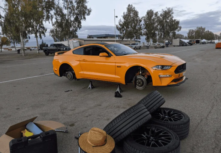

The triangle here points to the jacking location, there’s one marked front and rear. You can see my jacking rail in the pic as well.

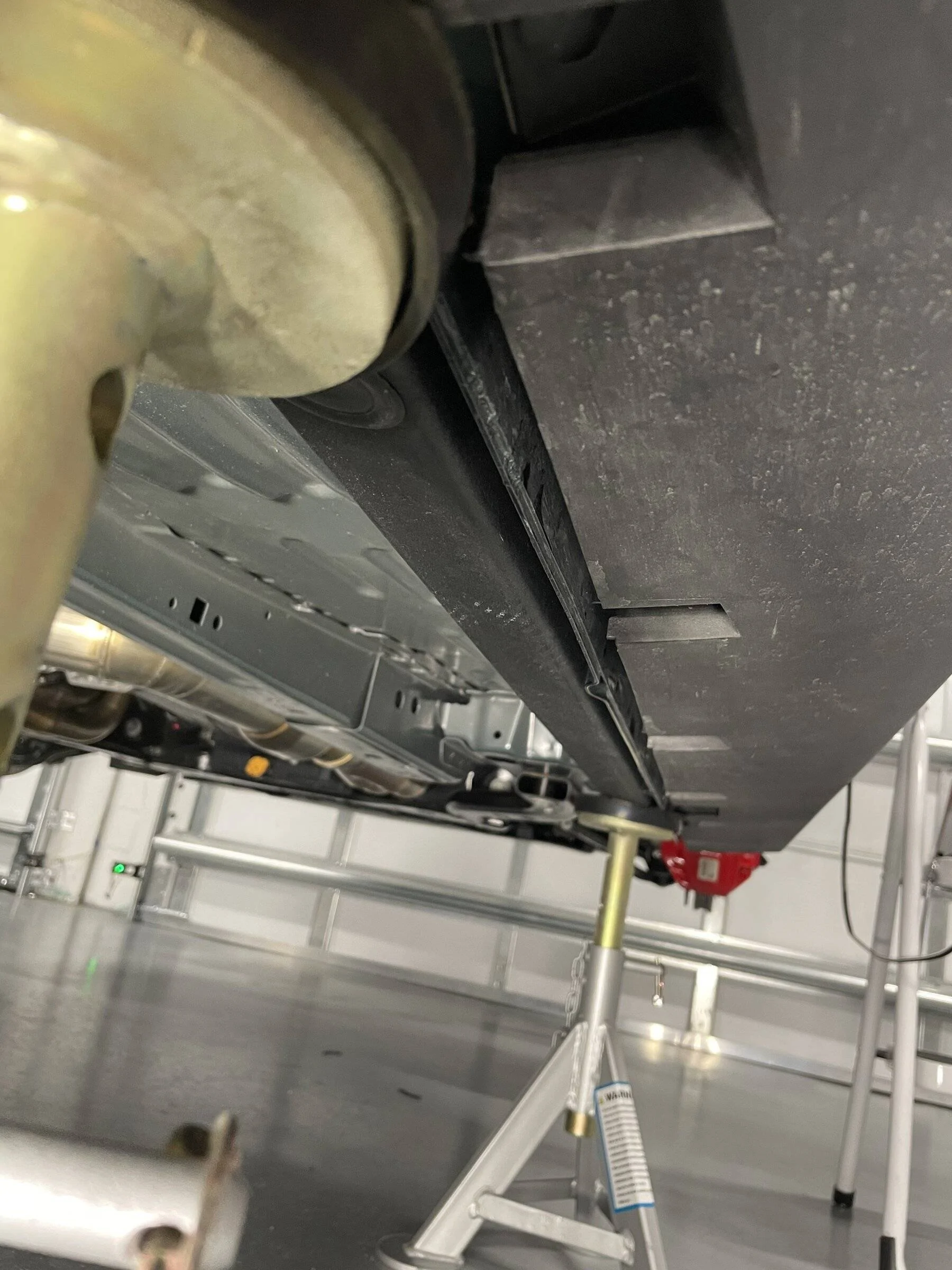

Not the most detailed picture but it may help
