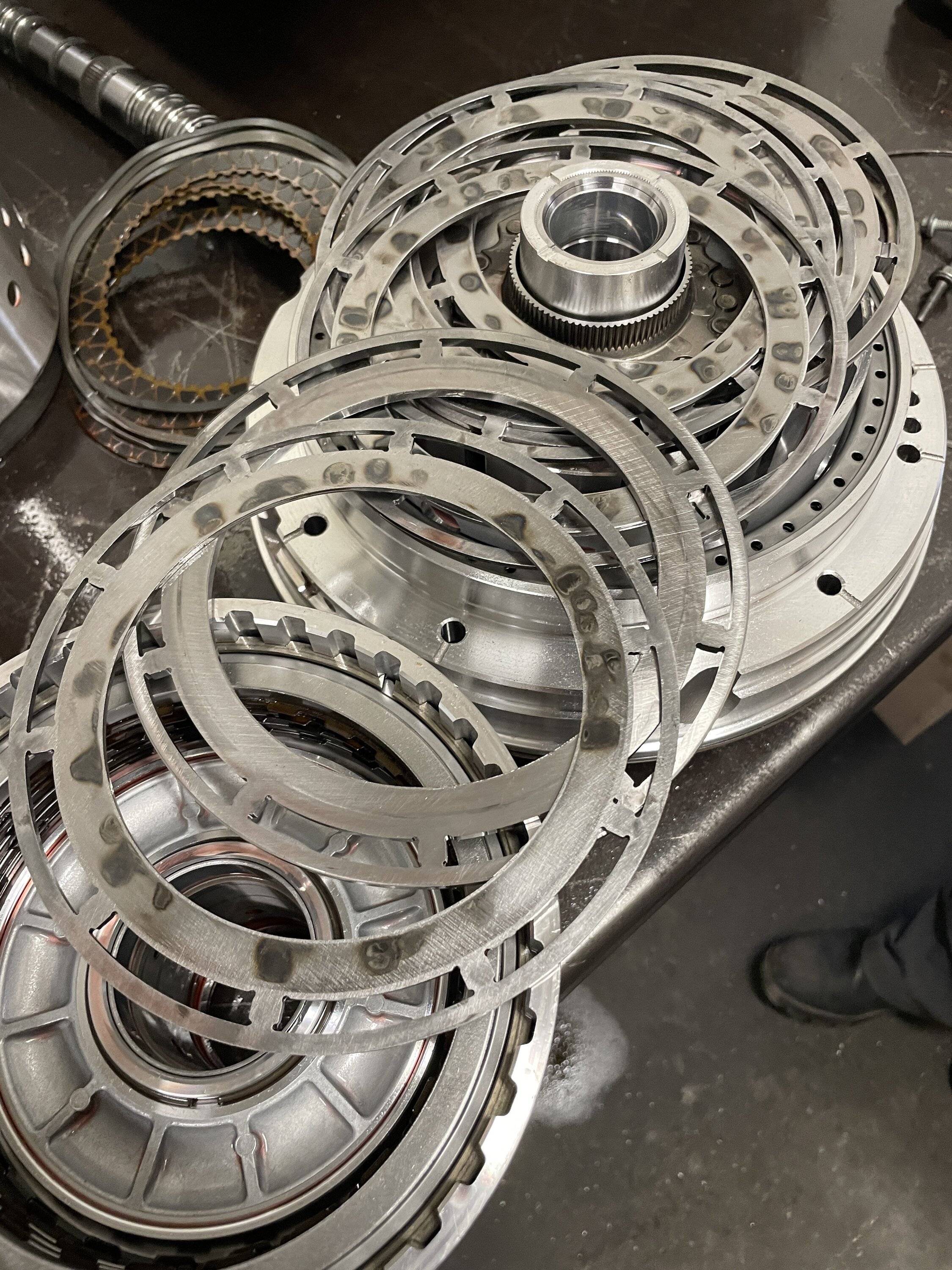

UPDATE:
1. Tech did his data logging and found no errors, but that there was clutch slipping(Shift Flares).
2. Tech requested next steps from Ford hotline and received approval for teardown/inspection.
3. Tech did teardown and found damage(Scoring, valve sticking and metal flakes in valve body, excessive wear on #3 sungear and planetary carrier, scoring on Torque converter, tons of heat damage on F clutch + B clutch pack)
4. Ford will be replacing entire transmission under warranty! :rockon:
I can't state how much of a relief this has been, and now I'm just itching to get the car back with a properly functioning transmission!

Here is a picture of the steels:
