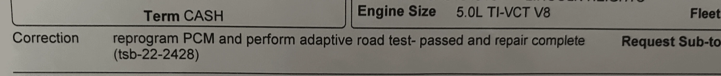

So they can set the adaptive trans-learn mode when the car is new. If someone has test driven the shit out of it and hammered it that is what it adapts to. Ask Ford to reset it and follow their instructions during your break-in period.Hello All,
I have only 350 miles with my mustang gt and i have the same problem.
I went back to the dealer and the engineer told me that "its normal and the adaptive transmission " will eventually "adapt". So let's wait a little. Of course, i don't want to go more than 300rpm but im trying the sport mode from time to time.
Anyway, it is disturbing when it shifts from 3rd to 4th.
