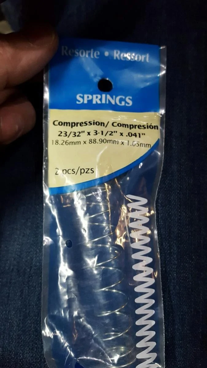

Also here is the spring I used similar to what [MENTION=6647]Husker[/MENTION] used to help support the shift knob. Got it at Lowes.Without the spring a heavy shift knob could push the button down on the shifter and could activate things like the easy-entry feature which could discharge the battery.
