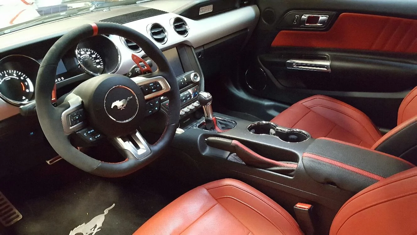

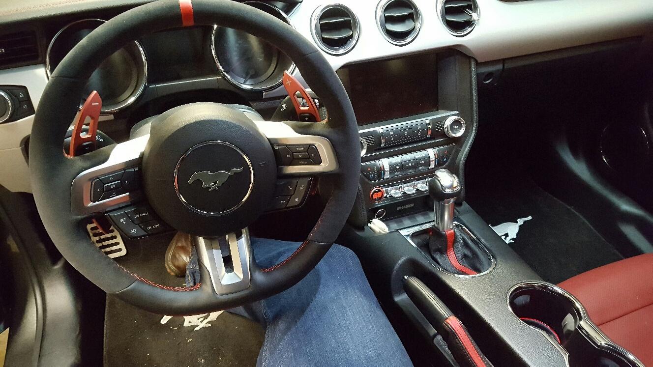

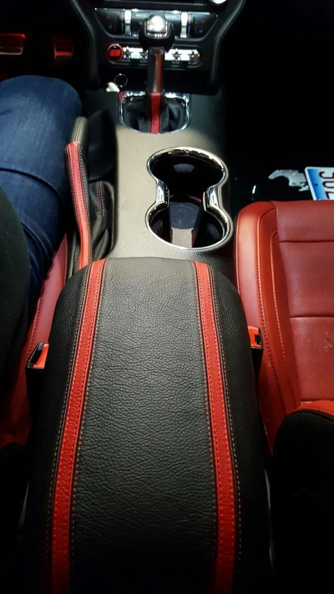

Well I got my Redline Goods interior pieces installed this weekend. I went ahead and ordered the manual shift boot bezel from Ford and switched over.
I have the parts from SickSpeed but am waiting for a custom shift knob from Speed Dawg with a P-R-N-D-S pattern. When that arrives I'll finish the changes.
And yes, I installed my new GT350R wheel too. :thumbsup:

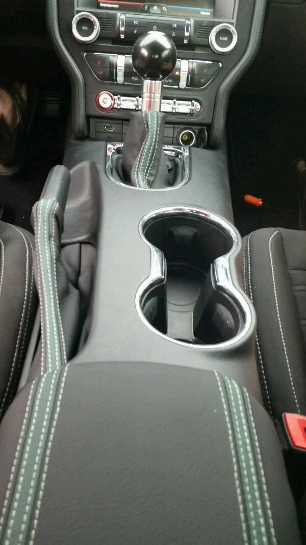

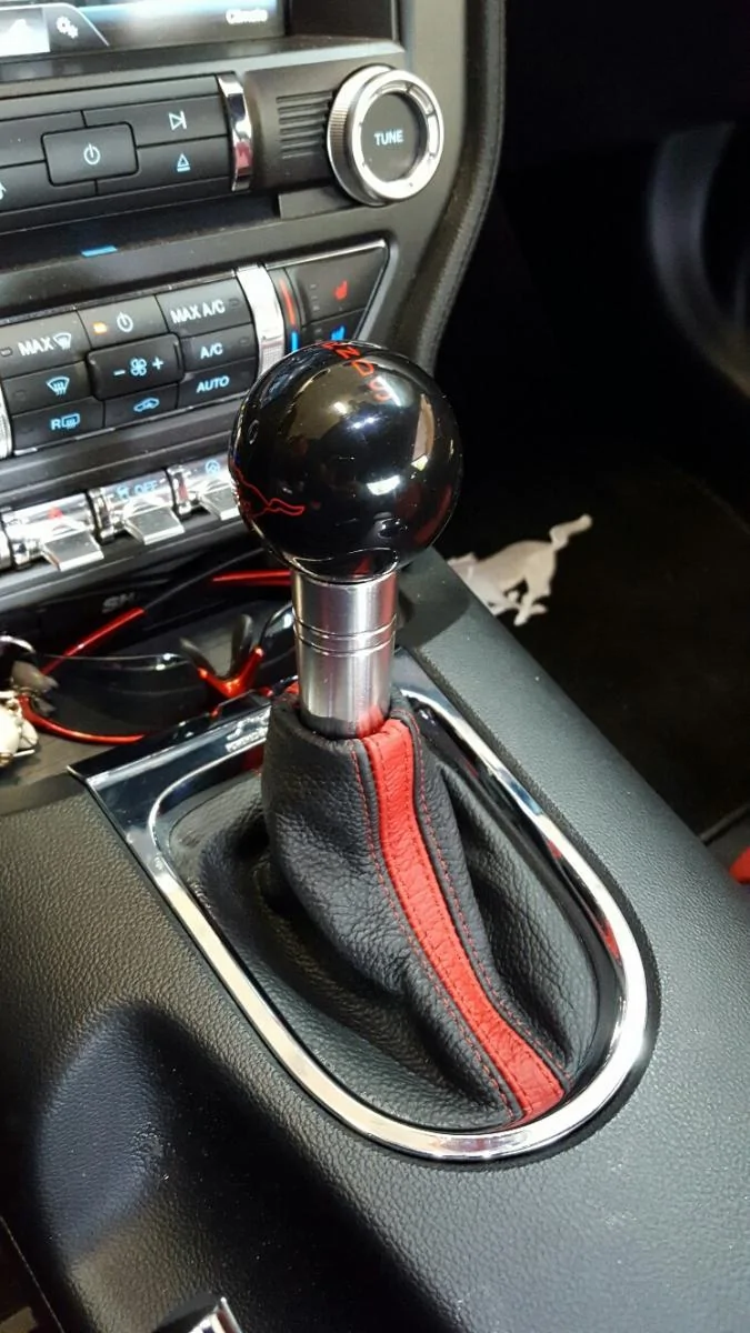

I did the same thing last weekend! Manual boot and everything. Btw how did you reattach the chrome trim down to the black base? Did you use epoxy?
Rickycardo
Dec 9, 2013
53
1,872
615
Bolingbrook, Illinois
2015 GT auto
That looks great! Yes, I re-attached the chrome trim to the black base using 3M Super 77 contact adhesive. I used emery cloth to roughen up the black plastic and remove the chrome from the trim. Then I glued them and clamped them overnight. I'm not sure it will hold if I have to remove the boot again but it is held together with no gaps.

I don't think 3M super 77 is the best stuff to use either but it's what I had. Were I doing it over I would go to an interior shop and get some professional contact cement.
The main thing though is to remove the chrome coating where you plan to glue the pieces. The glue will not stick to the chrome finish and will come right off. That and rough up the plastic so the glue has something to grab hold of.

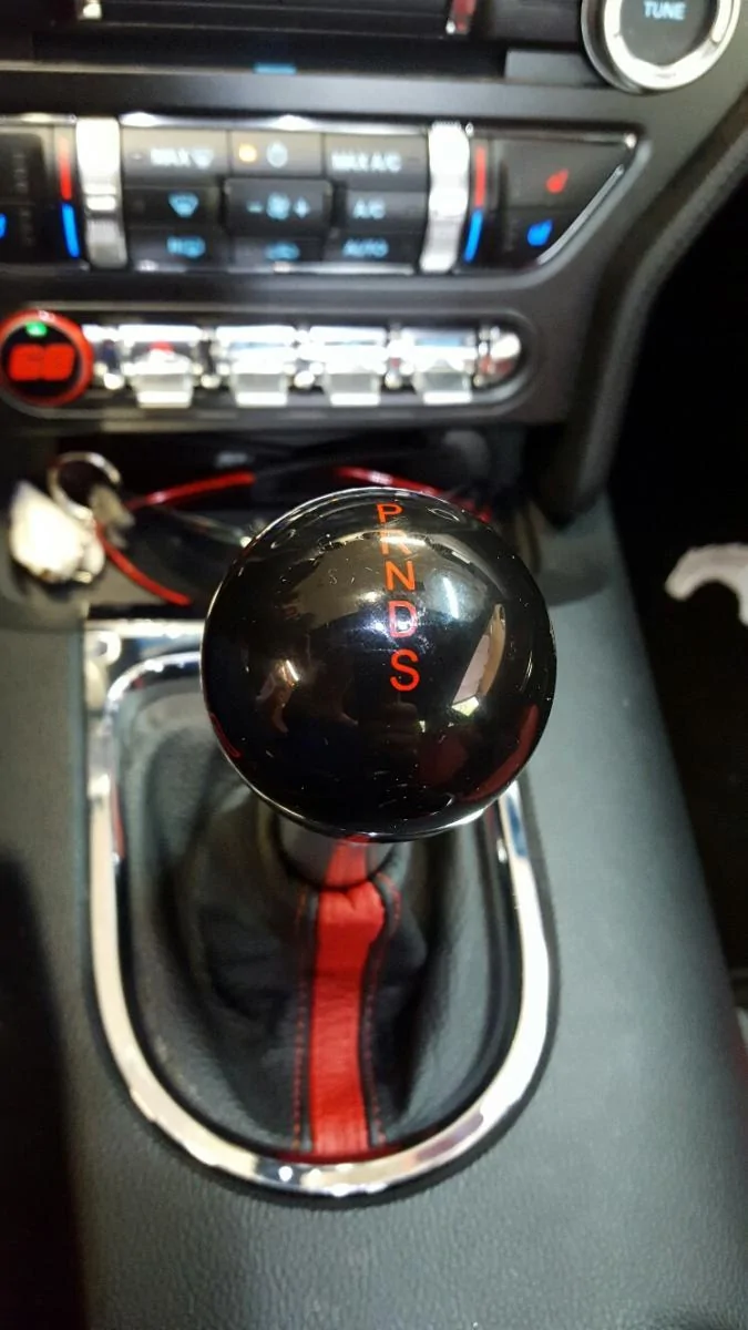

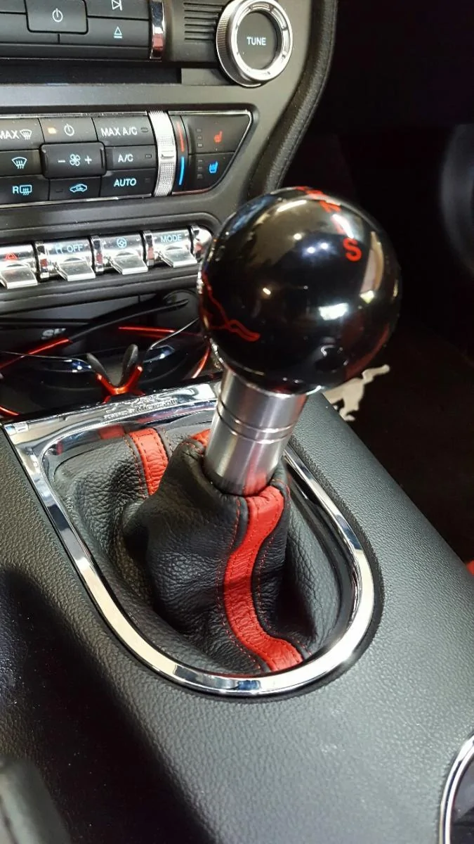

I finally got my custom shift knob from Speed Dawg. Finished up installation today. I had to wrap the adapter with a sticker to fill in the slop between the inner and outer pieces. Not bad but it still feels a little too loose for my taste. I'll have to do something else to it later.
No Spring yet, going shopping today.

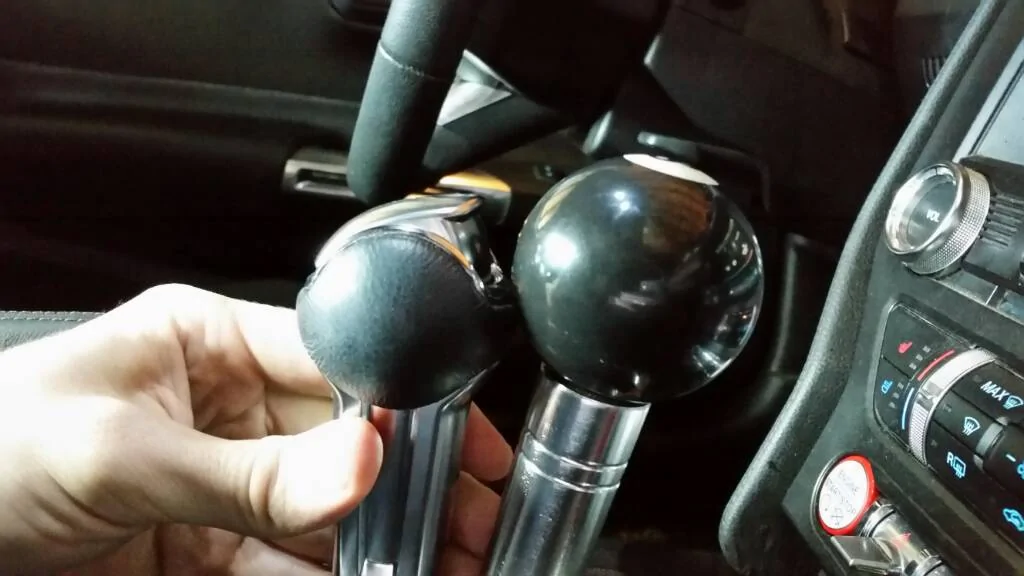

am i the only one who just wants the entire handle to be shorter? these are way too tall.
100% agree.
You can get it closer to stock height at least with a smaller ball.
If you look back a few pages there are comparison photos to stock sizes and the ball size most are using is a lot bigger than the OEM ball top. Adds a good inch of height just in the ball.

I measured everything when I put it back together today. The shaft is .500" (1/2 inch) in diameter, my shift knob and adapter are threaded 16mmx1.5. The minor dimension of the 16mm thread is only .558" or only 0.058" larger than the shifter shaft. Thats less than 1/16"
If you could get a shift knob with a larger thread and an adapter with a larger thread to match you could drill into the center of the ball and drill through the end of the threaded adapter and slide the entire assembly down lower onto the shaft. The adapter is a pretty easy (and sloppy) part to make. About any machinist could make one on his lunch break.
Then you could have a "short throw shifter" for an auto. :clap2:
