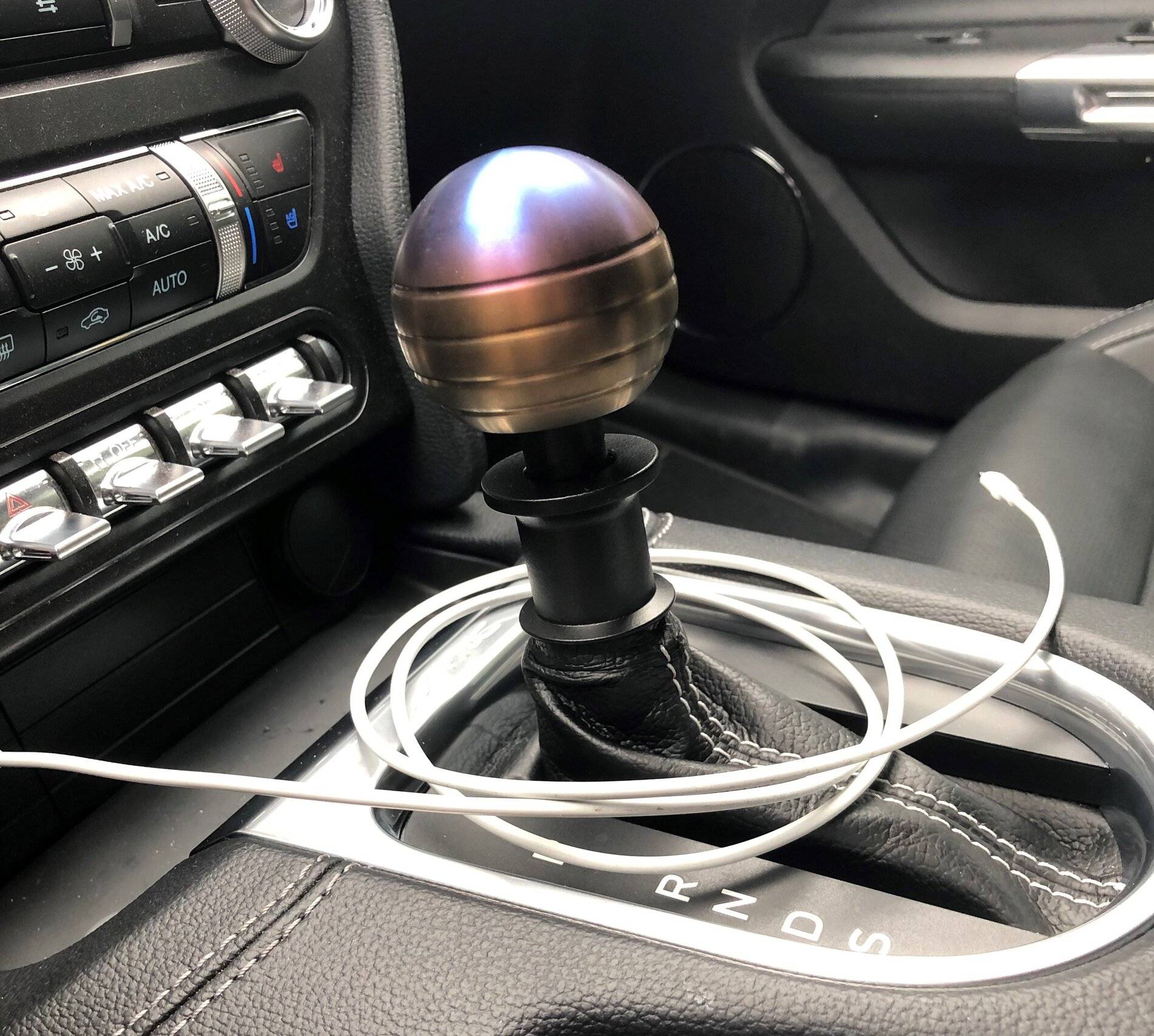

I used a different boot entirely. Didn't even try to move the trim ring over. You can definitely zip tie the boot hugged up to the bottom of where you put your fingers when shifting and it likely won't show. I didn't even zip tie mine, it just stays. I may zip it if it starts showing more.
Here's how it looked with the auto shifter still. Could've zipped it, but knew it was coming off so didn't worry about it.

Ok yeah that makes sense, maybe I will try that and see if I can make it work, just didn't want to destroy the factory auto boot and bezel in case I wanted to put it back stock.

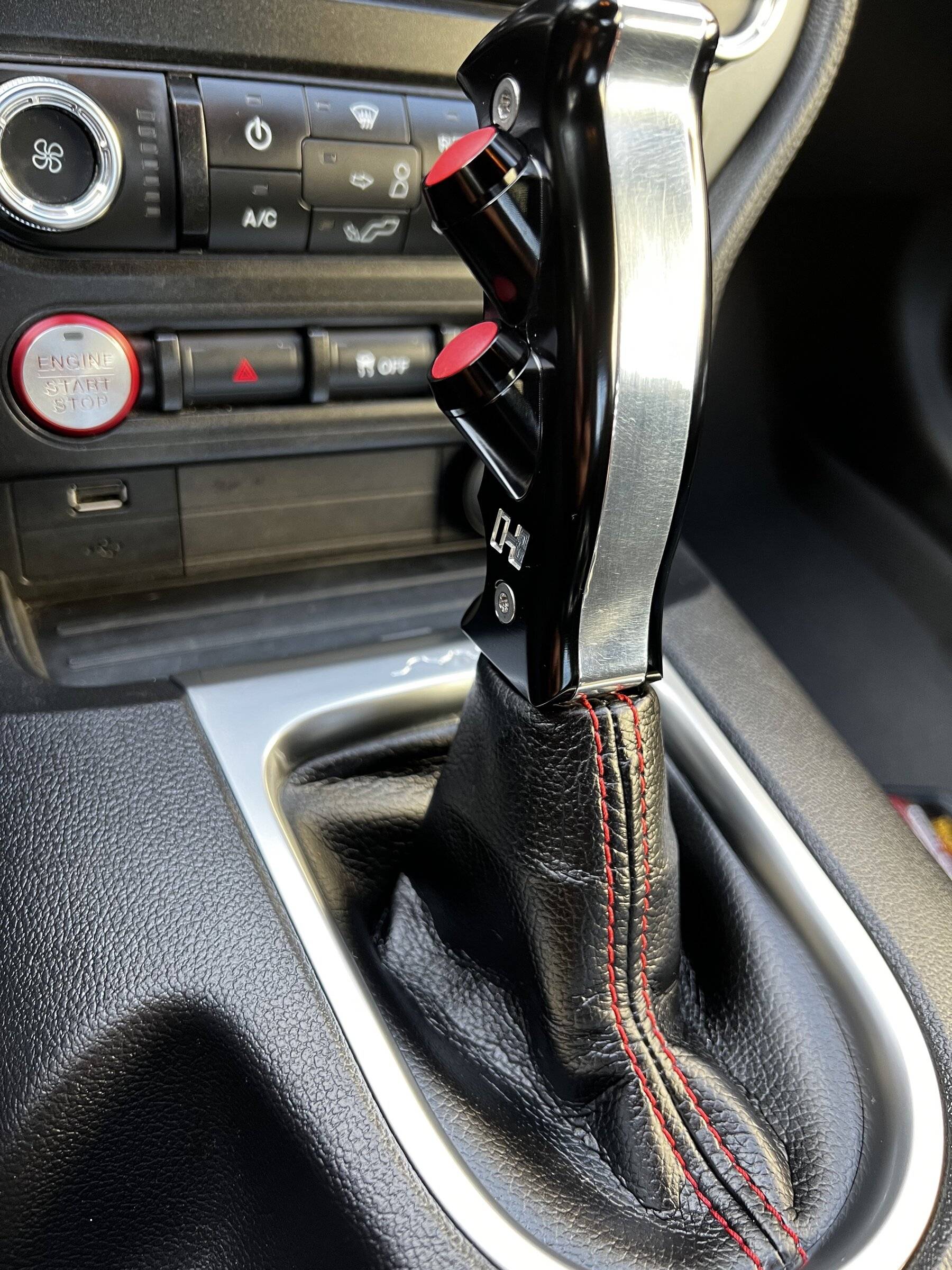

or this ... do like the short shift look too.
Brian_S550
Mar 1, 2018
529
703
Chicago suburbs, IL
See username
2015 Mustang 3.7L, 2016 Explorer 3.5L
nustang
Nov 17, 2020
317
435
BC, Canada
2020 GT, performance pak, active exhaust
What do those buttons do…?
whatever you want.
They are momentary on. Literature suggests up/down shift, but I prefer my paddles.
However anything ... traction control, nitrous, ............
if you want to control a load on/off - you can buy a flip-flop relay, and use the switch to trigger it on/off.
