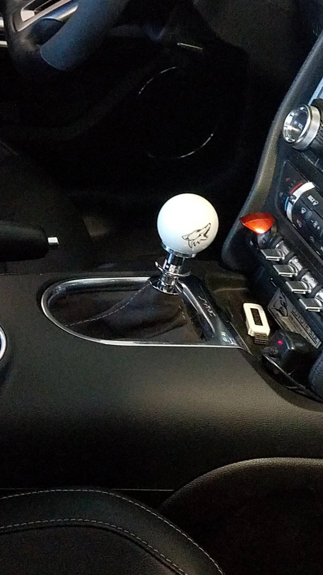

White Madness Garage makes one you can swap shifter balls on. Otherwise they are part of the shifter.
As for the boot: if you get a manual boot from Ford, it comes with the silver bezel that snaps in to the center console. Easy swap.
I did the universal shifter and use a cheap white Delrin shift knob.

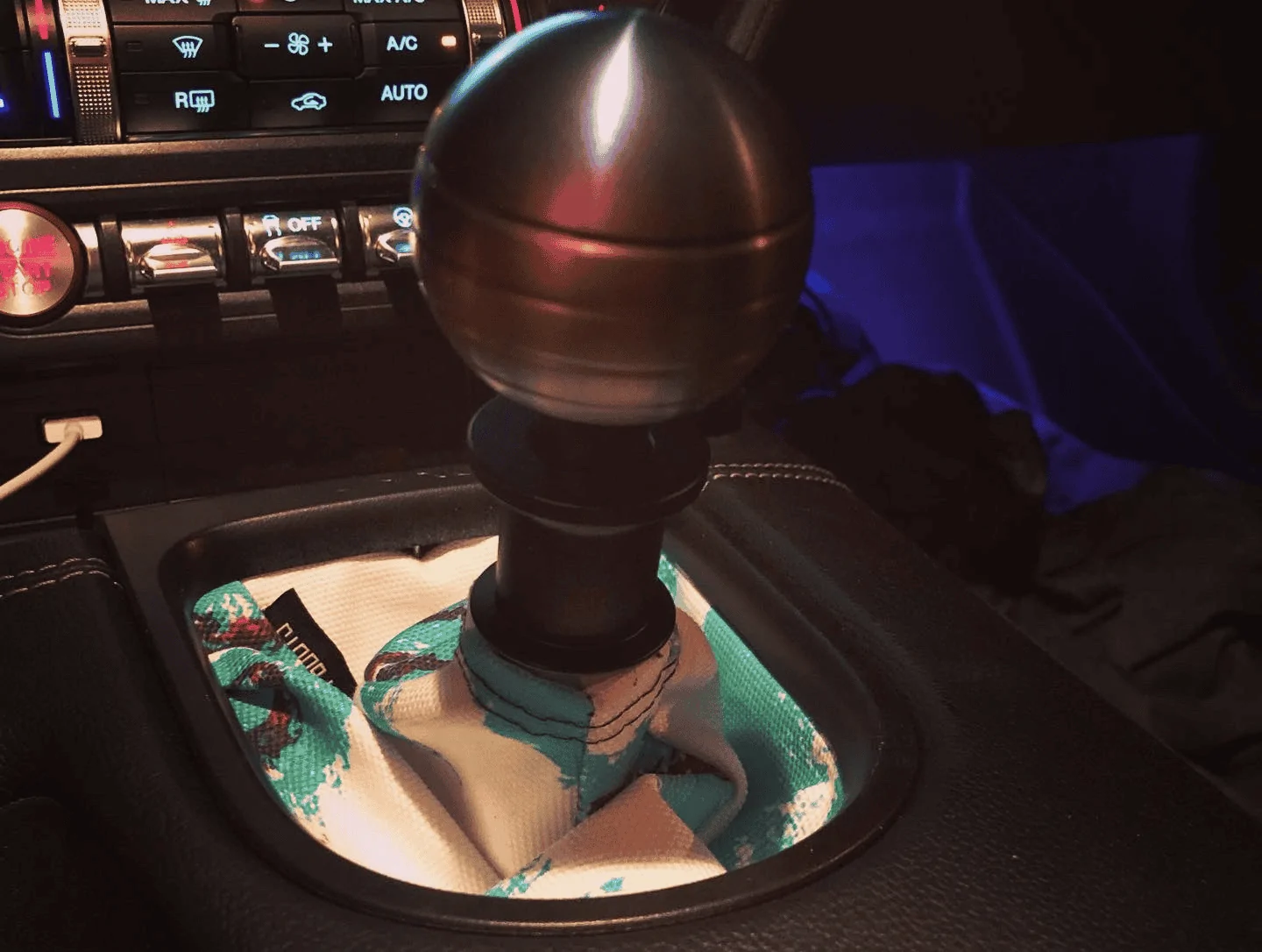

I did the same as Josh. WM's kit (short shifter for me) and a ball I got from WC Lathewerks. Bought the cheapest manual shift boot/trim ring setup I could find, replaced the existing boot on it with another one, plastidipped the trim ring black and here we are.

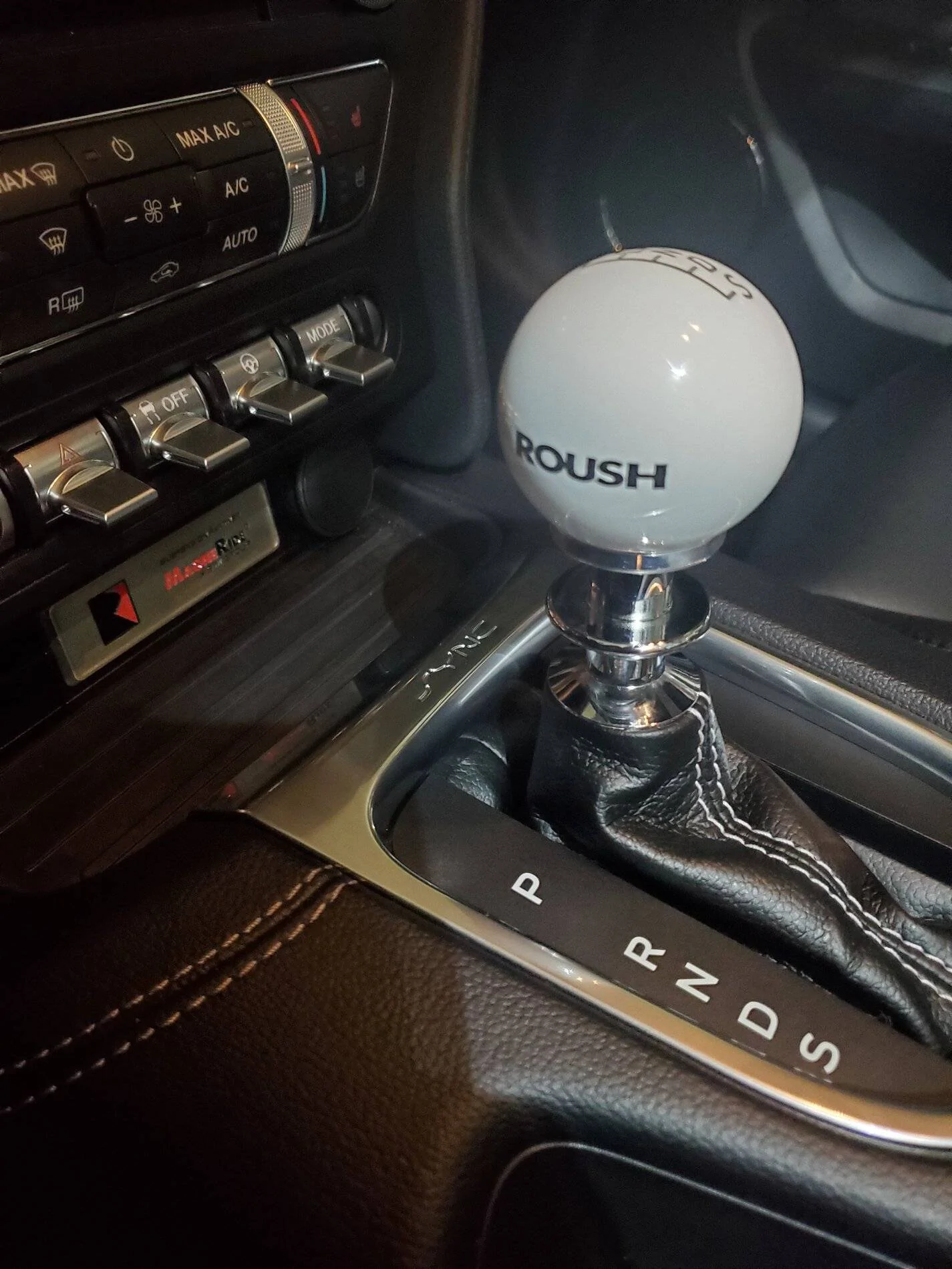

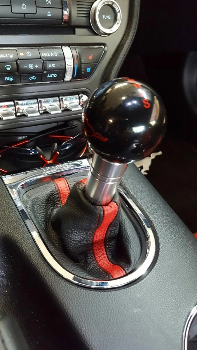

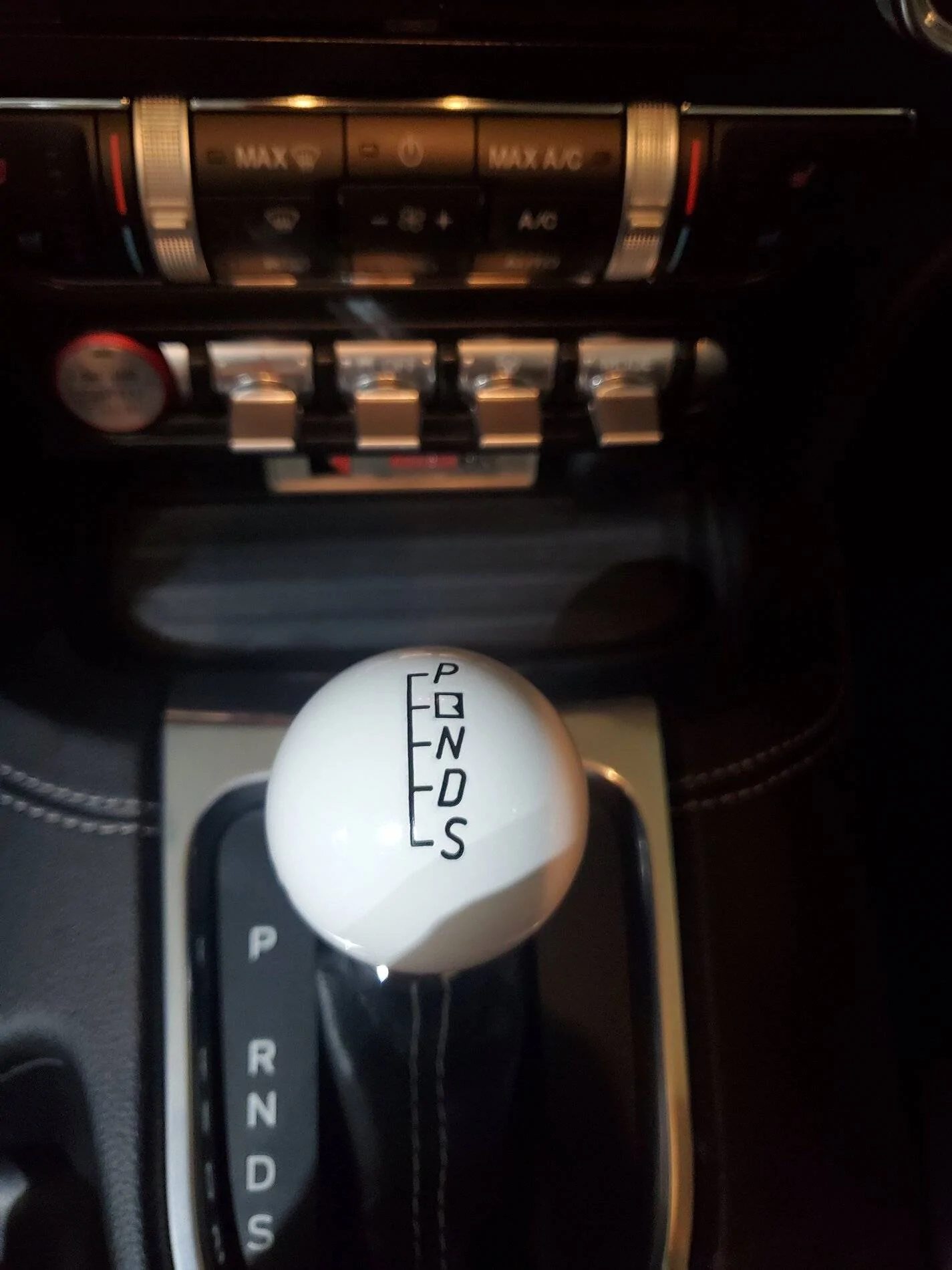

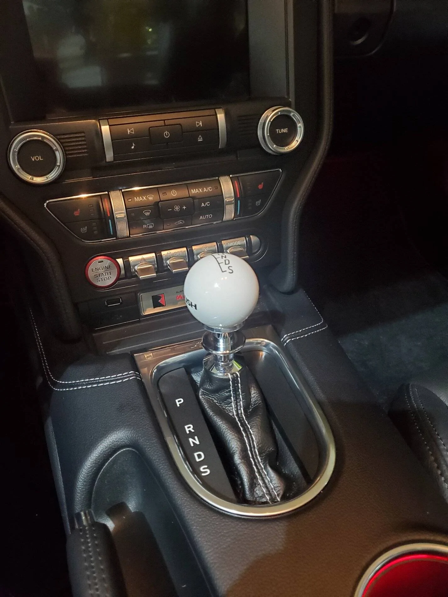

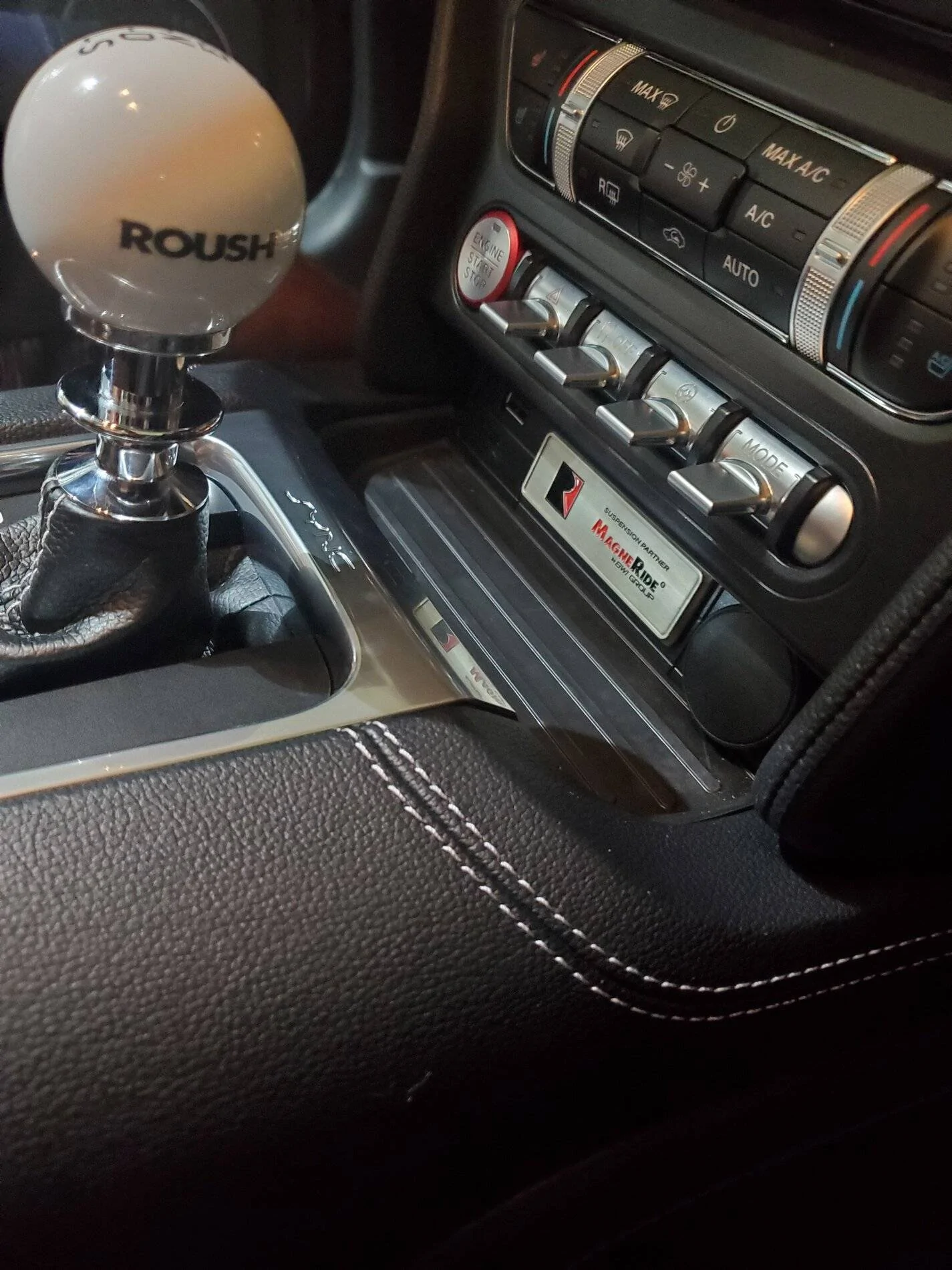

Well got it finished up. Went with standard conversion kit with custom ball from WM Garage. I did purchase the new manual boot but decided I did not want to rip apart both boots to make one so decided to leave it with stock bezel and boot. Plus I like the fact with the Roush ball it almost looks like something Roush might have done with the package.

What do you mean rip apart? If you're just using the manual boot/trim ring you bought, you don't have to tear anything apart.
The Wm Shifter wont fit into the ring on the Manual boot. It is to big, the ring on the Auto boot is much bigger and comes with the adapter from WM to make it work. So you literally have to remove the trim ring from the auto boot and install on the manual boot. It does not look like a big deal I just wanted to keep everything where it could be put back to stock if I ever wanted without having to purchase another Auto boot. I hope that makes sense. :crazy:
