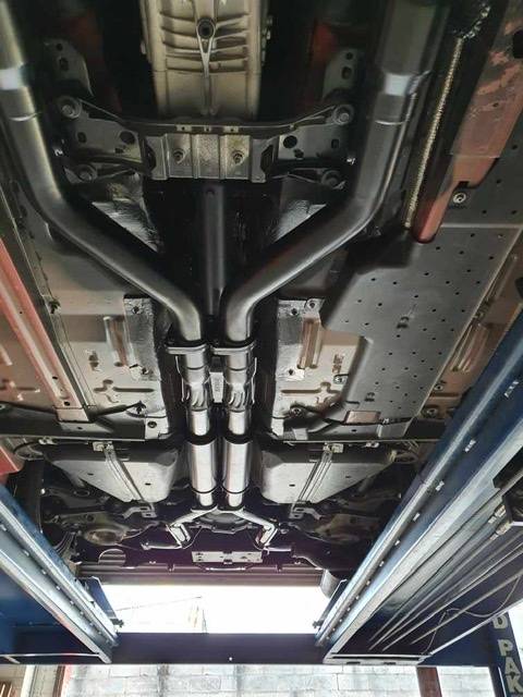

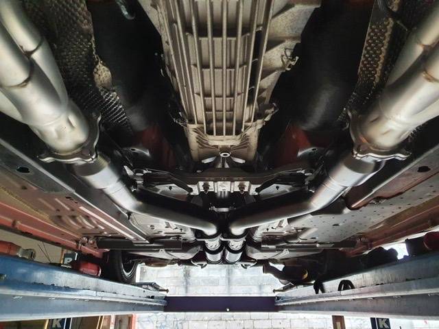

@OzS550 hey Michael FWIW I think you can get AWE Touring axle back, a few of us have them cat back and are very happy albeit without headers. I think Paul (Bagration) has the AWE Touring cat back and is getting headers in the near future. I reckon one of the strengths of Peter's (FIXR7) system is probably those Hurricane resonators and as he says 'I've since added two 14" Hurricane resonators before the X which took that horrible raspy edge off it and now it's not so loud and sounds really good.' Couldn't tell from the photos what you're running or if it's an X or H pipe.

The Pacemaker centre pipe has an H pipe and two resonators after this.
Had a good run on the weekend and the current setup sounds mostly good especially once warmed up. Gobs of torque now - very noticeable. Very nice, refined tune.
I have noticed condensation dripping from some exhaust joints when cold and can't shake the idea that this also means a slight exhaust gas leak here that could be contributing to unwanted sounds. Any thoughts?

@OzS550 I reckon one of the strengths of Peter's (FIXR7) system is probably those Hurricane resonators and as he says 'I've since added two 14" Hurricane resonators before the X which took that horrible raspy edge off it and now it's not so loud and sounds really good.'
Go back a page and you can see the photo.

If condensation is dripping from the joints it seems must be leaking in some way, which is strange. Agree with Peter that unless you can hear a tick it's probably not an issue but still I'd be very curious. I guess it's possible that it doesn't tick at idle but under power it does something to affect the noise.
So, front to rear Michael you have an H and two resonators and Peter has two resonators and an X. The AWE Touring has an H and then two resonators also but the section of pipe containing the H is well forward and quite a distance from the resonators. Exhaust tuning is a black art, even tubing wall thickness makes a difference and I'd be tempted to get the exhaust shop to reverse that centre section and see what happens but that's just me. Those spiral bits in the centre look interesting, are they expansion chambers?
The oem mufflers could be all that's causing rasp. An Invidia or AWE axle back seems to be as good an option as any, if they don't deliver it just leaves the centre section configuration to be tweaked.

The spiral bits are where the H pipe is.
