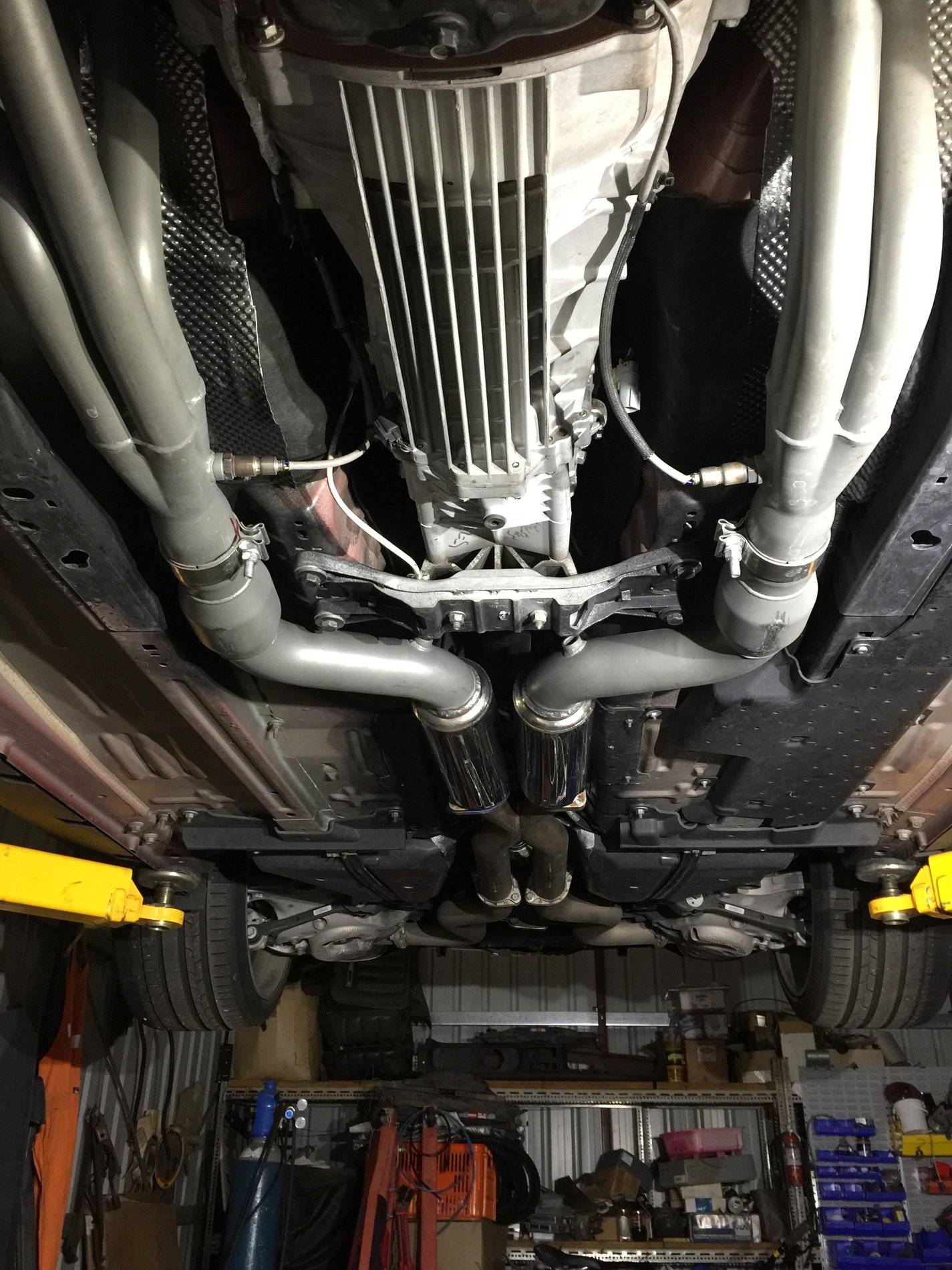

I got them from Fred yes. I ceramic coated them with the grey finish because the shiny ceramic seems to go off anyway(i think because of the aluminium content) and I used the cats that come with them.
Yes I've got a CEL but it's actually because one aftercat HEGO wire got broken and because it's not Pre-cat I don't care :)

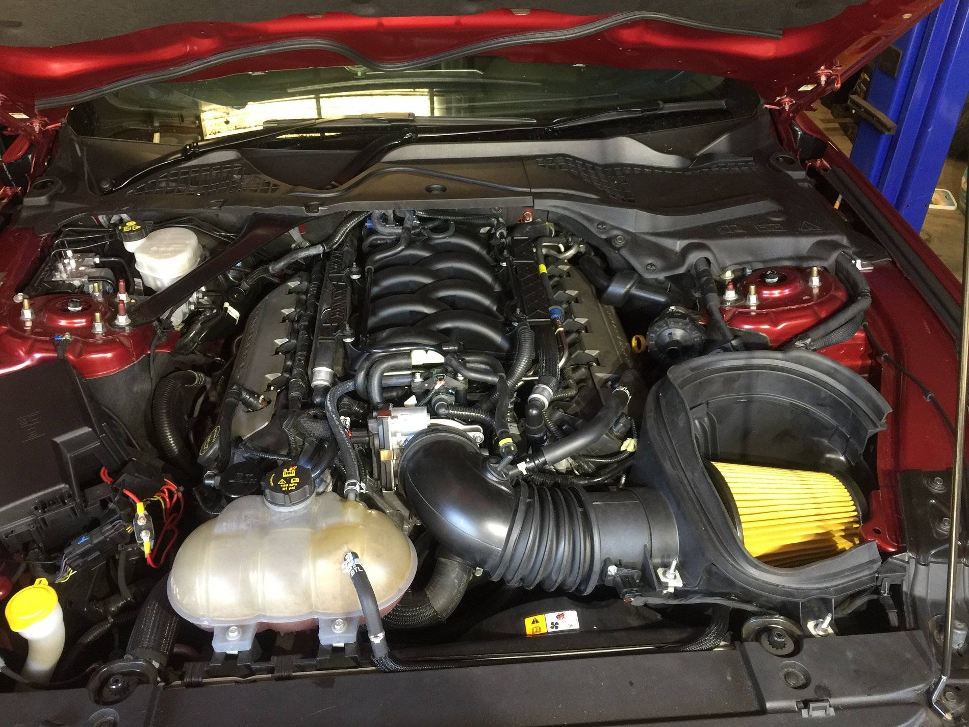

I've got HP-tuners gear and an N-gauge so mine is already tuned and I've also got the GT350 top end on it so of course I need that. So I sold that Airaid thingy.
I've since added two 14" Hurricane resonators before the X which took that horrible raspy edge off it and now it's not so loud and sounds really good. People have commented it sound like a V8Supercar when i'm up it.

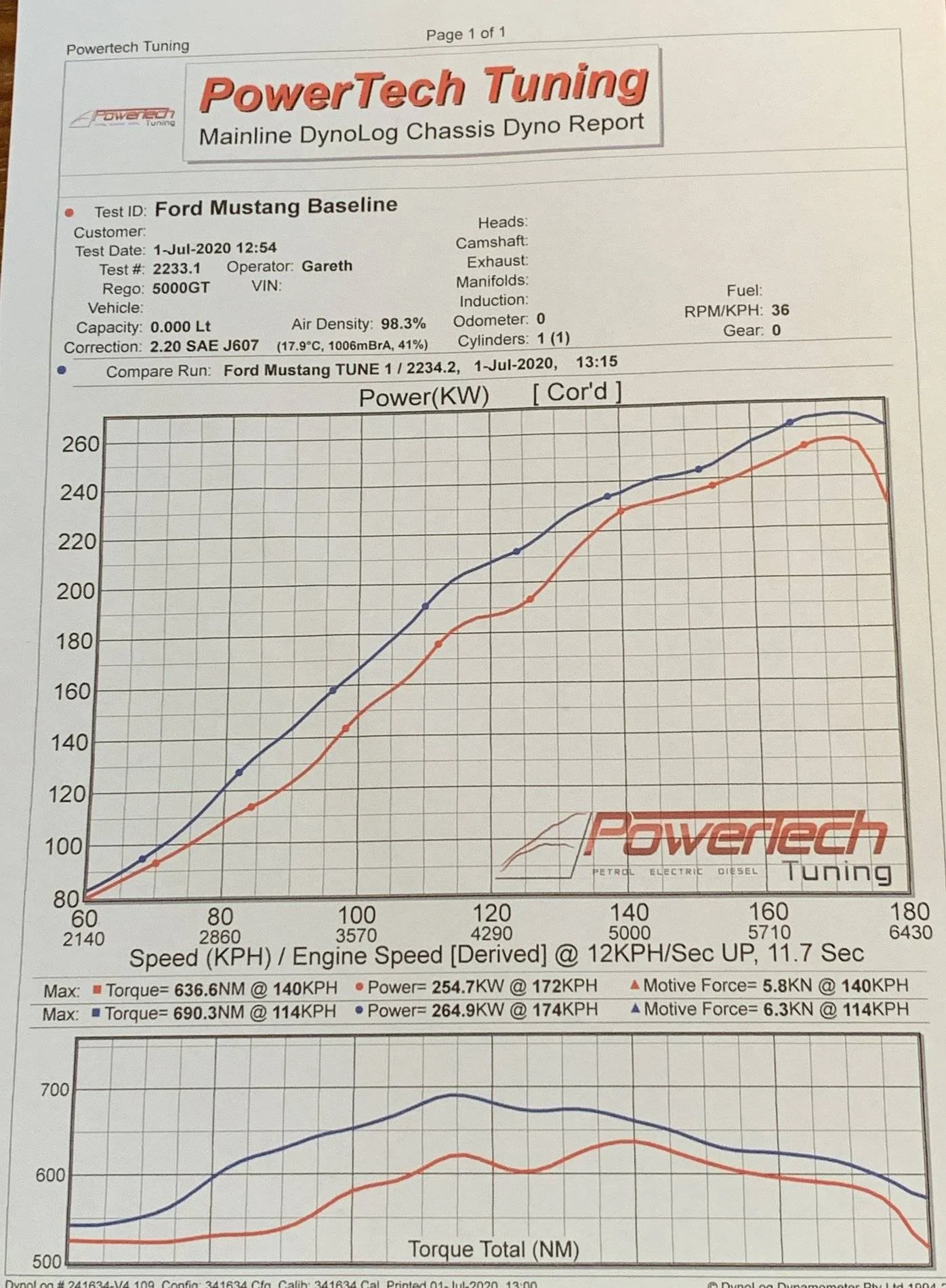

I had the car tuned last week after doing the Pacemaker 1 3/4" headers, 3" mid-pipe and resonators (also Pacemaker) blended to the stock rear mufflers.
How does it sound? I was naively hoping it would sound mostly stock but it's far from that. Mostly I quite like it, not too intrusive once it's warmed up (that makes a surprising difference). When you get on it there's an aggressive rasp about it that reminds me of something from the 70's.
I do think I will eventually change the rear mufflers but I'll decide later. At the moment I'm tossing up between doing the sensible thing and adding the Pacemaker ones designed for the system or using the variable Varex mufflers. I'll listen to some before deciding.
Power wise, there's a significant increase in torque in the mid-range and the car drives exceptionally well with a very linear power delivery. My first decent drive along some open roads Sunday was hampered by rain unfortunately.
Red curve headers / exhaust only, blue after tune. Ultimately top end strangled by OEM mufflers but mid range enhanced. Would have been interesting to see the standard exhaust and tune only line for this car, on this dyno.

Good to see it drives well. That's a very healthy increase in the mid range. If you have the inclination get them to quickly drop the rear mufflers and run it again, if it's performance you're after the restriction from the stockers may not be that severe.
I'd wager non variable mufflers will be artillery deafness levels of loud.
KermiStang
Oct 4, 2019
473
1,144
Australia
AJ
2019 Mustang GT N4G
Gee those power and tq numbers around 3k under the curve are very nice for drivability.
