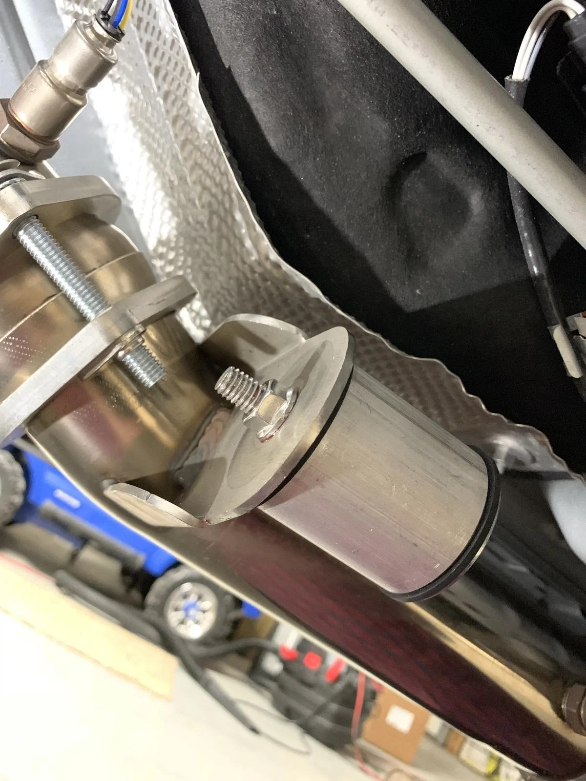

Anyone have a picture of the headers installed with the anti vibration dampers? They facing forward or rearward?

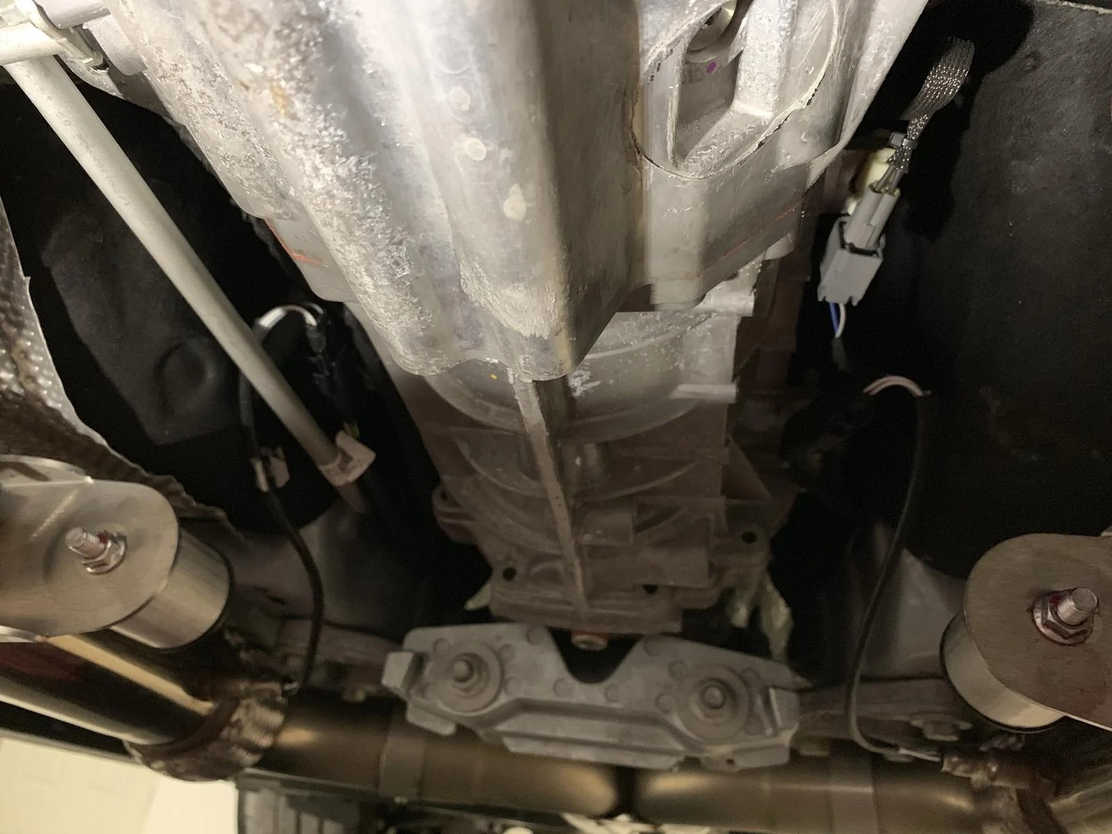

See the pics I just posted of the updated dampers. Seems like they did their homework.

When Kooks first released they were having issues with the dampers fitting up. I had to get creative with my solution to get them on. It worked out well in the end. Good to see Kooks resolved the issue now.

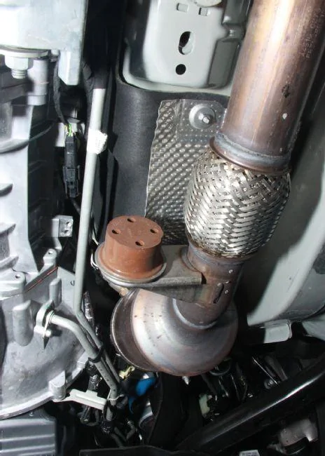

Gotcha'. Do they seem to be custom for the headers/catless mid-pipe? Or are they just the same as the OEM?
I would assume that you'd need slightly different dampeners since the harmonics would be different, but admittedly, I know very little about that stuff. Just enough to be annoying on the internet :)

They are noticeably heavier, skinnier, longer and have an aluminum sleeve over top vs the shorter exposed rubber ones that are OEM. Quite diff from OEM. I assume there is some reasoninbtg behind them but maybe not. Mine were reversed and I had an odd vibration at 2500ish rpm. I fixed that issue but haven’t didn’t have a chamber to test drive last night. I’ll take her for a spin this evening hopefully.
