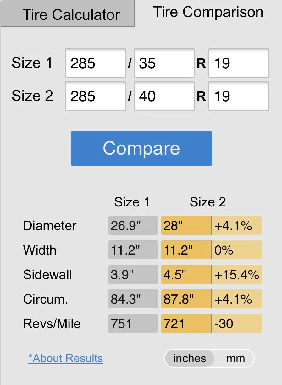

285/35 19 are 26.9 inches, 255/40 19 are 27.0 inches nominally. 275/40 19 are 27.7 inches and is what comes on the rear of PP1 cars. I can’t speak to this size and front strut clearance.

285/35 has far better tire selection.
OP do a tire survey on Tirerack and filter by size. You should also find there is a price premium for the screwball 285/40 size. There isn't much point in fighting the 'standard' fitments the industry has gravitated toward. On a 10" just run 275/40 of which there are a plethora.
