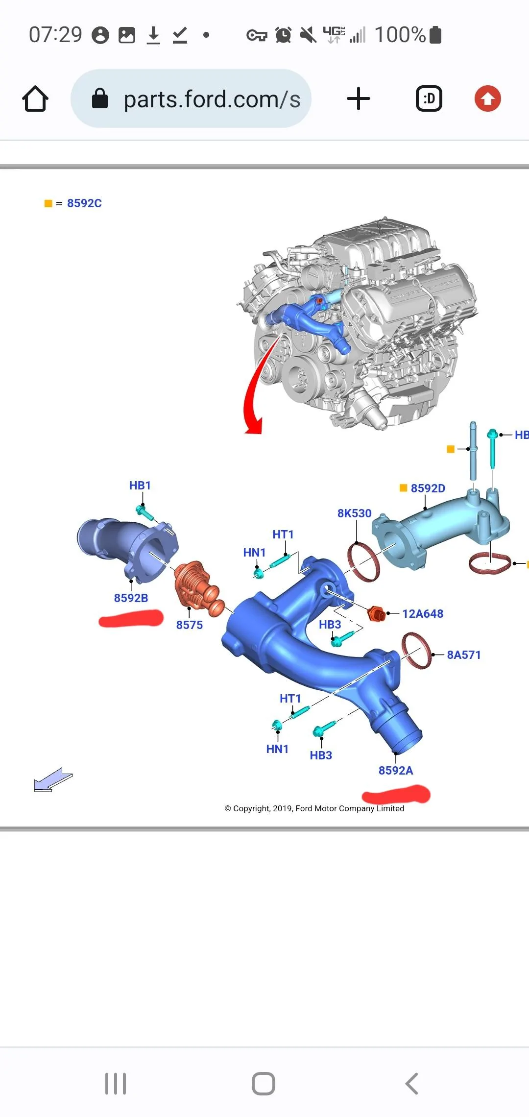

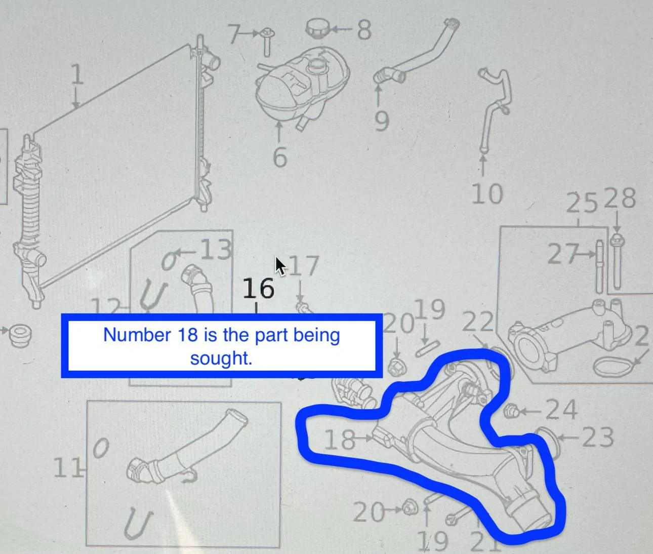

For the love of all that is holy does anyone have a part number for # 18? All the online Ford listings pass over it that I’ve found.

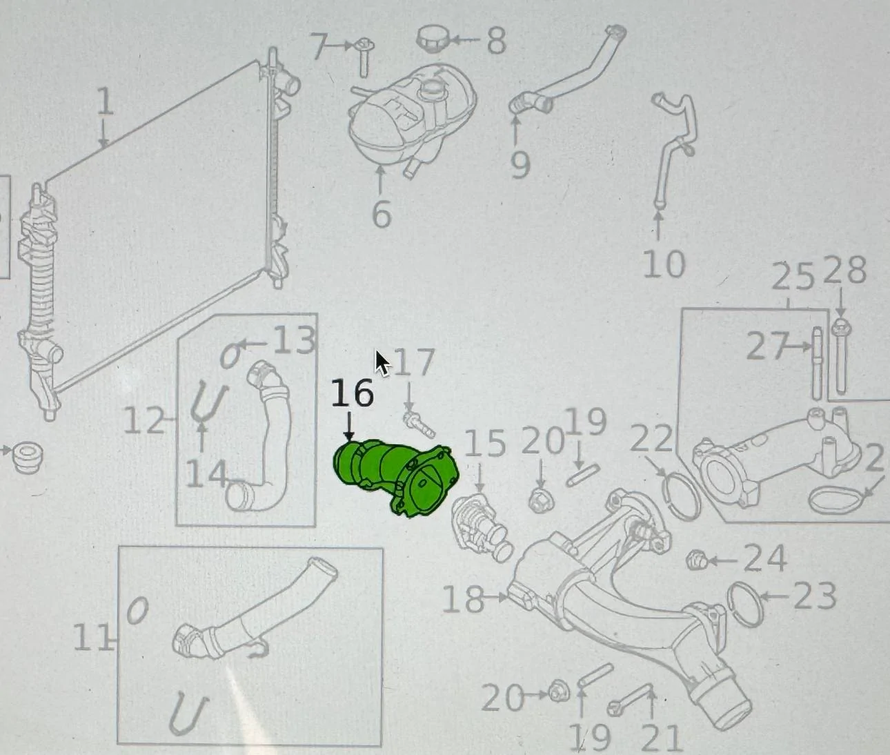

By referencing PN# "KR3Z-8592-C", I found the diagram referenced above. I spent time attempting to Google anything related, in the hope I'd be able to locate the part needed: #18. I could not.
I've mentioned Levittown Parts, who we often rely on for identifying items and helping us order replacements. IDK if you'll get a response on a Sunday, but you should get some feedback tomorrow.

Learn how to use the parts.ford.com website. Throw your vin in and it narrows your search. You can then go by category and when you find a diagram, click on related parts. Done.
It looks to me that the part number should be KR3Z-8529-A

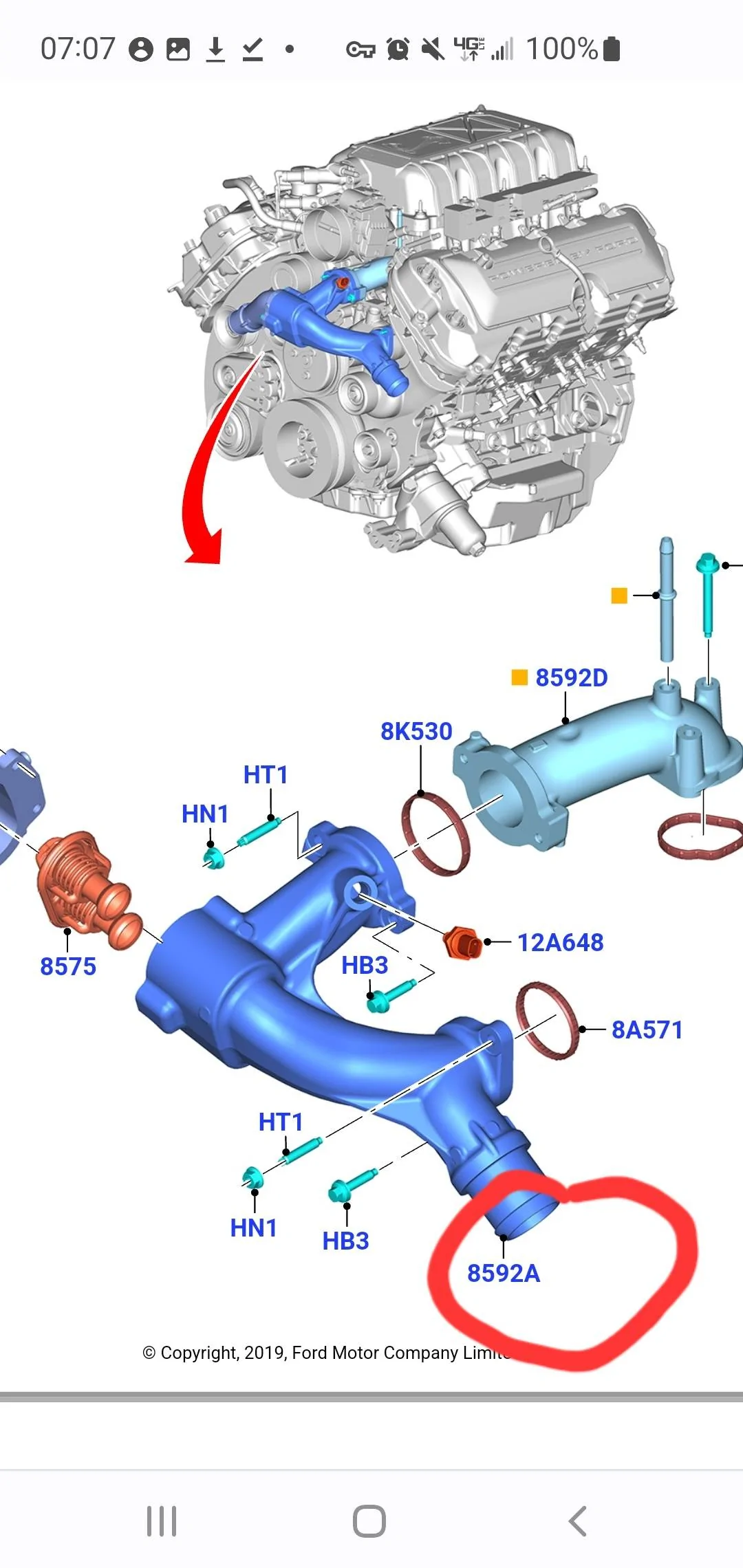

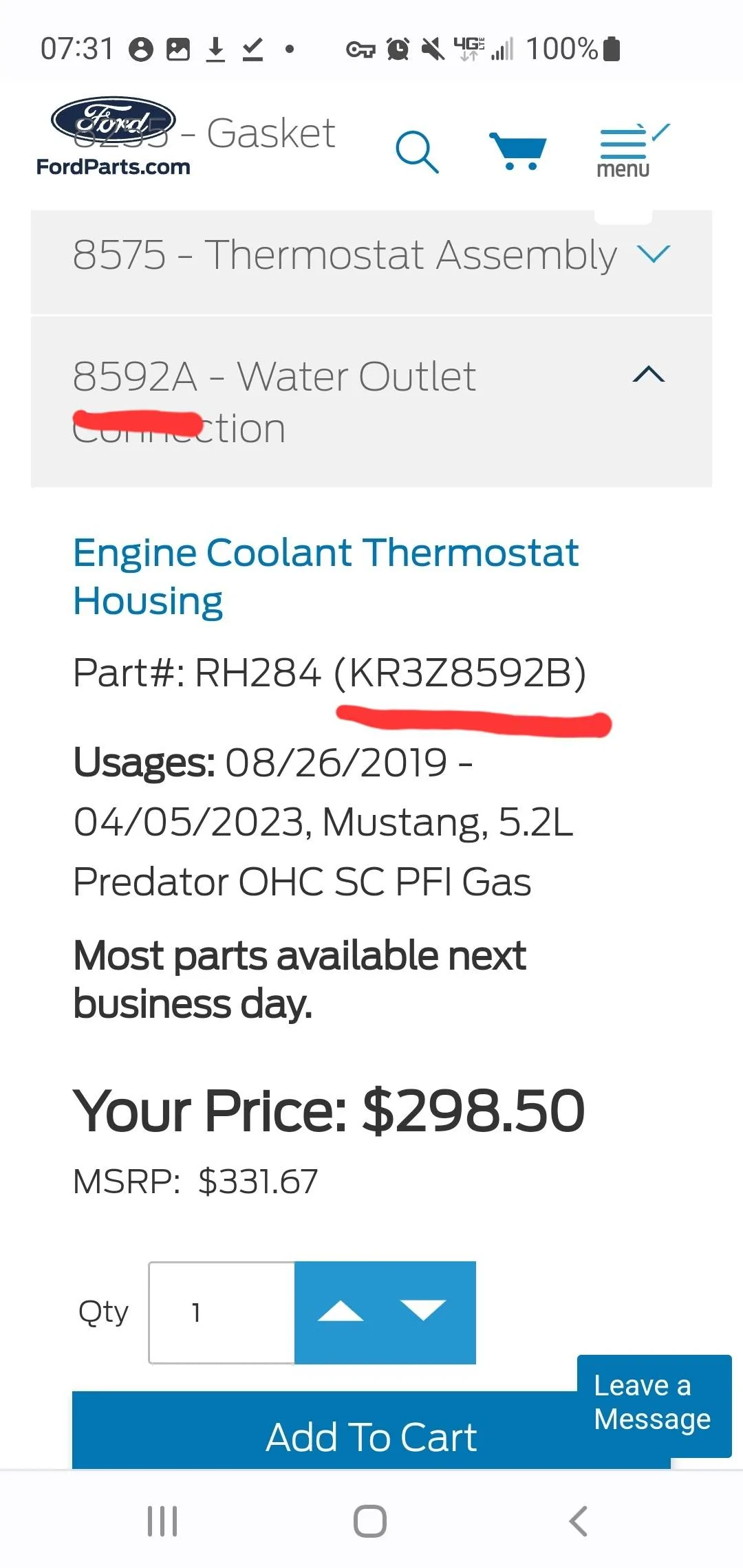

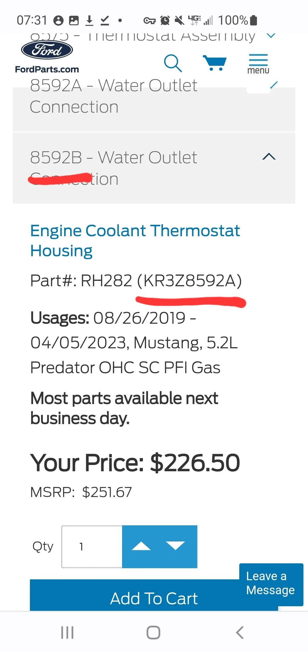

A closer look makes it seem that Ford has the parts mixed up. Under the diagram for related parts, 8529A shows up as 8529B and vice versa.

That's what I was showing at first, I then edited my message due to the mismatch of the parts on Ford's site.
The diagram from Ford clearly shows it is the A part. Then the descriptor says its the B. Vice versa on the B, it shows its the A.

8592B in illustration (post#4) above = KR3Z 8592 A
8592A in illustration (post#4) above = KR3Z 8592 B
There is no direct correlation with the letters on base/callouts in the catalog illustrations with the service part number. Sometimes they match sometimes they don't.

I had a similar issue with a rear shock. I ordered online by part number, and they called me to verify I in fact wanted the shock, and not whatever part the descriptor said it was.
Your results may vary though. Ford Parts is very clunky and un-intuitive.
