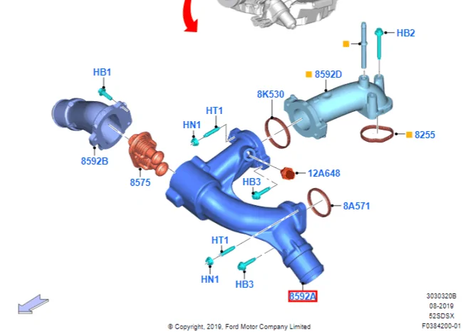

For the love of all that is holy does anyone have a part number for # 18? All the online Ford listings pass over it that I’ve found.

Building a Predator motor from the block up. Last things I’m working on are the belt drives and water outlets. Believe any year Predator GT500 should be the same.

Got it,
See below
8592A - KR3Z-8592-B
8K530 - AL3Z-8255-A
8A571 - 7T4Z-8590-A
8575 - BC3Z-8575-E
8592B - KR3Z-8592-A
Let me know if there is anything else in the image your looking for
