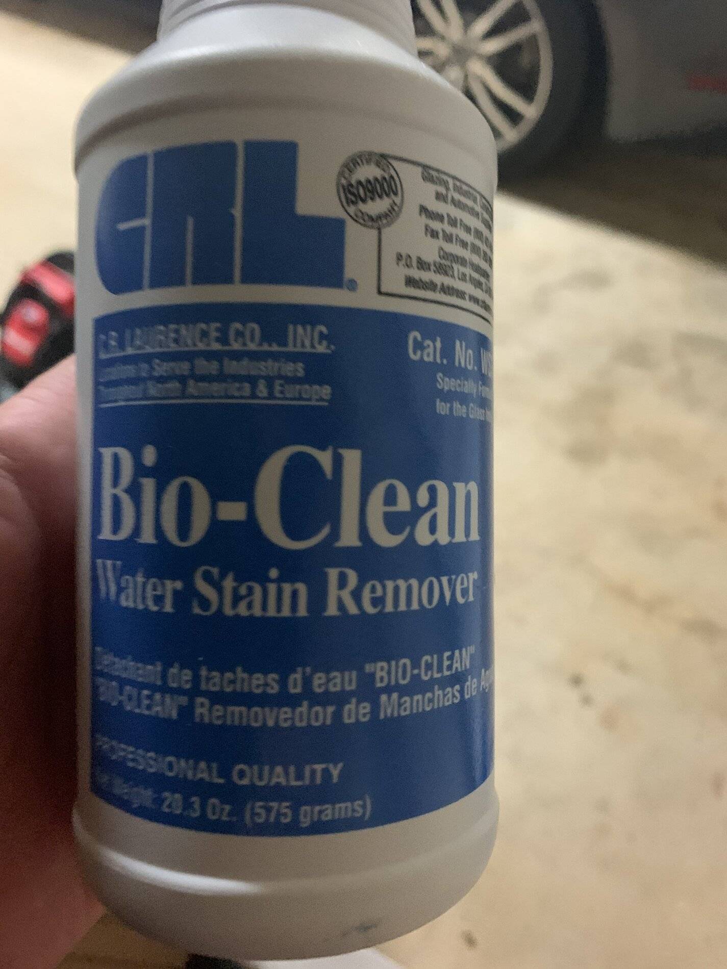

I posted this a while back. I’ve been using this with a glass buffing pad and buffer to clean the windshield and have been pleased. It does have a small of acid so I wouldn’t use it on paint or other surfaces.

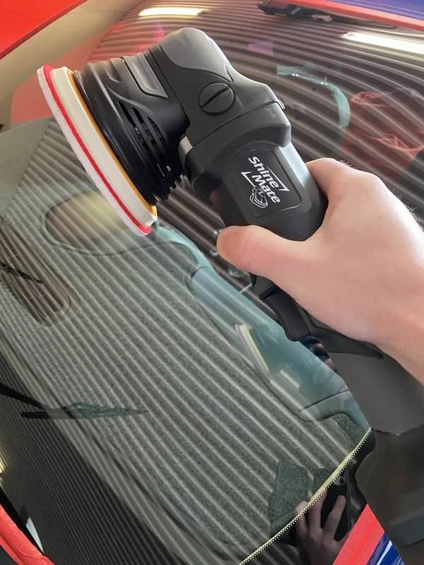

If you REALLY want clean glass, and you have or can buy or rent a Dual Action Polisher and some M105 or similar finishing compound, then you can get it all and, polish the glass at the same time.

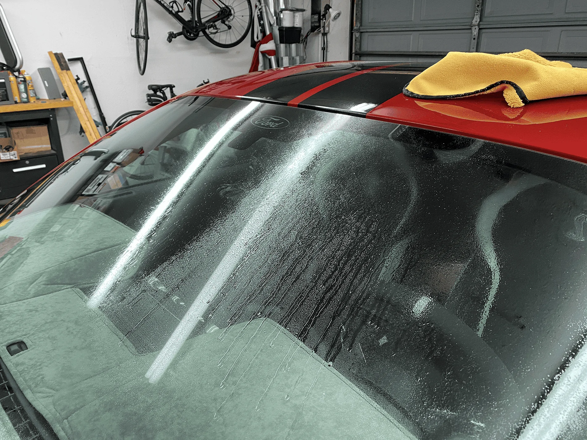

You'll be amazed at how much contamination accumulates wax after wax. Here's a shot showing half the windshield polished and the other half not. A little IPA to point out the gunk. Keep in mind, the entire windshield is coated in 90 IPA.

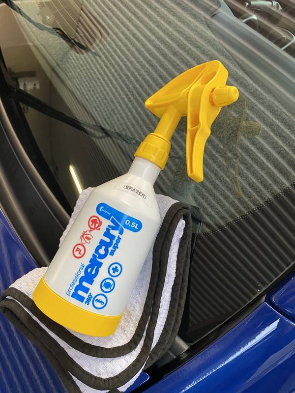

I finally got round to giving my glass a good cleaning yesterday.
On the inside I went straight in with a damp magic eraser sprayed with some carpro eraser. Mopped up with one glass towel, then buffed with another.
For the exterior, I went to town! Once the glass was clean, it got a clay (block) using glass cleaner as lubricant. I then went over once more with carpro eraser. No matter what towel I dried with, I did seem to see wipe marks - akin to hazing following a polish, very hard to spot but it was there. Followed up with the magic eraser and this seemed to mostly get the glass super clean, wipe marks much much less.
The windscreen only got a polish by hand (carpro ceriglass) and then all exterior glass got a coating of Adams glass sealant. Buffed off with carpro eraser again.
I hit the road just after sunset so missed out on the sun really showing me how good my work was! But aside from a few minor "smudges" on the interior glass, I think I'm pretty happy with the results.
Towel management could have been better I think - there was no real thought behind which towels I used and when, but I did get through 6 or so towels.

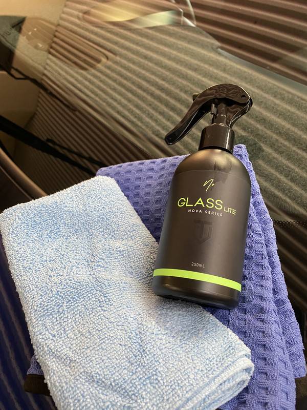

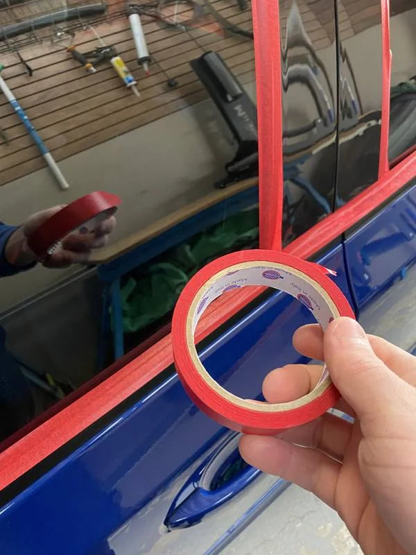

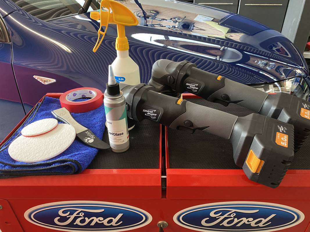

Funny the mention of glass polishing, that's exactly what I did today, although not on the Mustang.
I used CarPro CeriGlass, CarPro glass polishing pads and CarPro masking tape.
Once done, I cleaned the windows with Eraser before coating them with NV Glass Lite.
Love the look of crystal clean glass.
In terms of using Eraser for glass cleaning, being alcohol based like Stoners, it works very well at this task.

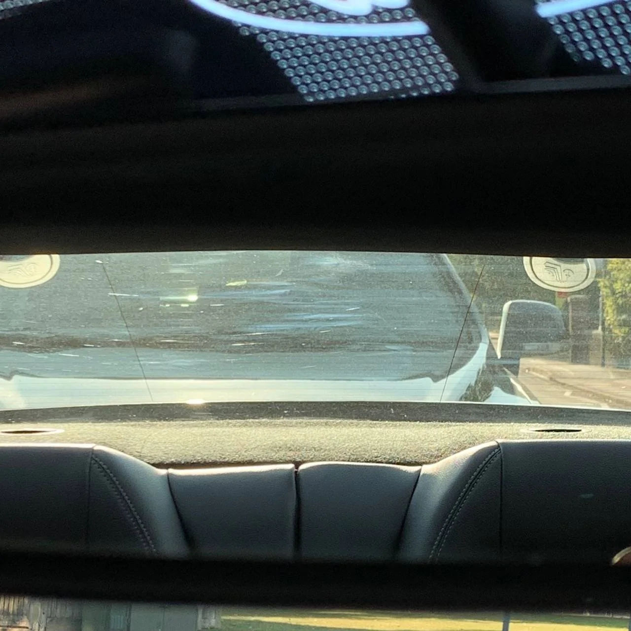

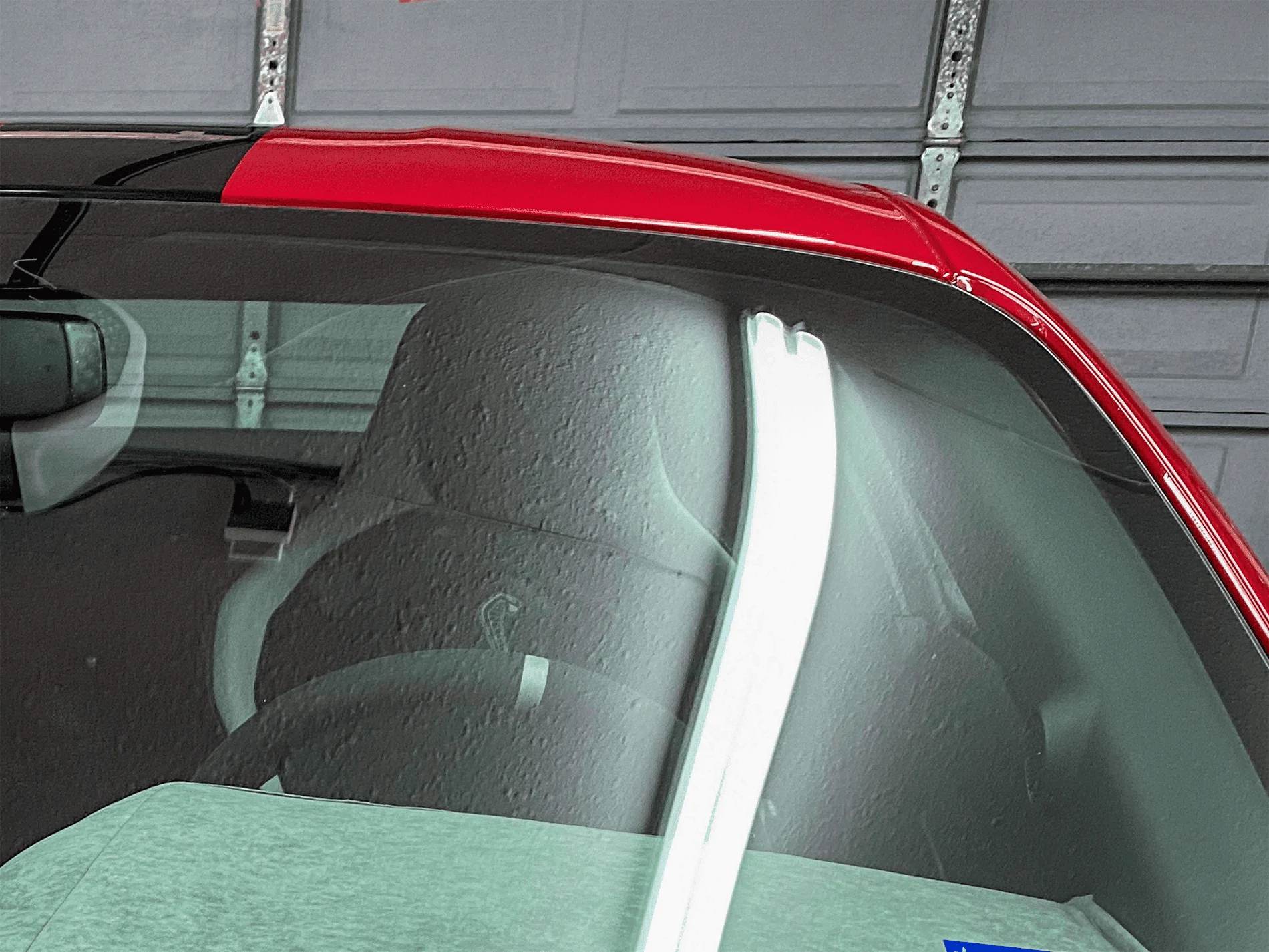

Arggghhhh the smears
Sunny day yesterday, a perfect day for reviewing my results!
Out of the back window I can tell that the glass is mostly crystal clear but there are swipe marks from where I did a final buff. I go side to side on the interior glass. Given that I went in with the magic eraser, I can only blame a contaminated towel or poor technique. I got back in there after taking this photo for another buffing which improved things but still not 100% wipe mark free.
The front windscreen is generally pretty good, a few "smudges" where I didn't buff too well were easily taken care of, but what was noticeable was a patchy sort of "fog" as I was driving and getting the sun at different angles. I'm guessing this is the norm for the film that accumulates from the dash? I tend not to put anything on there in terms of dressing. Just gets a wipe over with a interior detailer.
I've got a good selection of glass towels, all washed with P&S rags to riches - on their own, so I guess I just need to be more methodical when I'm using them - fold into 4, don't overuse etc.
Frustrating because I always think if I was to do detailing part time and handed someone the keys, they'd be on the phone straight away saying "you really didn't do the glass well did ya" lol
