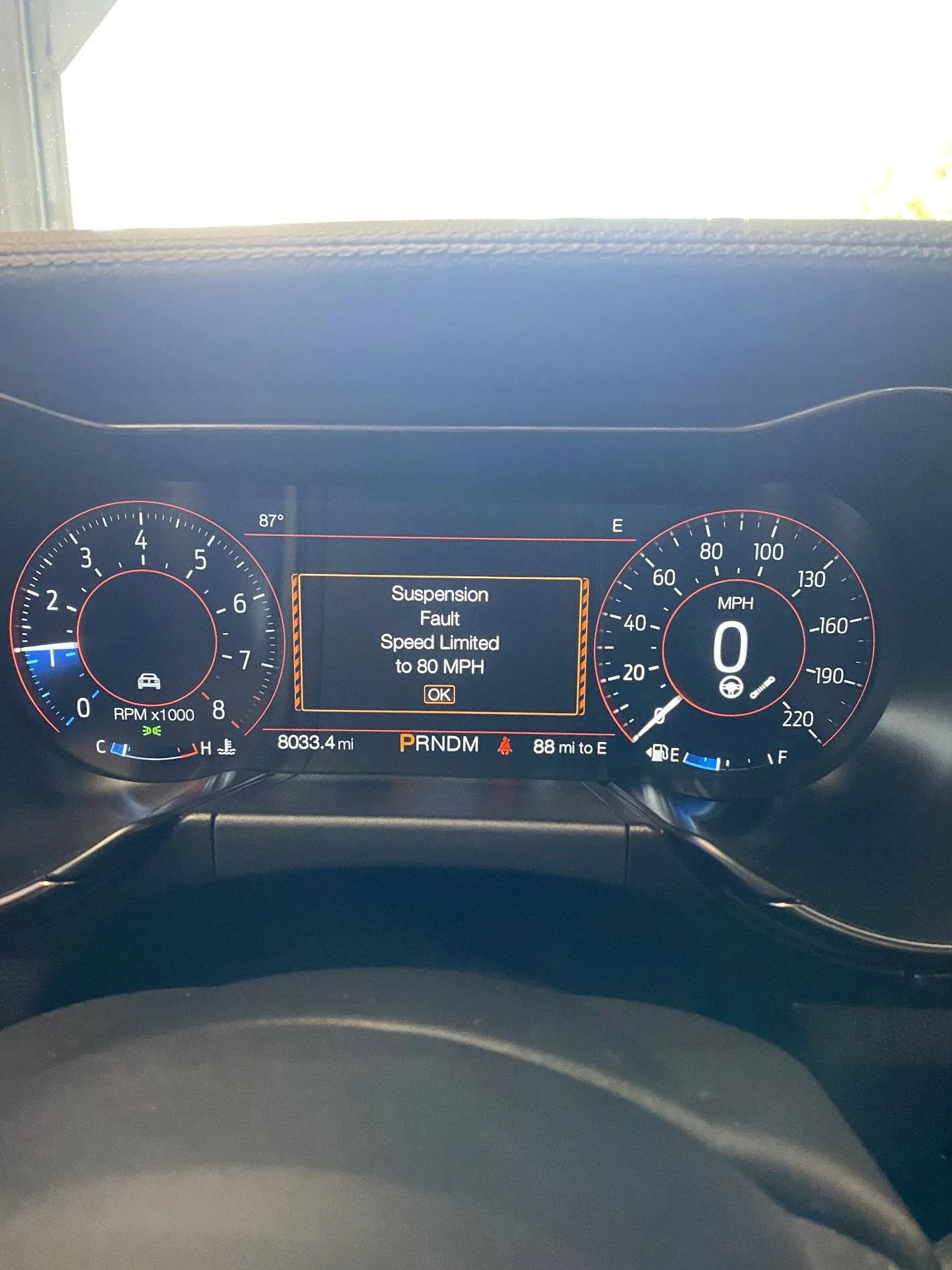

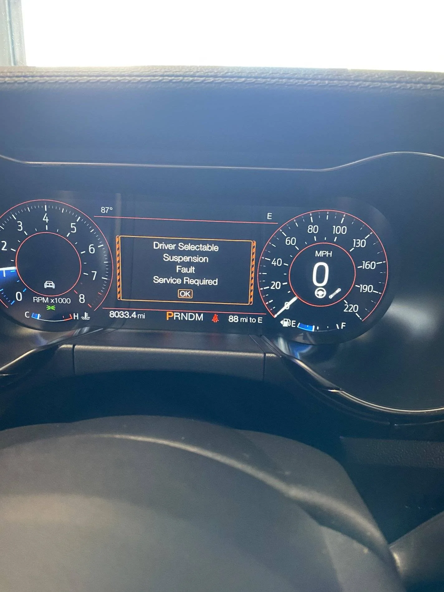

I’ve heard of the exhaust code on some, but anyone getting this code?? Dealership is starting a ticket with ford to figure this out, it’s happening way too often

Looks like one of the magna-ride strut is defective, most likely they will have to replace the faulty strut. Or the sensor that sends the signal to the strut is faulting.
*EDIT* Or the pigtail connector could be loose.

They found a position sensor that was bad the first time, and a connection on a rear with a bent connector on rear 2nd time. It’s a very intermittent fault? It might be good one time but bad next, could start fine but code this in the middle of a drive? Very frustrating!! Dealership is starting a ticket as they are unsure where to look next.
@Tomster , the code will come up suspension fault vehicle limited to 80mph and some times lock me out of drive modes and sometimes not. Plus sometimes locks me out of exhaust also.

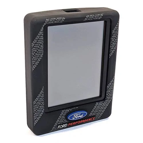

I'd at the very least pick up a budget scan tool as well as the factory service manual and look myself in addition to whatever the dealer does. Just me, but I already have both and would use this issue as an excuse to pick this piece up from FP.
https://performanceparts.ford.com/part/M-12655-F
Thank you for the link, I will get that on order. It would be nice to have.
