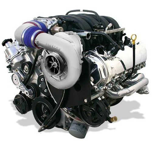

That's just it. With a 12:1 ratio, if I was to boost, I honestly don't think I would want to go above 7psi. Those kits are a couple thousand dollars less. In fact, I've seen sales where NonIC kits sell as low as $3,500, and have a lot less plumbing to deal with.
From what I've read, the NonIC kit pictured above for the 07-09 model, easily pushes another 100-120hp without much trouble. I would love to be able to have a more simplified setup that won't push the engine so hard.

They are not a couple thousand dollars less. An IC costs a few hundred bucks and the piping kit another $200 or so..
The last thing you want is a non intercooled FI kit on any modern motor.
If youre afraid of high boost, install a 3.8 pulley vs. the standard 3.6 supplied with the kit and you should stay around 7 psi.
07-09 3V 4.6 is a totally different engine comparing it to a coyote is a bit of an insult to the coyote LOL.......

The '06 Paxton kit is $3,500. The "09 Vortech kit is $3.900, and that's not even on sale. So, yes, they are significantly less expensive when you eliminate all the plumbing and the intercooler. All you have is a compressor, belt, maybe a couple pulleys, and a small inlet/outlet pipe from the filter box. Much less complicated when running a lower boost system, and lower chance of maintenance issues as well. Granted that's for the 4.6L running a lower ~10:1 ratio.
But still, is it not feasible to run a low boost Non-IC compressor on a 12:1 engine?
Maybe they just decided the lower boost systems weren't selling as many, since everyone always seems to be more interested in maximum power.
Huh?
Those systems come with a different blower than the coyote systems which will lower the price in and of itself.
You’re a self proclaimed engineer... just buy the turbo system I bought and build it yourself and save tons of money.
