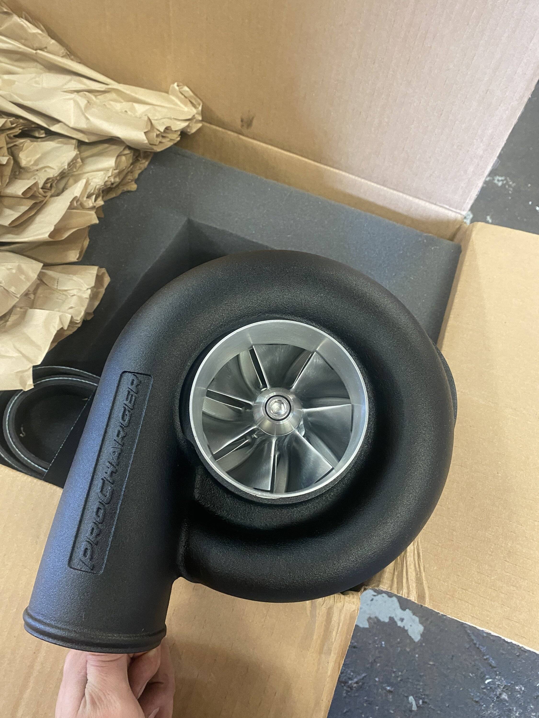

First things first, I knew going into this I wanted to be boosted. Wasn’t sure what route I wanted to go but was mostly leaning towards a gen 5 whipple 3.0l. Given my current job as an automotive performance technician I get to drive a lot of setups for dataloging and diagnostic purposes so that led me to toss the whipple out the window and get a centri.

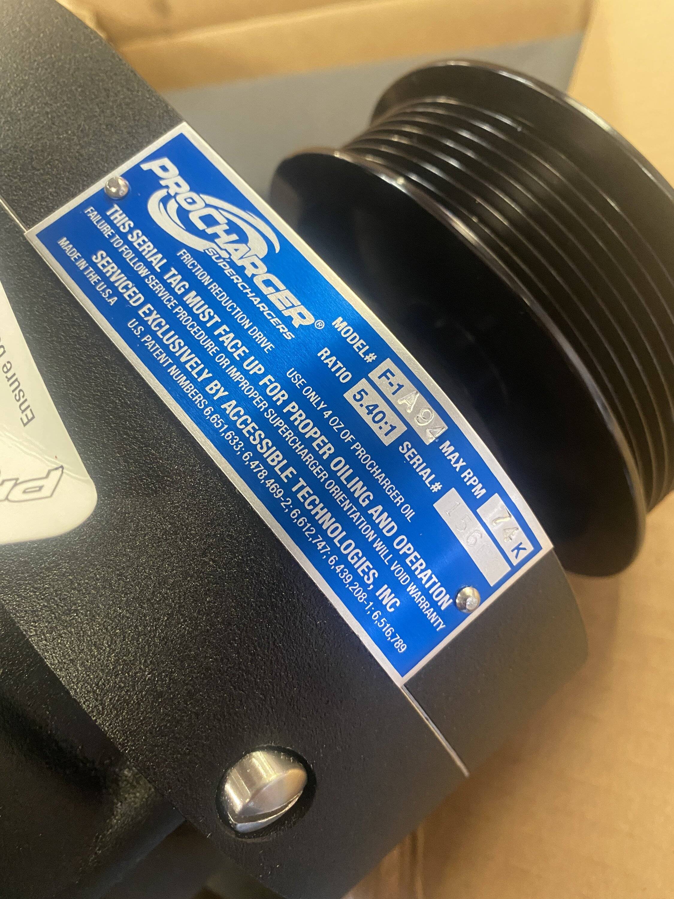

Couldn’t be just any old procharger. I had to go big.

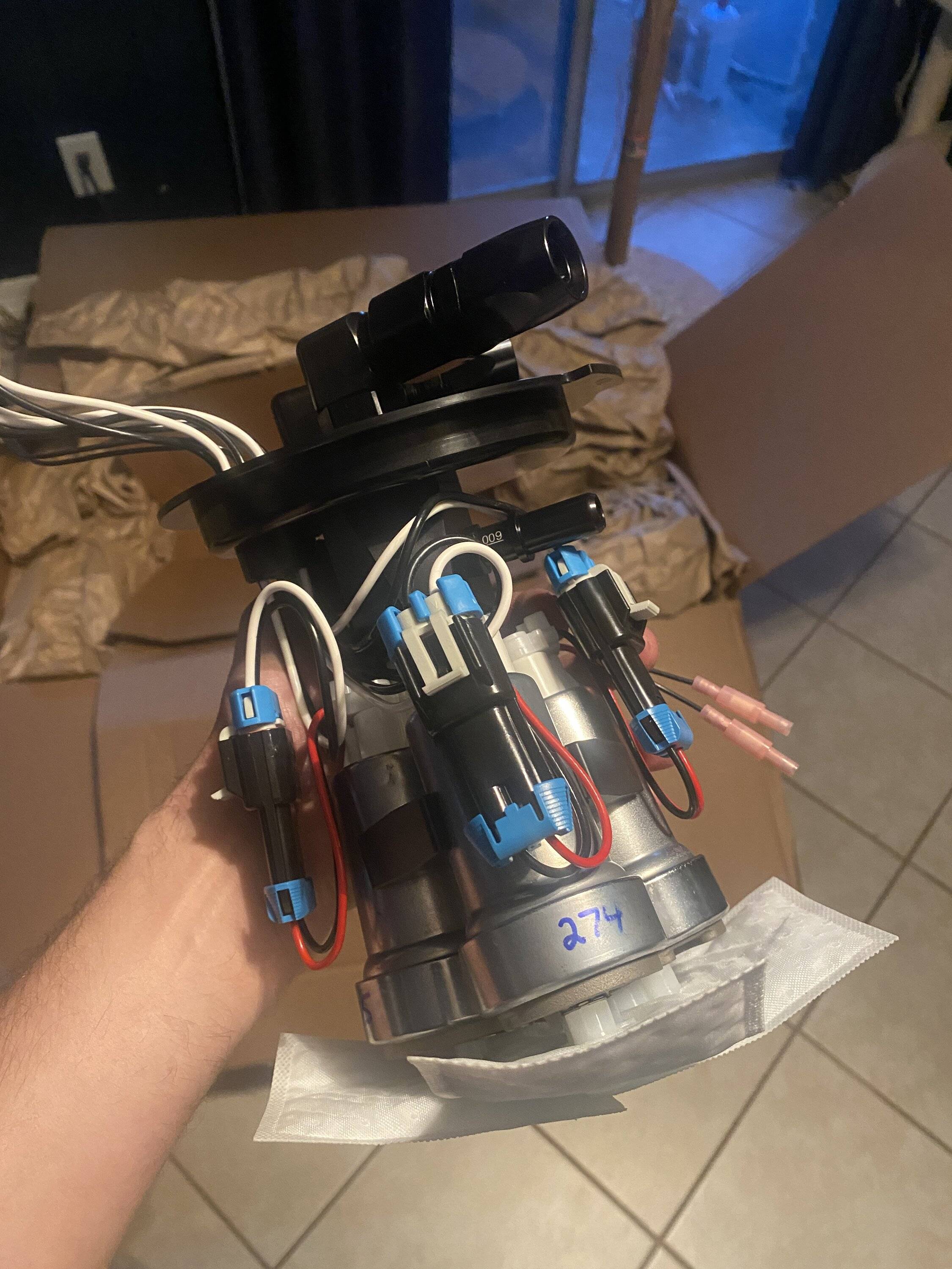

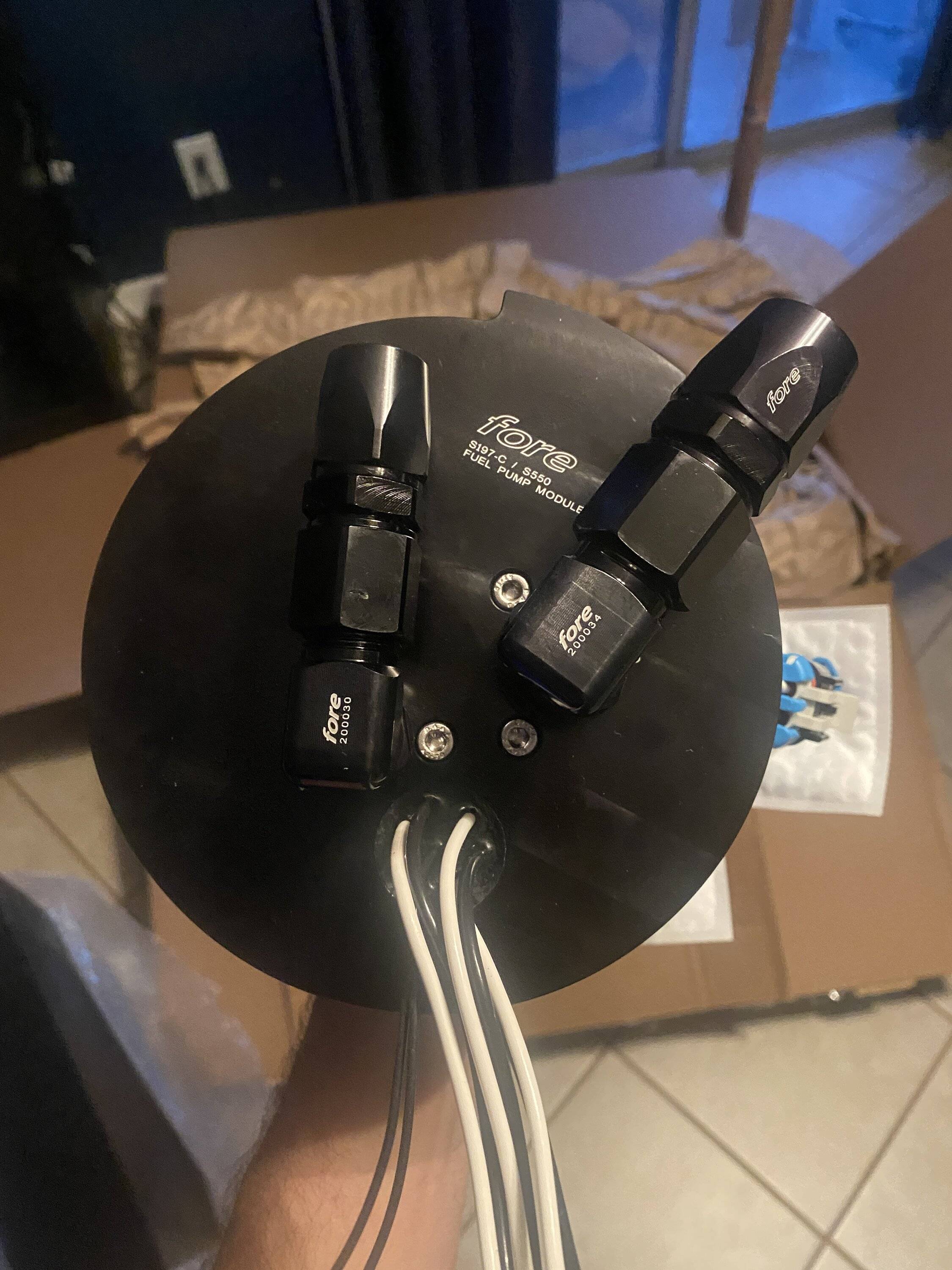

I planned on backing this thing up with a Fore Innovations triple pump return style fuel system and FC3 Controller.
The hat is outfitted with two TI285 and one TI274 pumps, that should be more than adequate to get this job done.

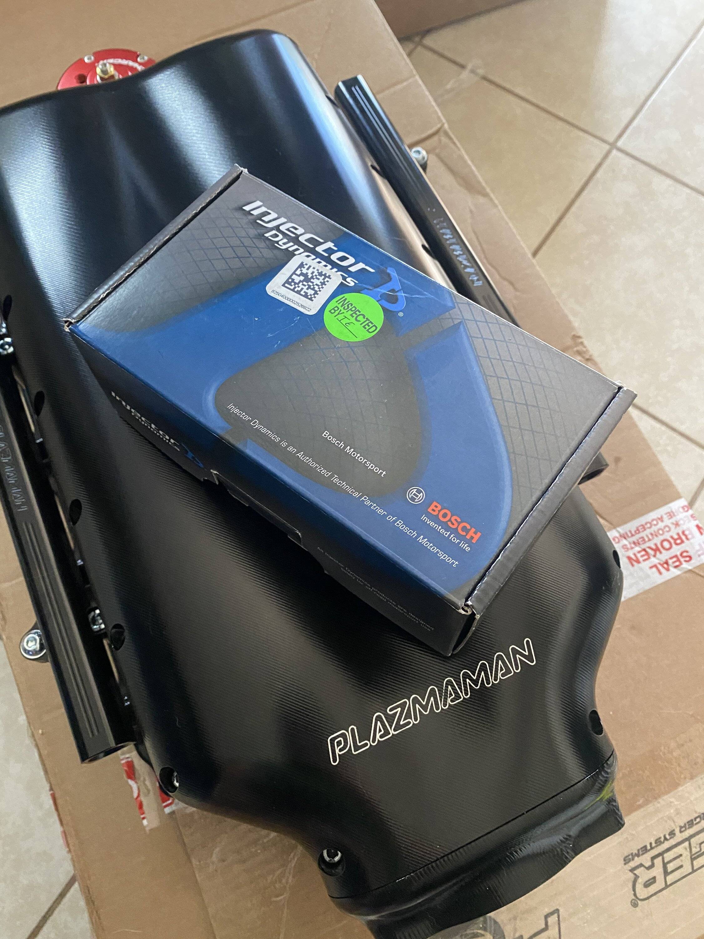

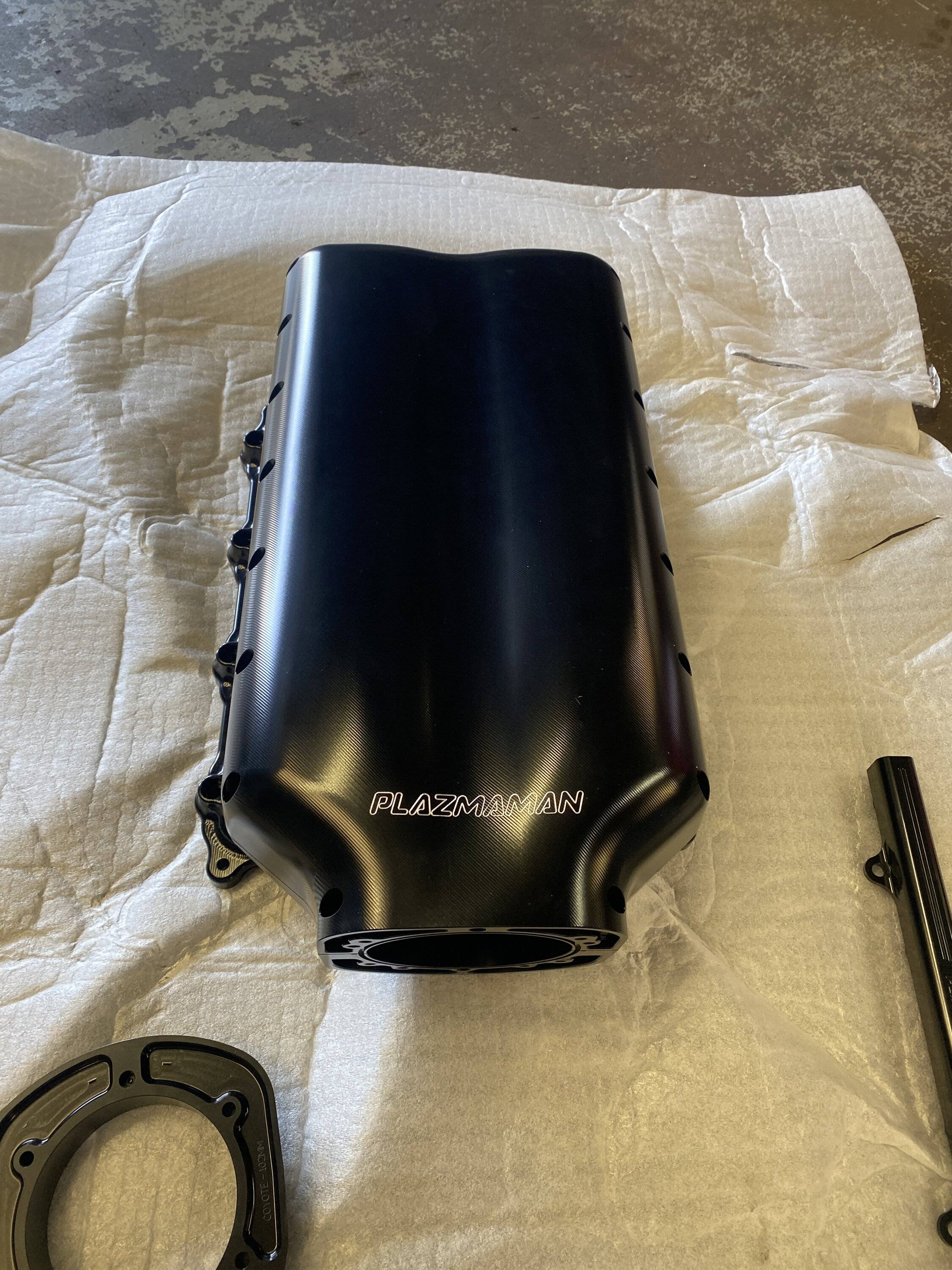

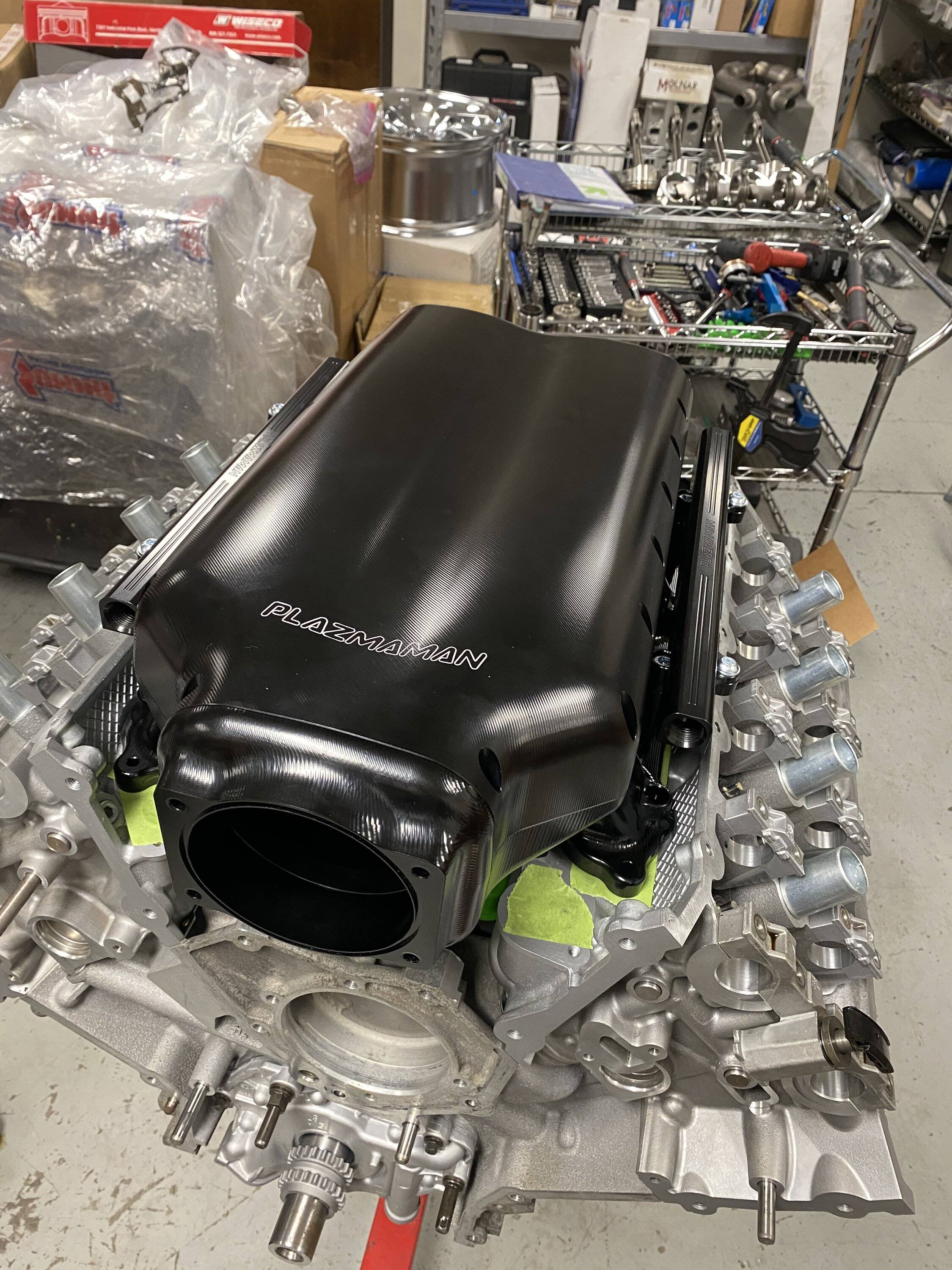

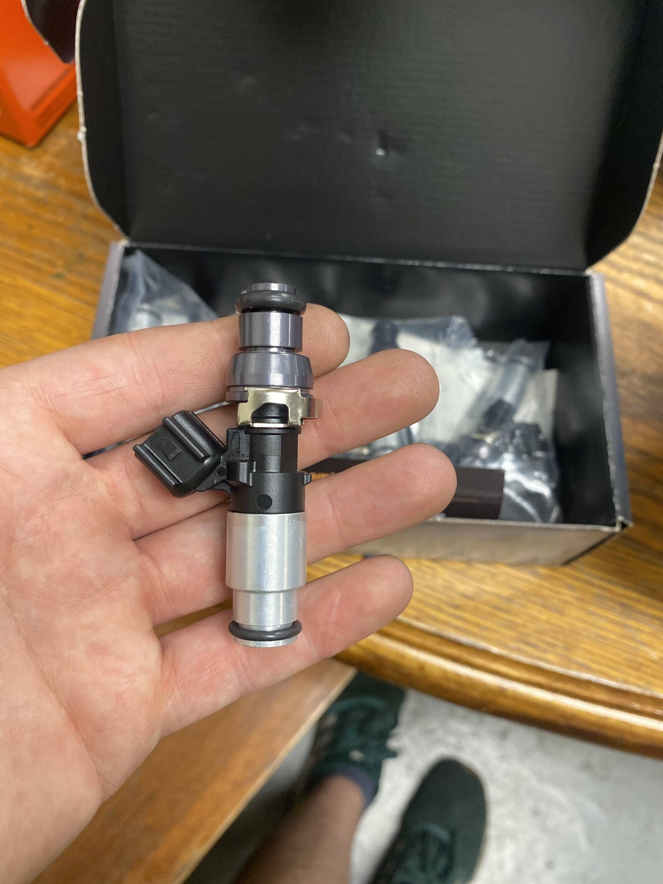

Will also be running Injector Dynamics ID1700Xs and a Plazmaman intake manifold, just because I can.
Here’s the manifold on a customers coyote for visual purposes

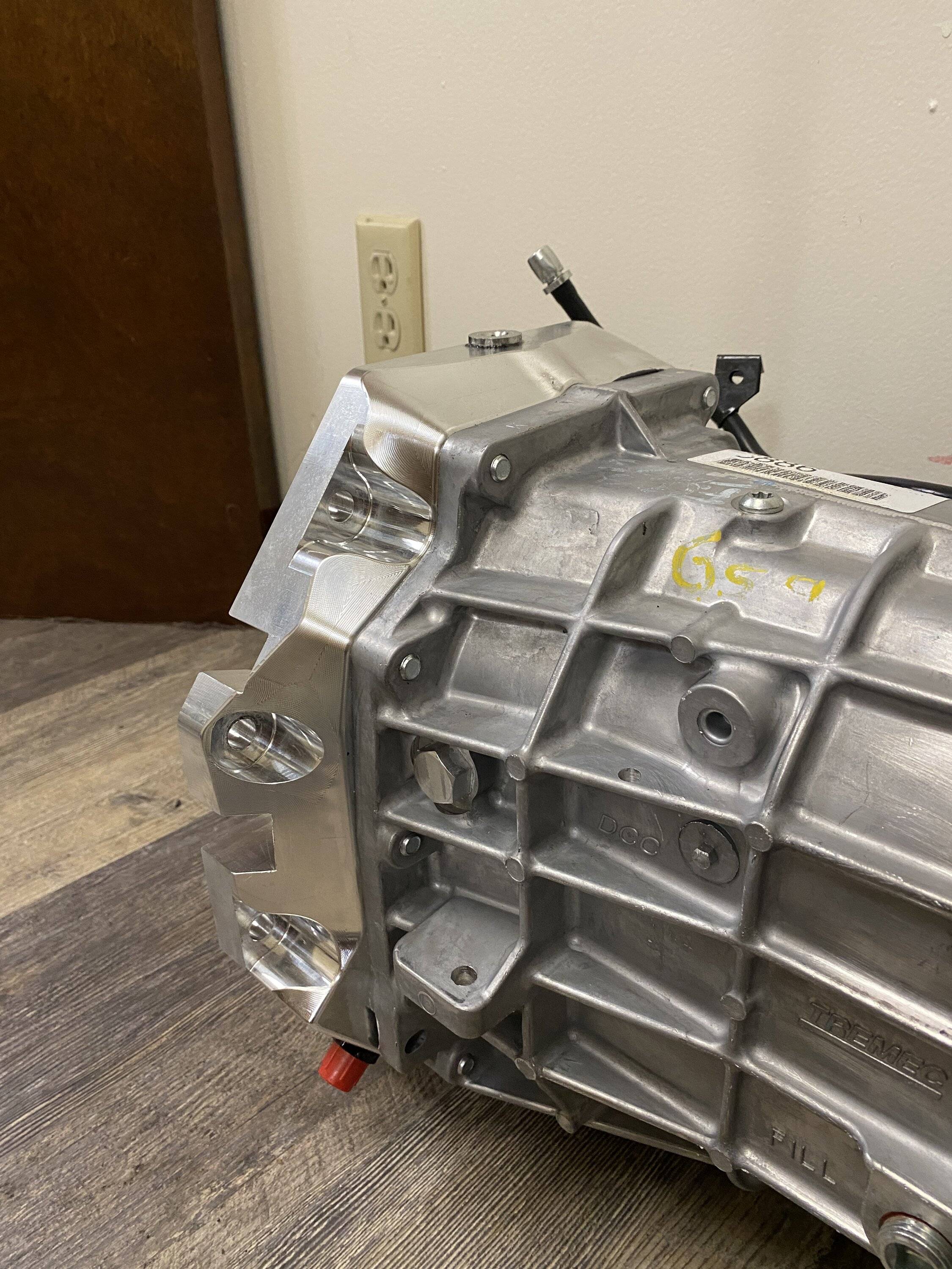

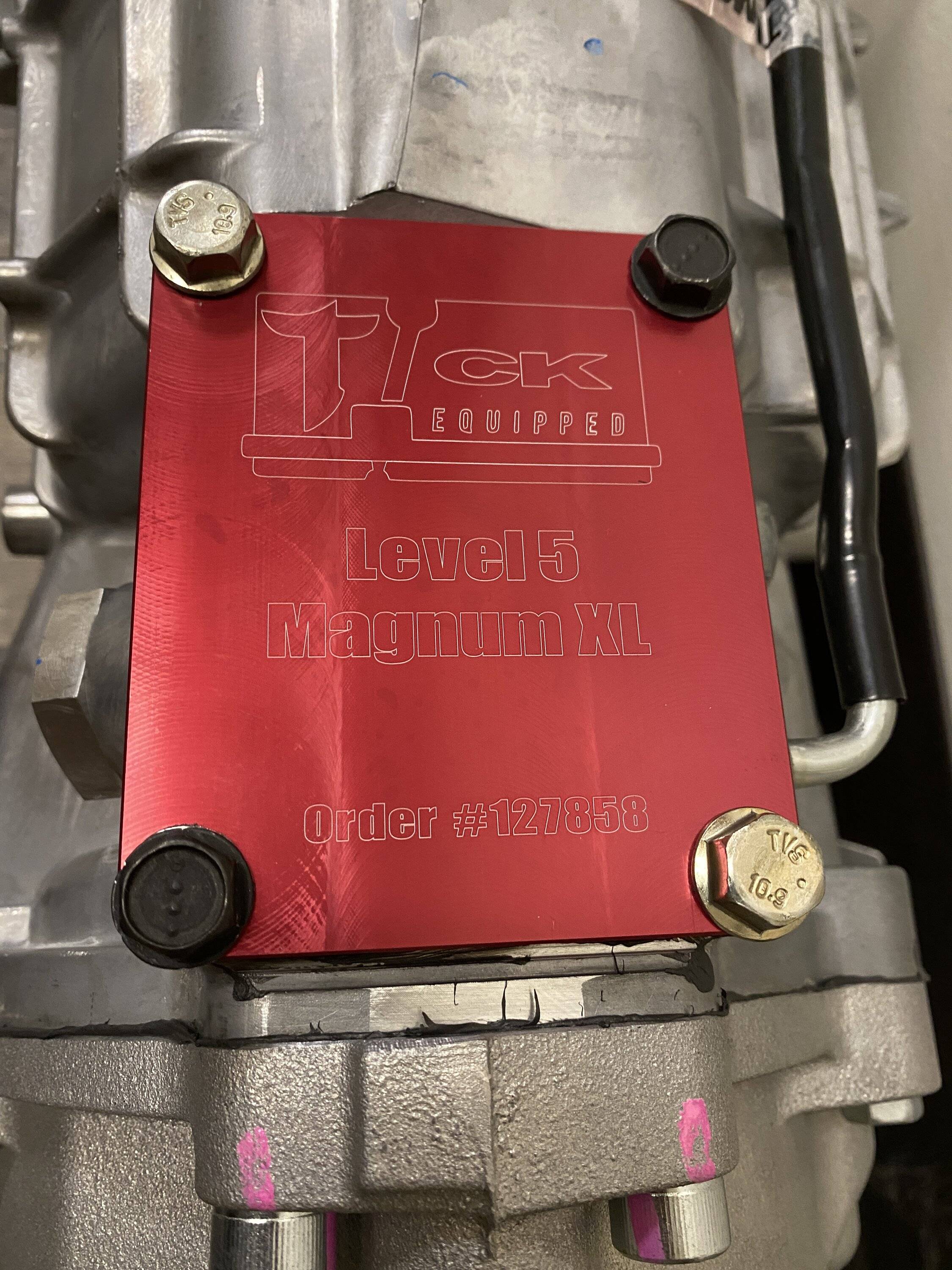

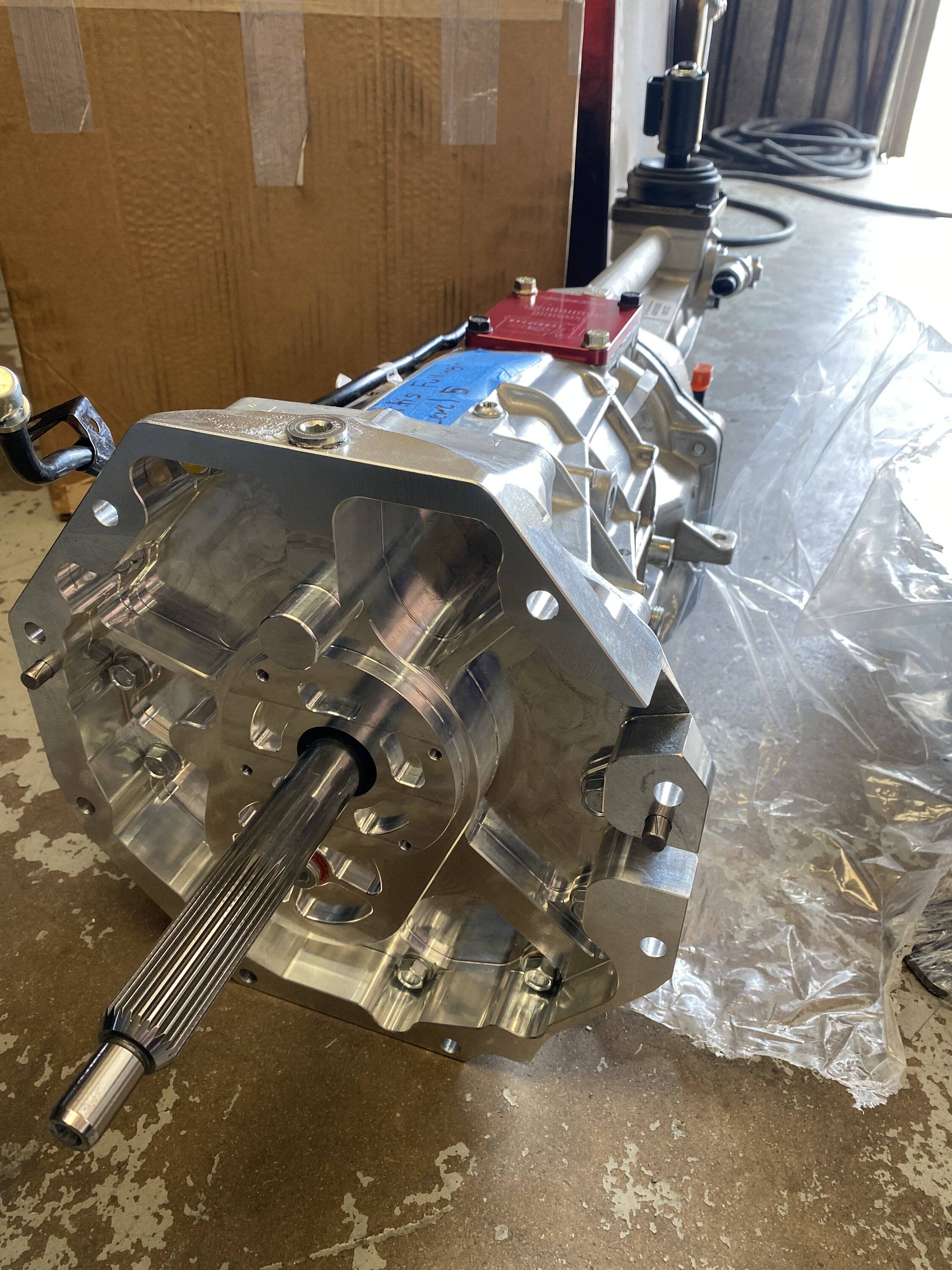

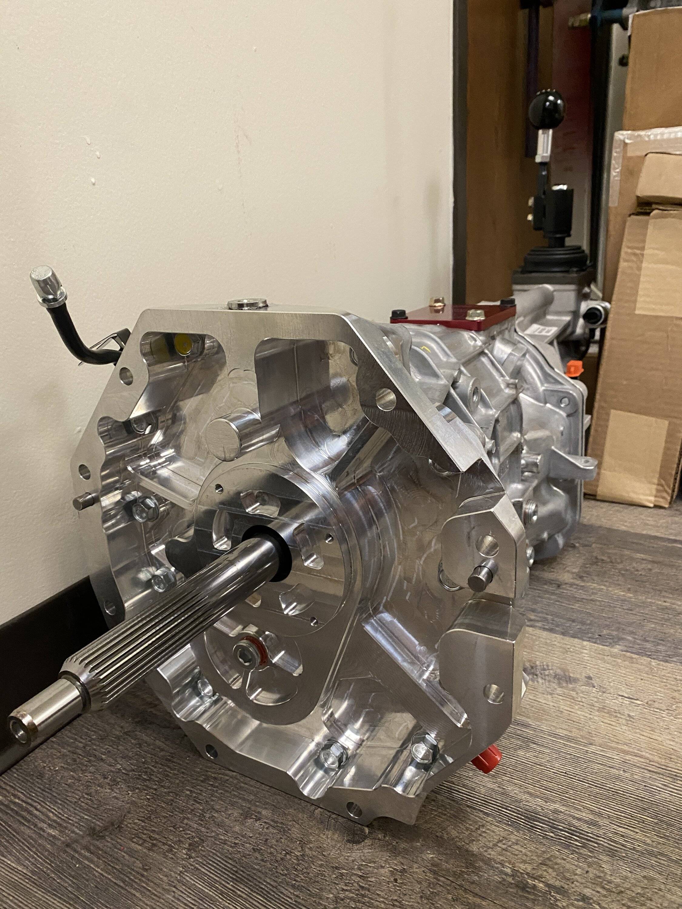

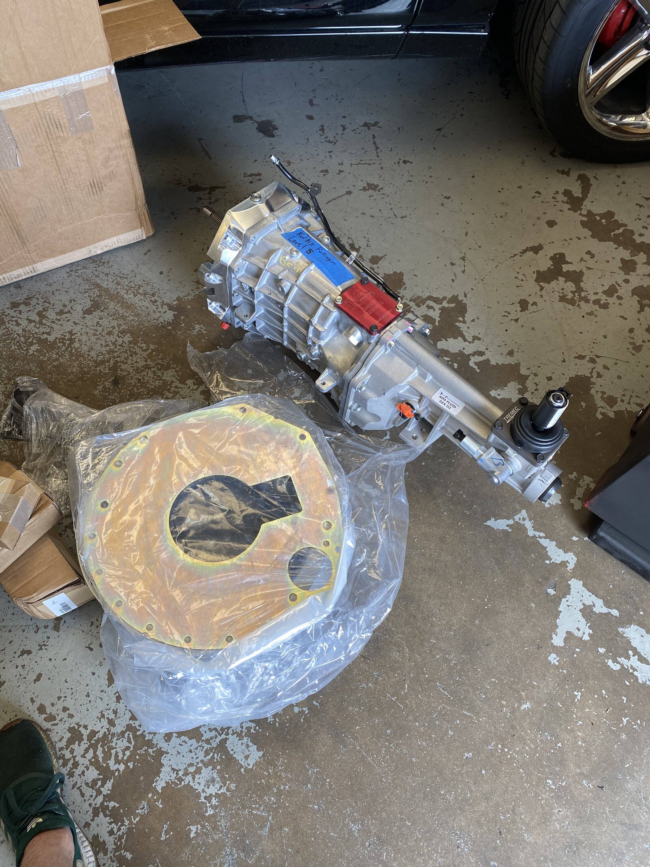

Obviously the stock engine and drivetrain aren’t up to snuff so to remedy that I’ll be doing a T56 Magnum Xl swap, built by Tick performance. (Will circle back to this)
The magnum xl swap come with a cross member and sfi approved bellhousing, so that just leaves the clutch and driveshaft to complete the package.

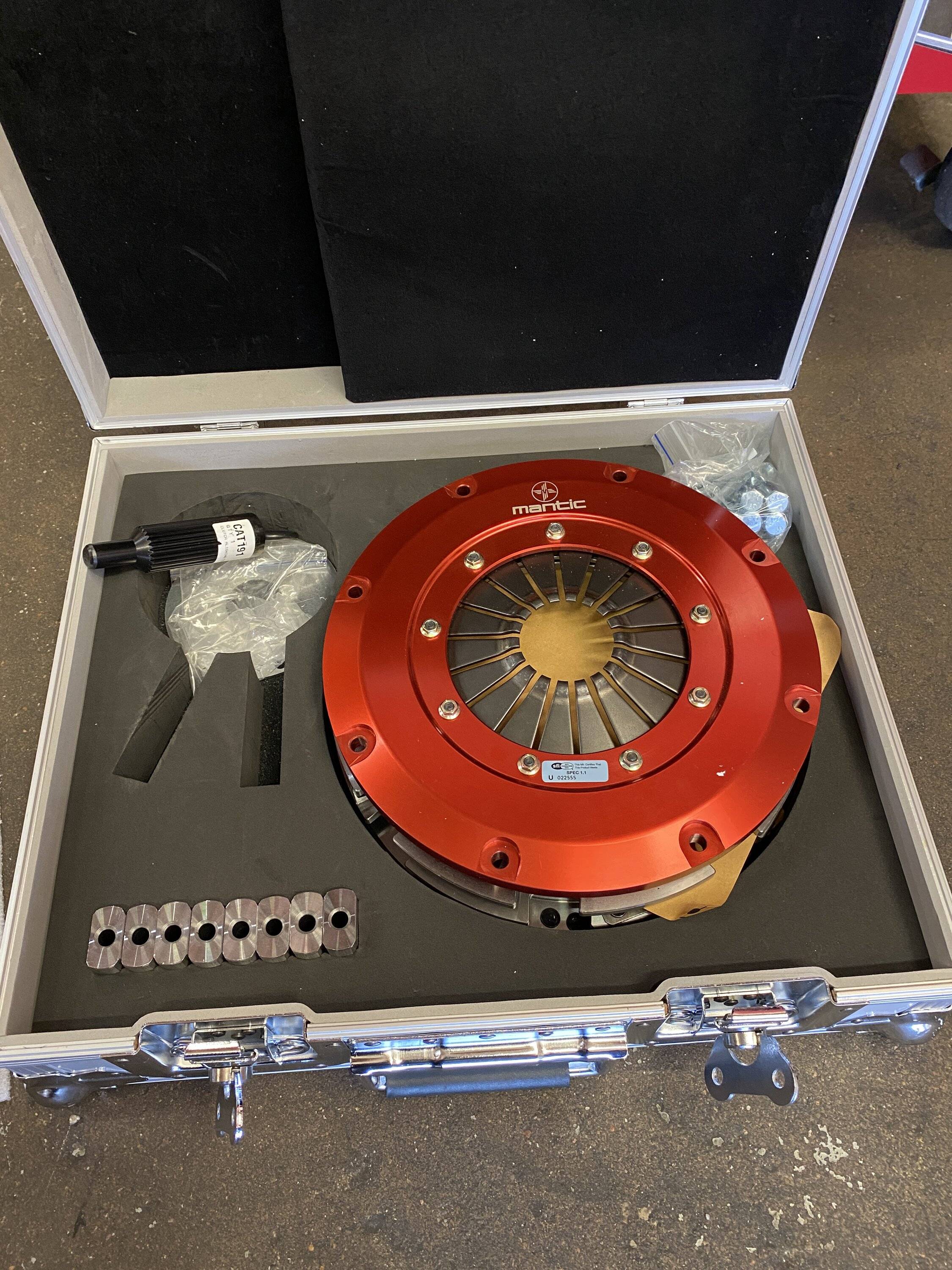

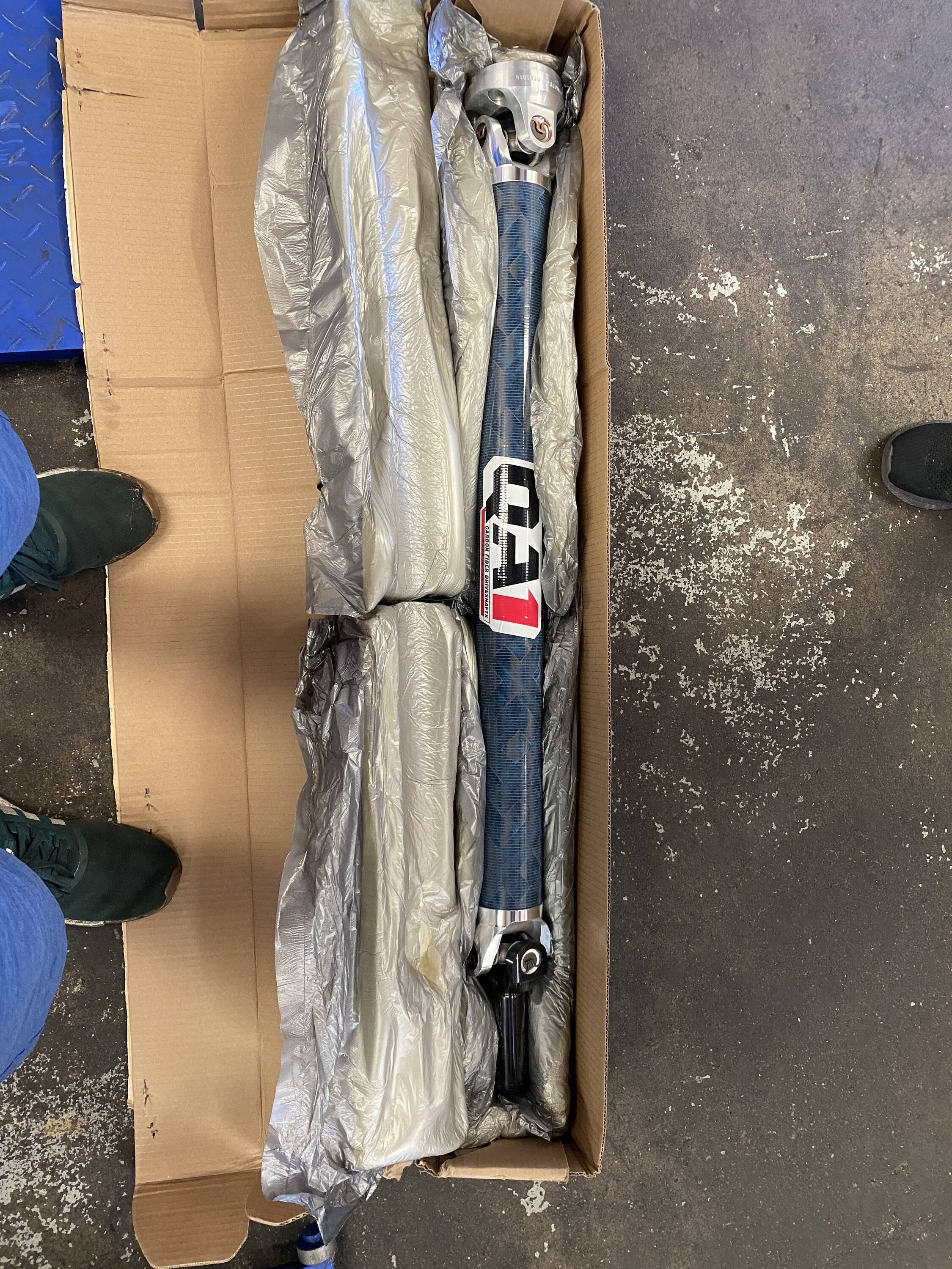

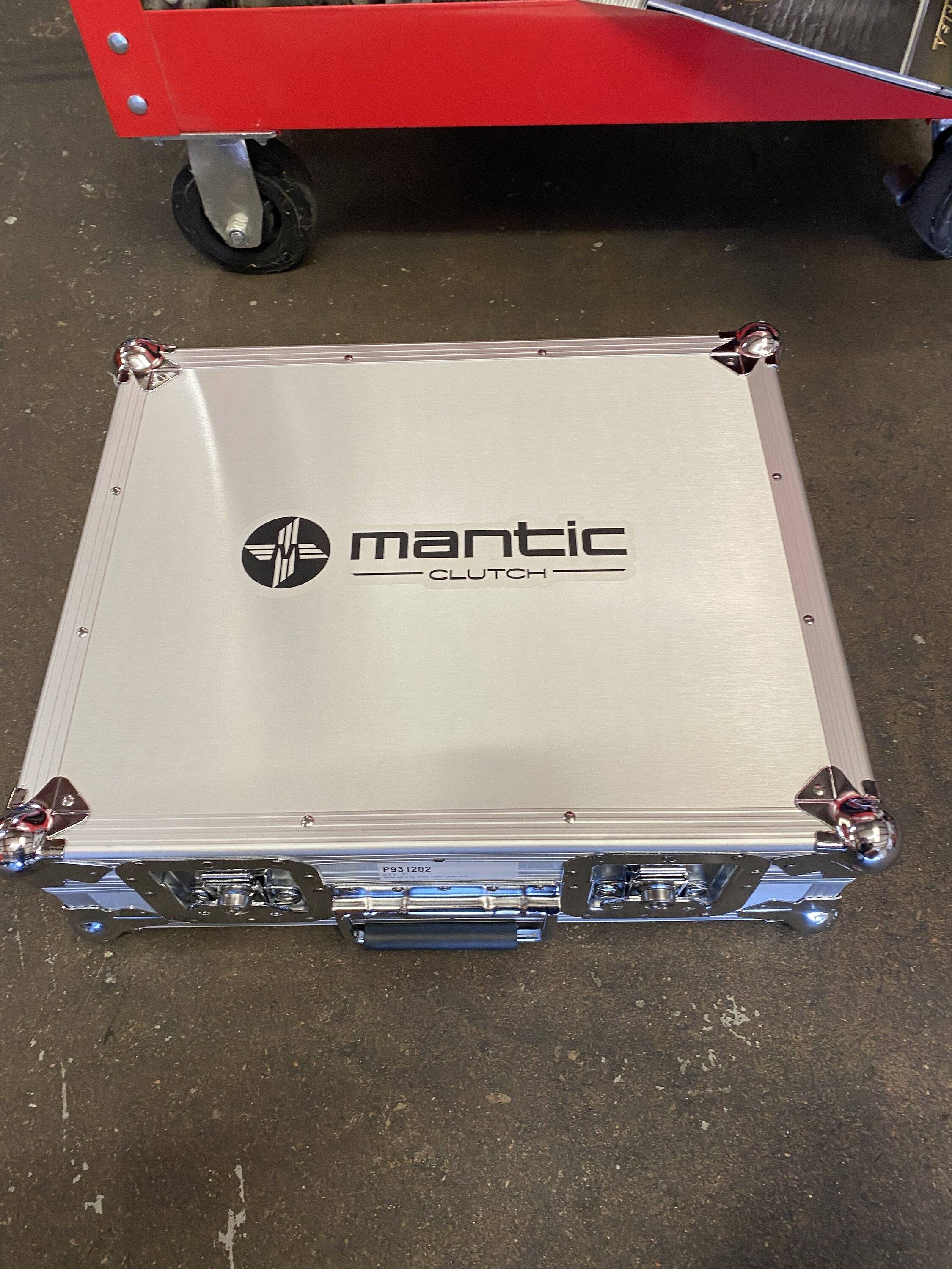

I chose to go with a mantic triple disc and a QA1 carbon fiber driveshaft.

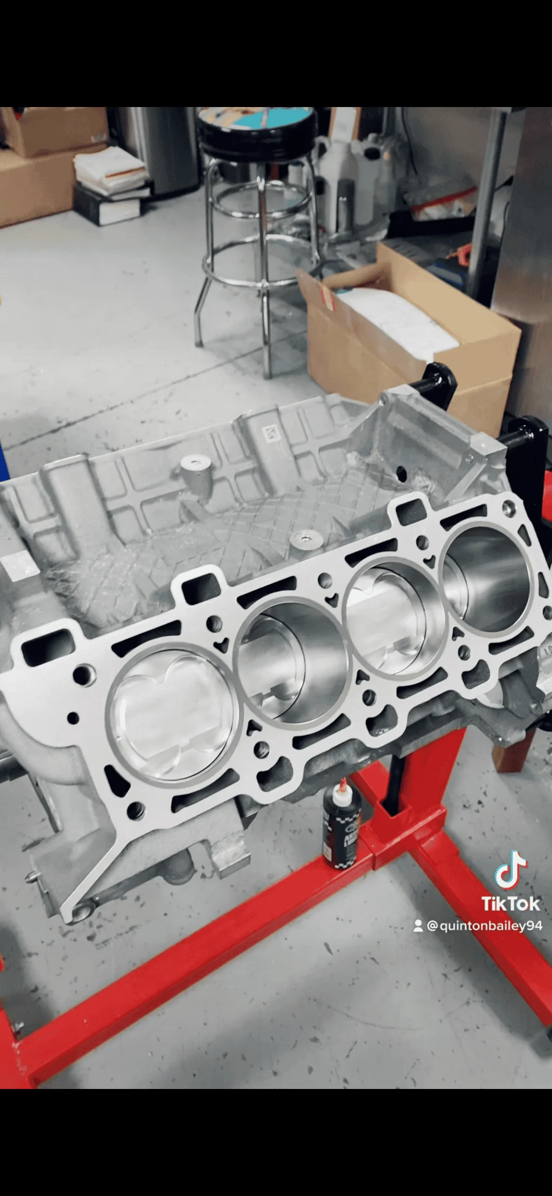

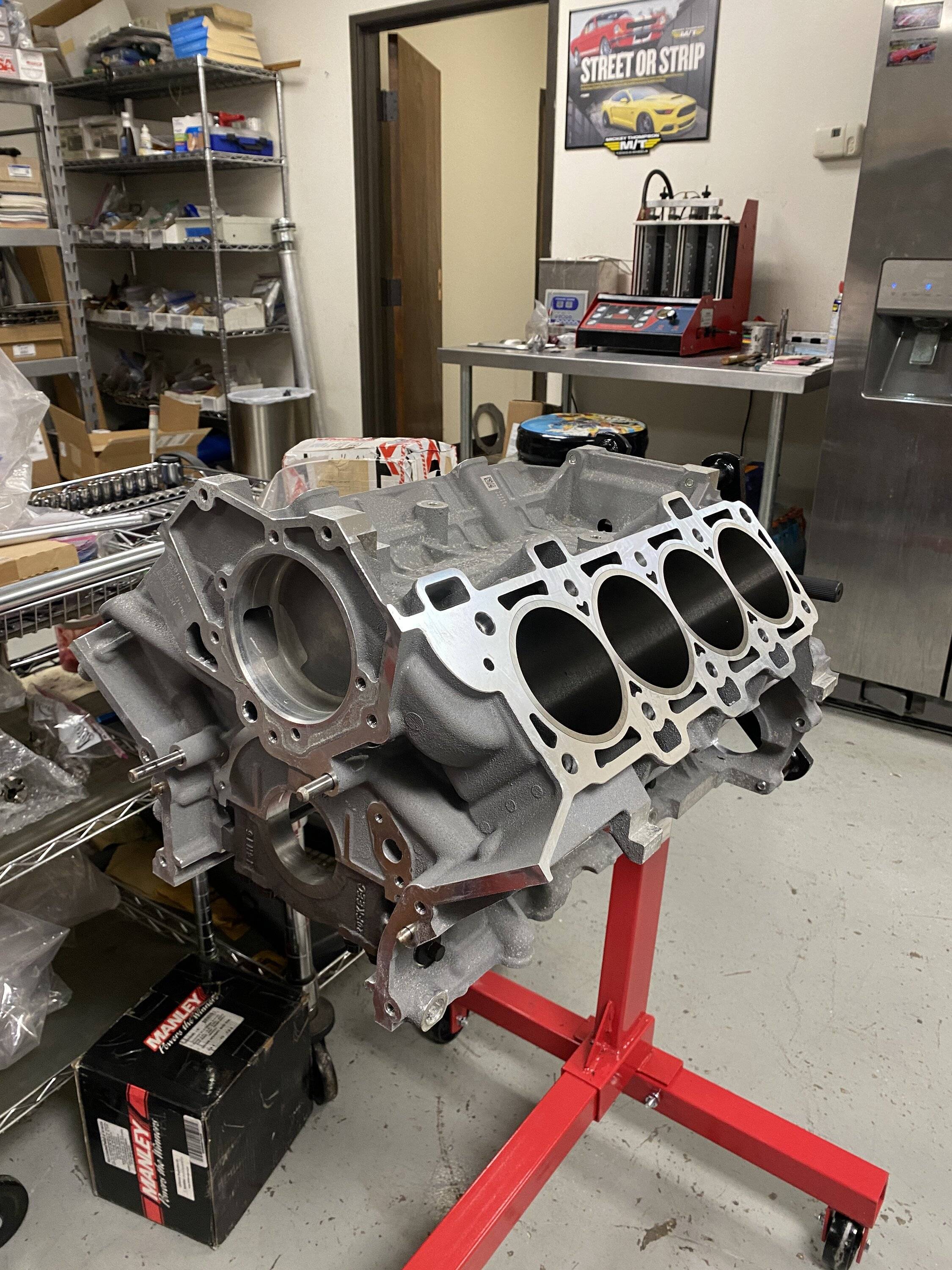

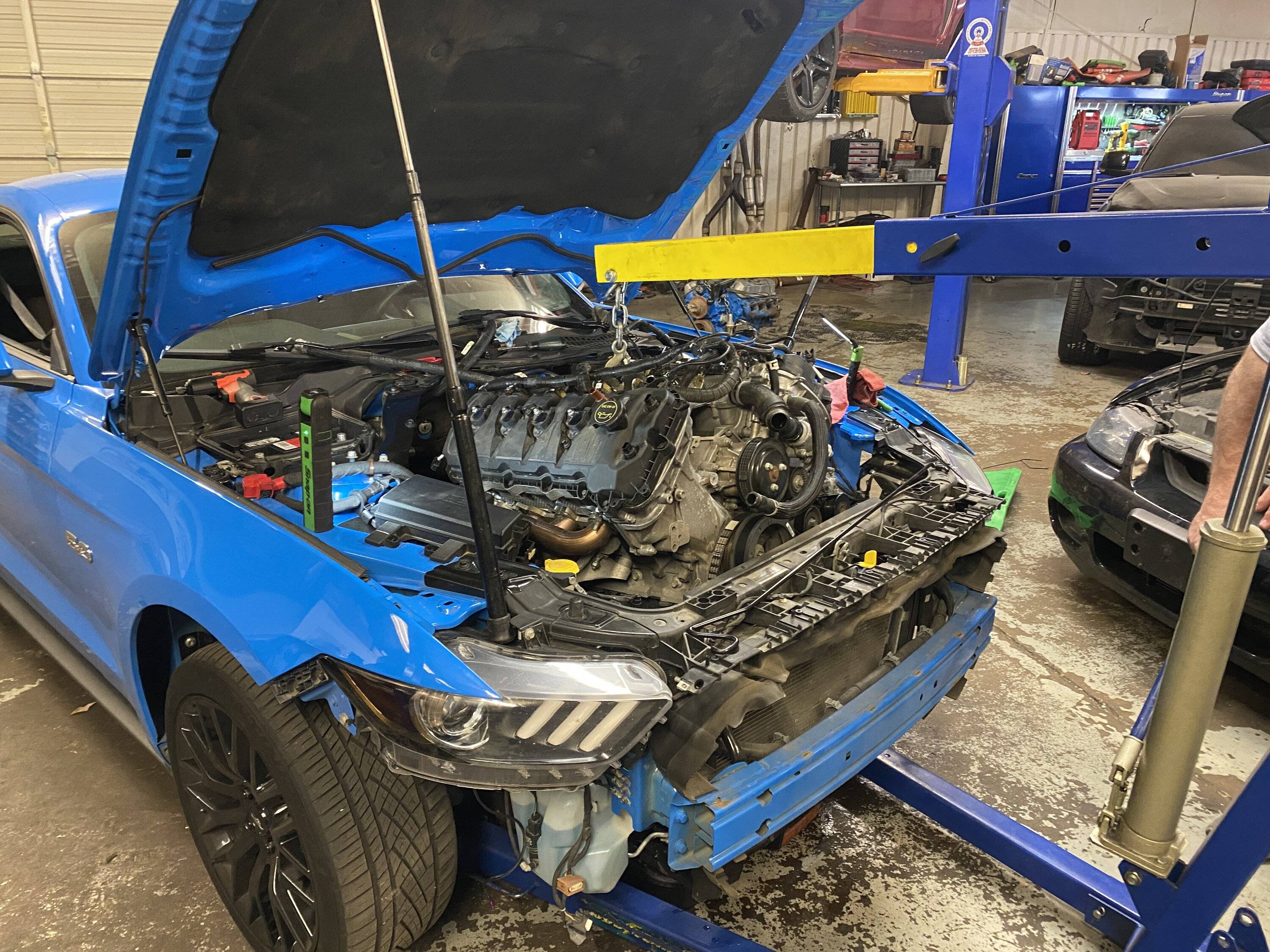

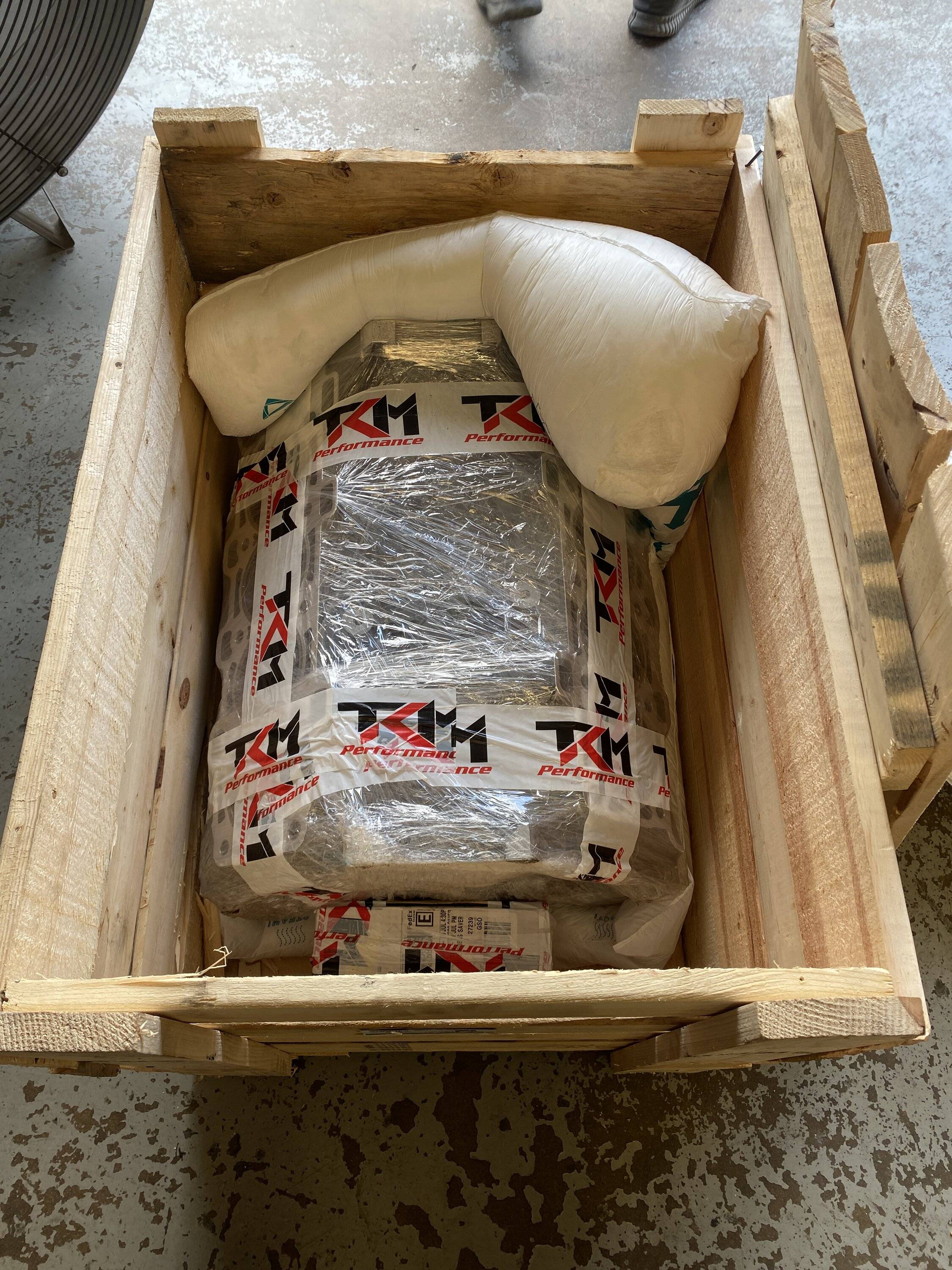

Don’t worry we’re going to build a motor for this thing too. I came across a gen 2 coyote that a customer blew a ringland in and decided not to use in his build, so I picked up the short block for cheap and sold the rods and crank out of it. Sent the block out to TKM and had it sleeved and drilled for 1/2” head studs.
She arrived back about 3 or 4 weeks later, nicely crated up.

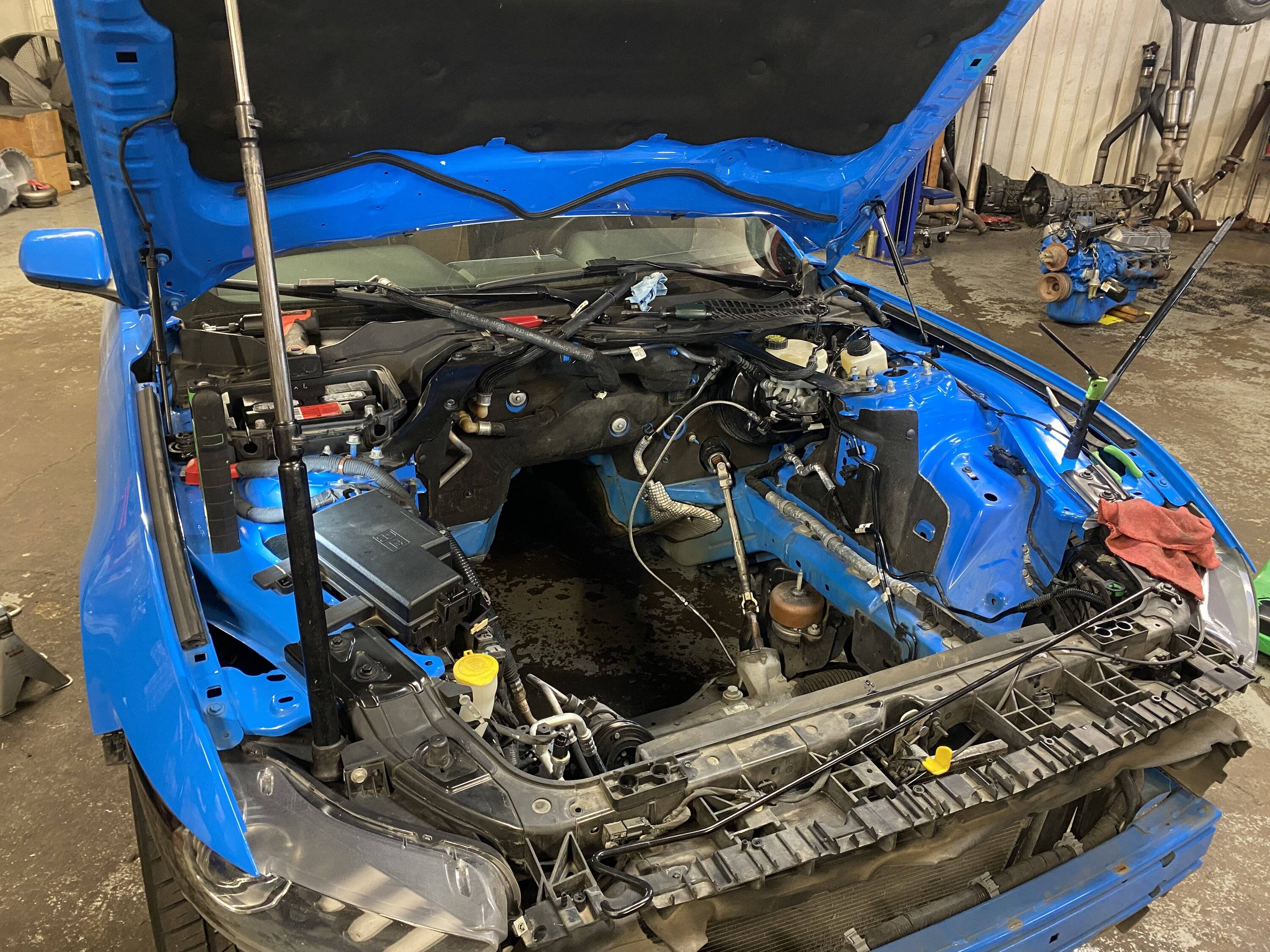

Promptly got her on an engine stand and in the engine room.

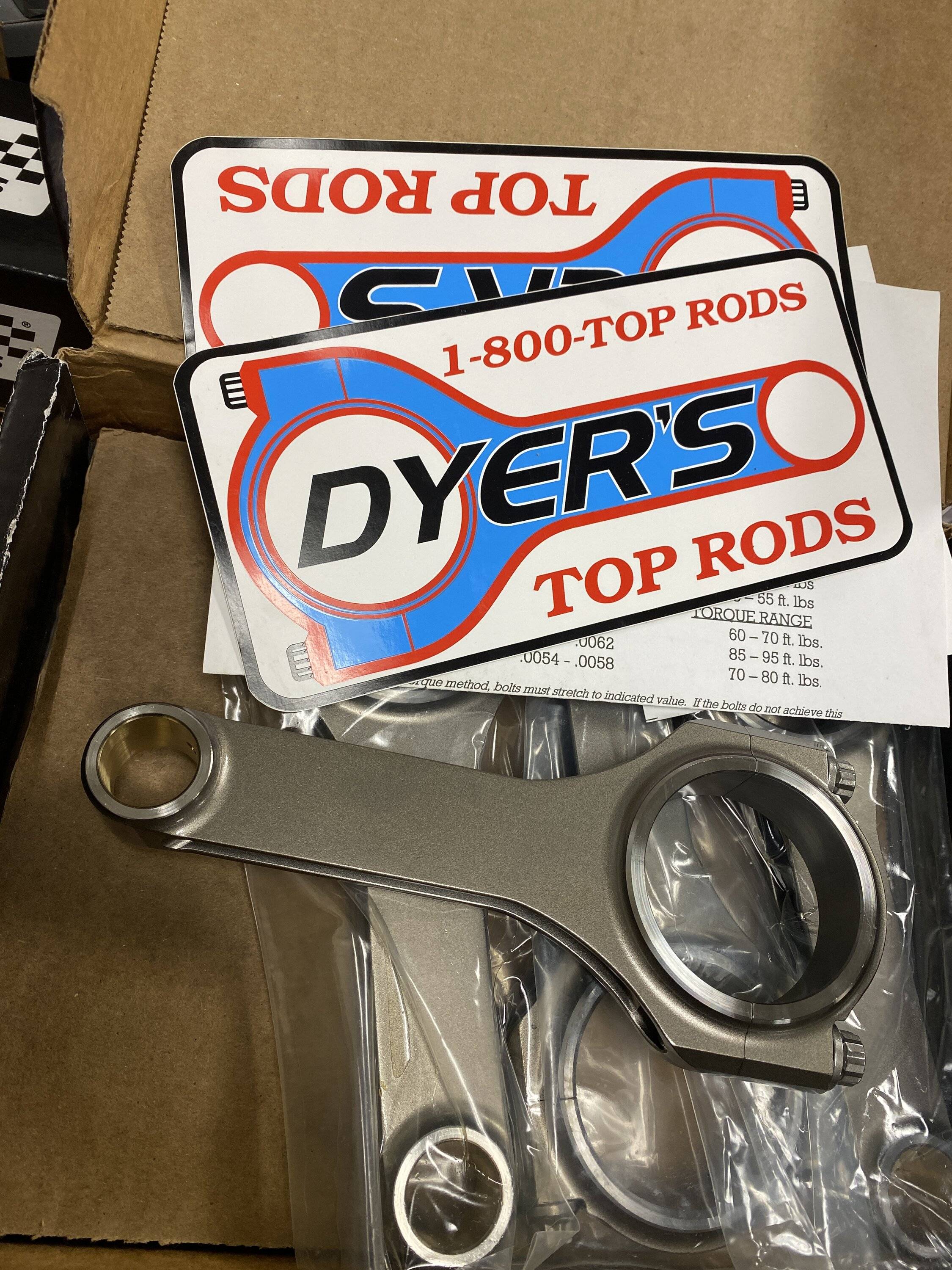

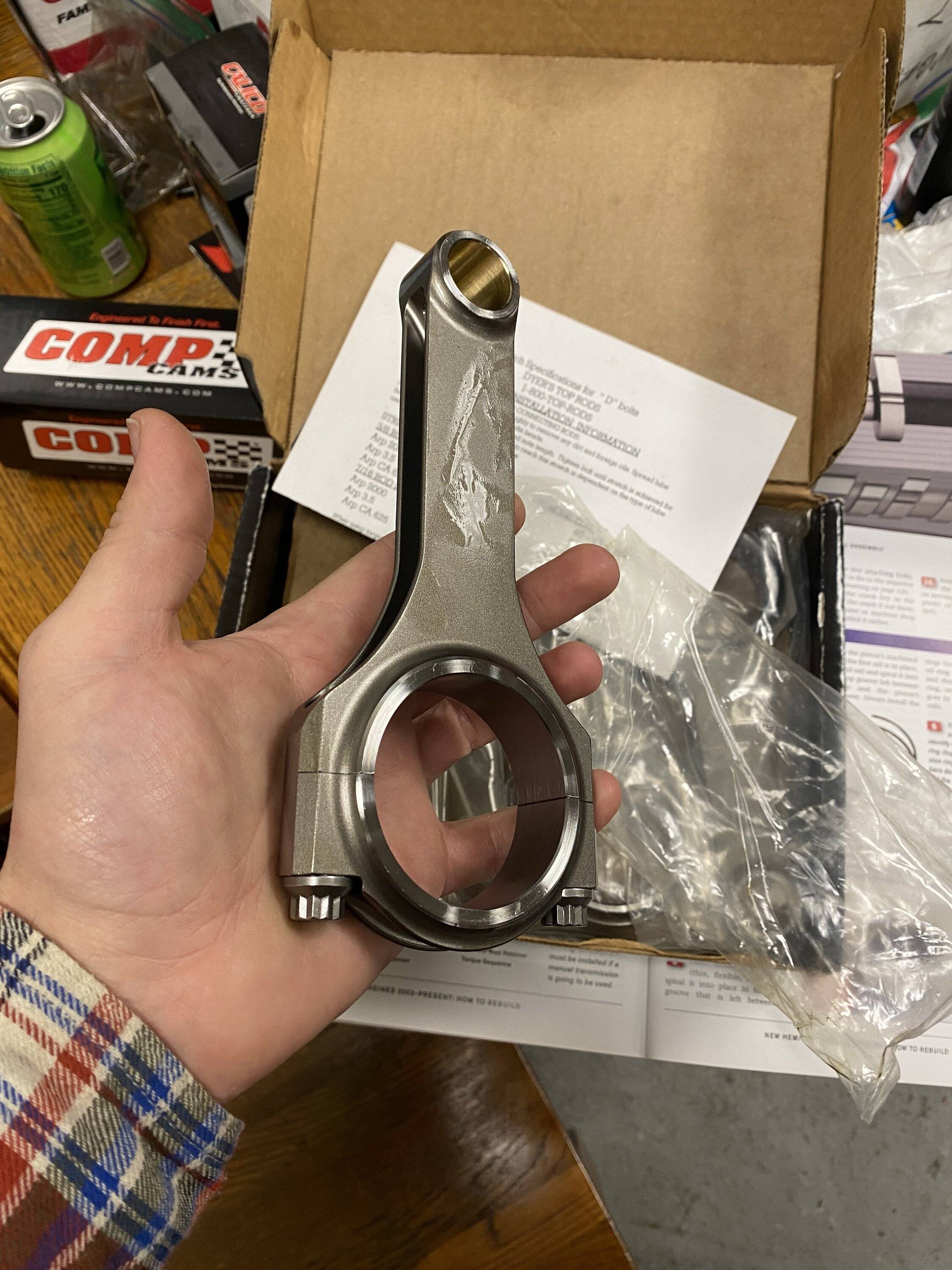

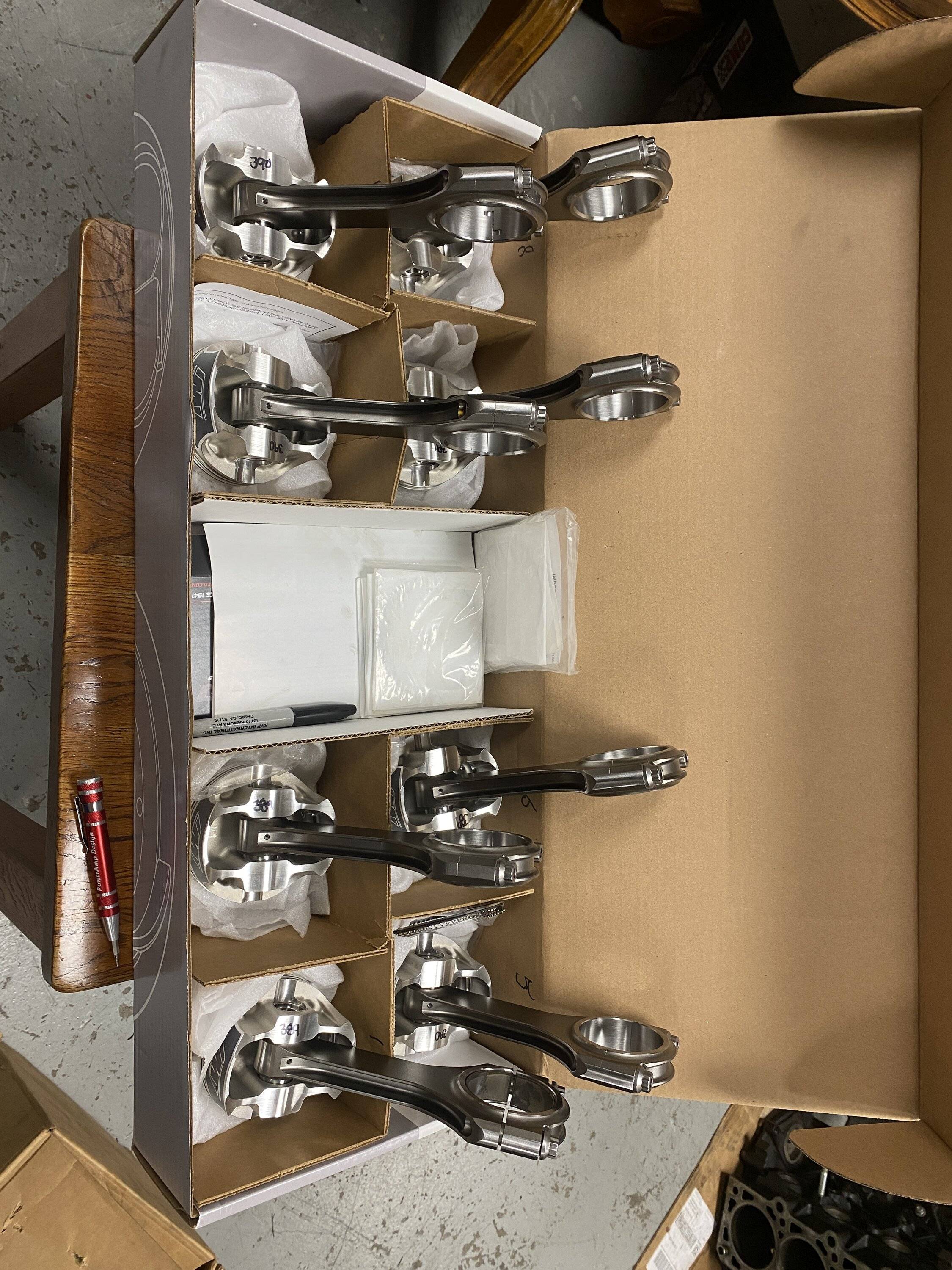

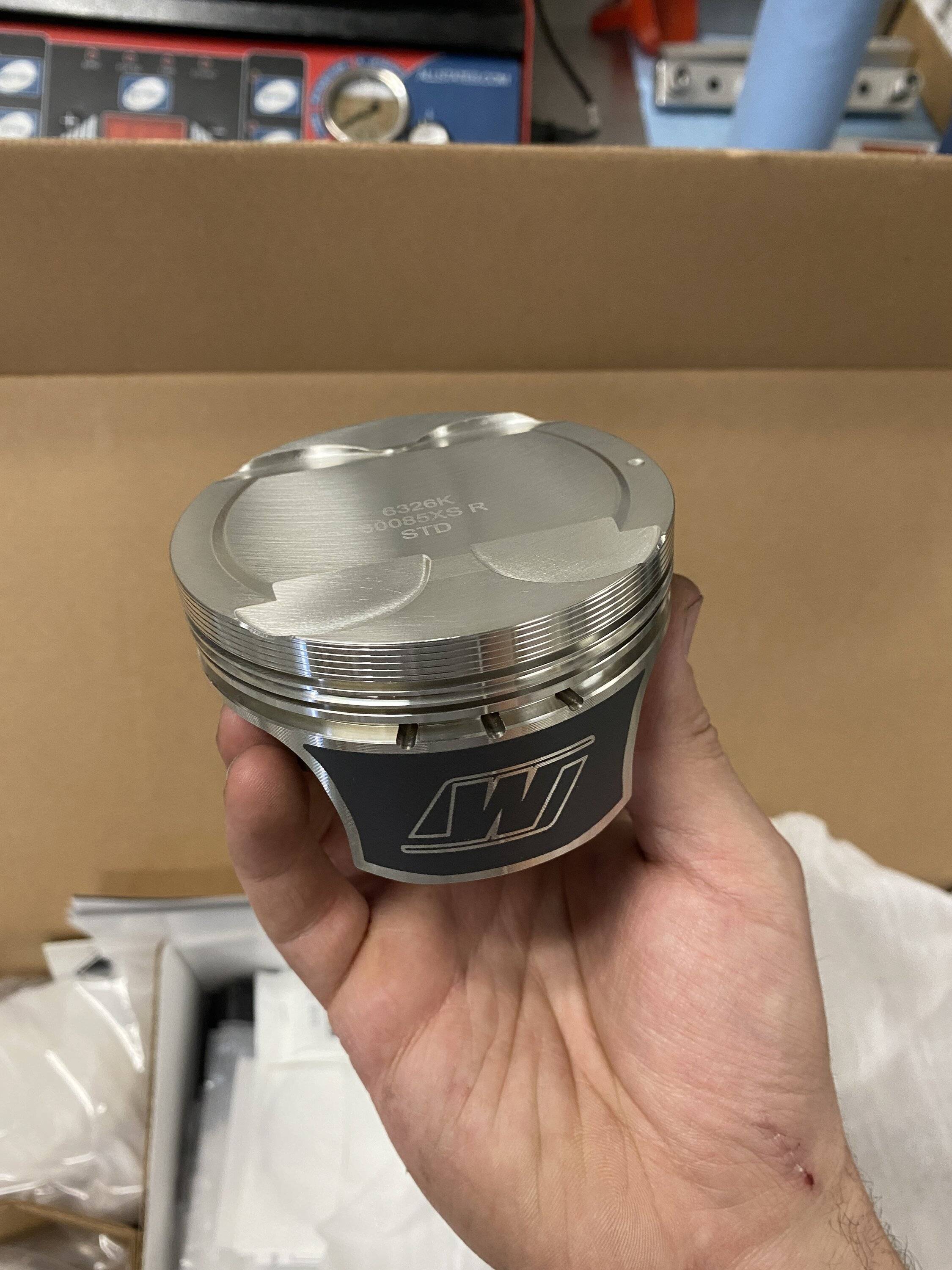

Went with a set of Wiesco pistons with upgraded wrist pins and a custom set of Dyers rods.

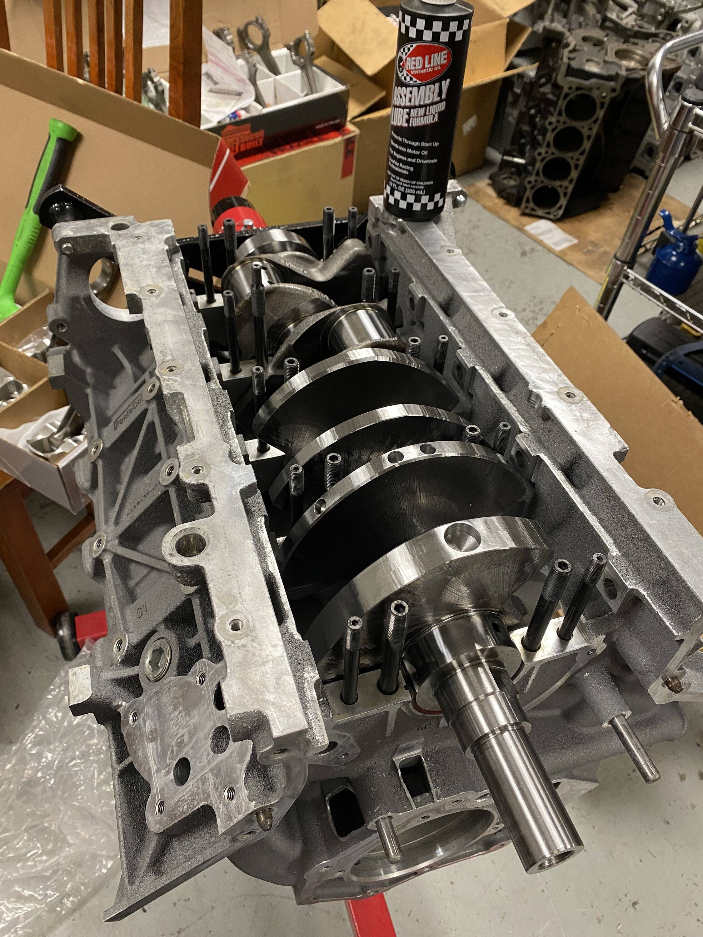

Went ahead and threw the short block together.

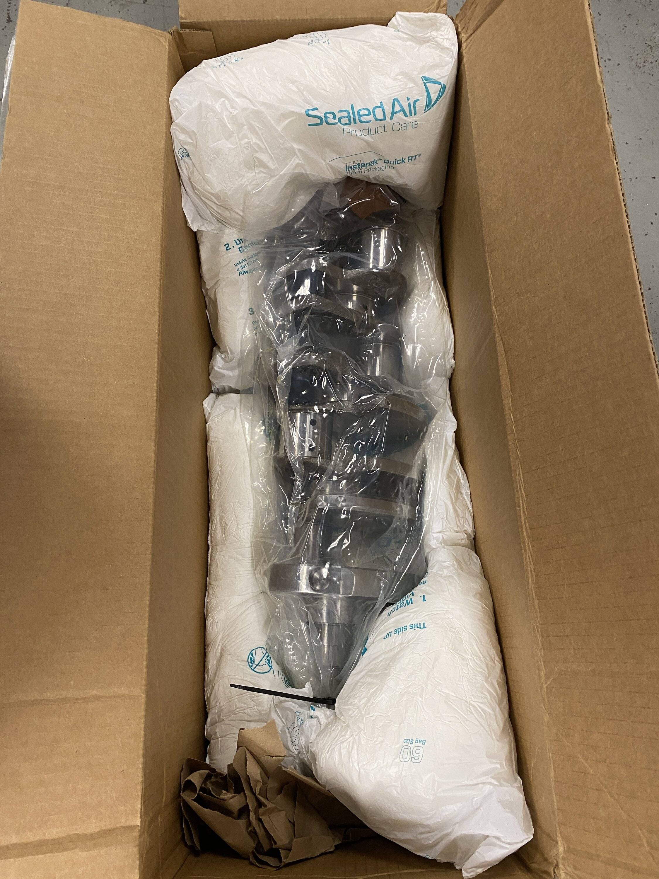

Heres the brand new Boss crankshaft had the balancing done at Modular Head Shop in Florida since that’s where my rods were coming from and my head work is also being done there.
Rods and pistons assembled

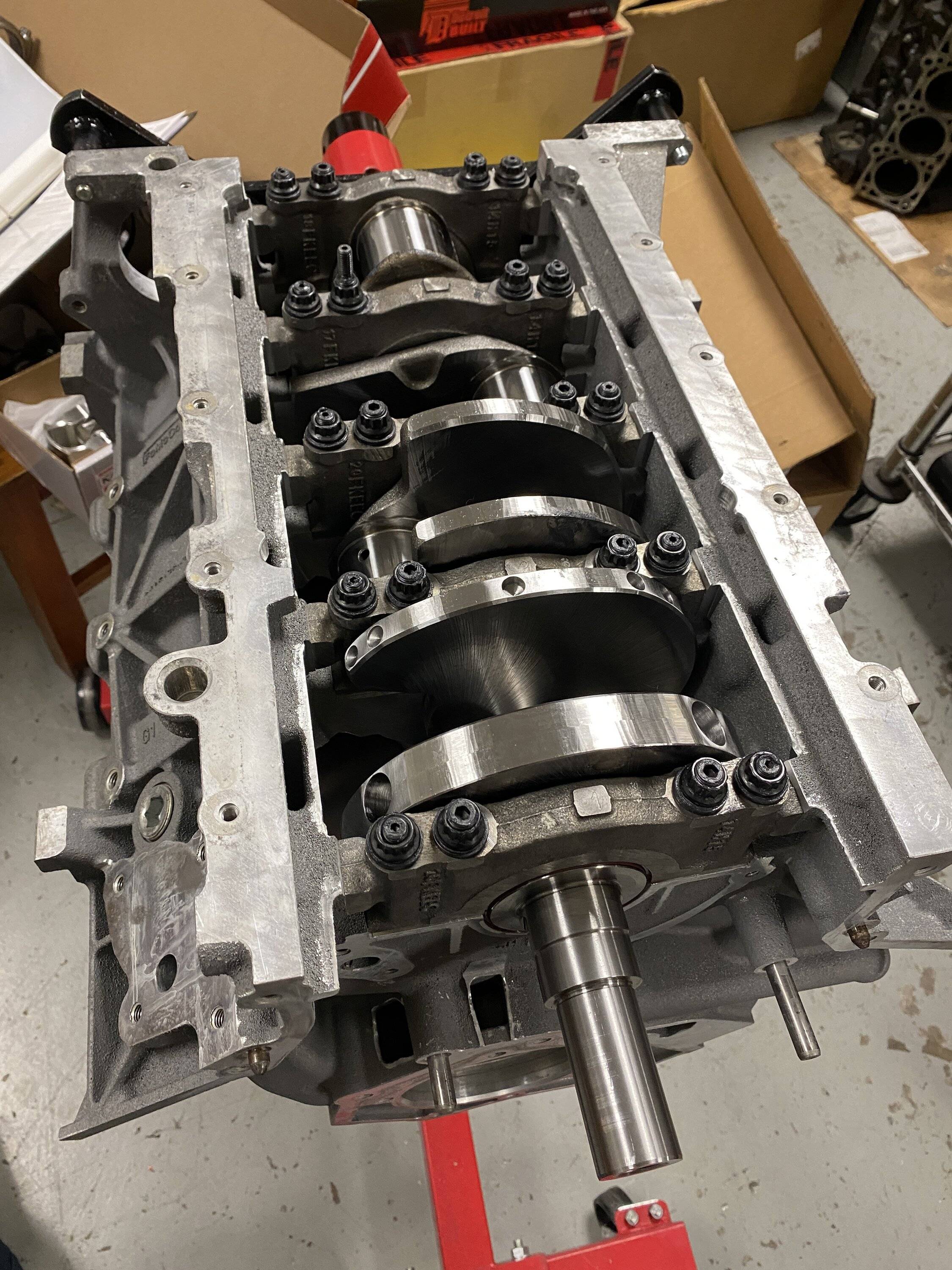

Crank in and main caps tight
shiny new short block. Heads should show up in January.

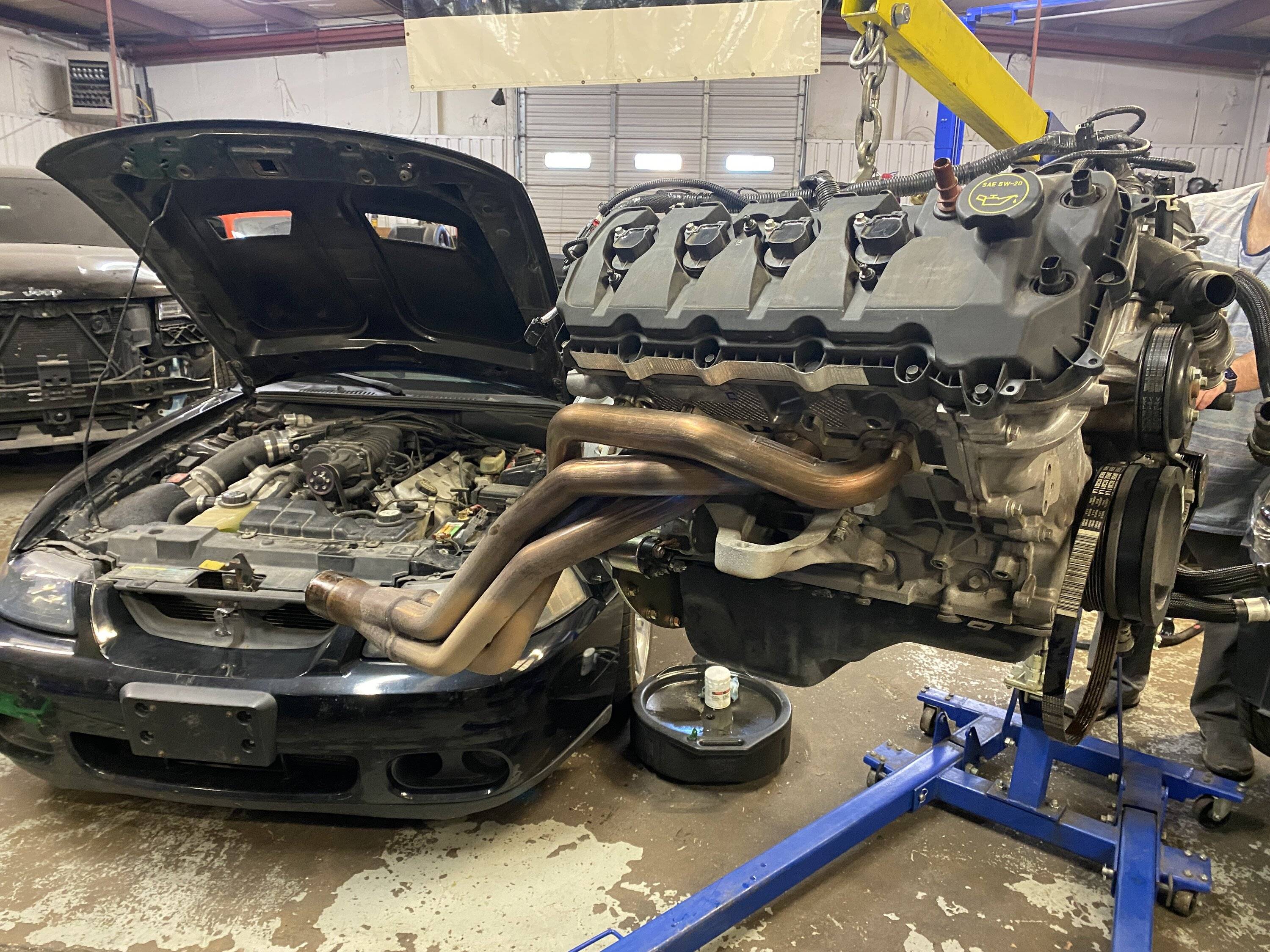

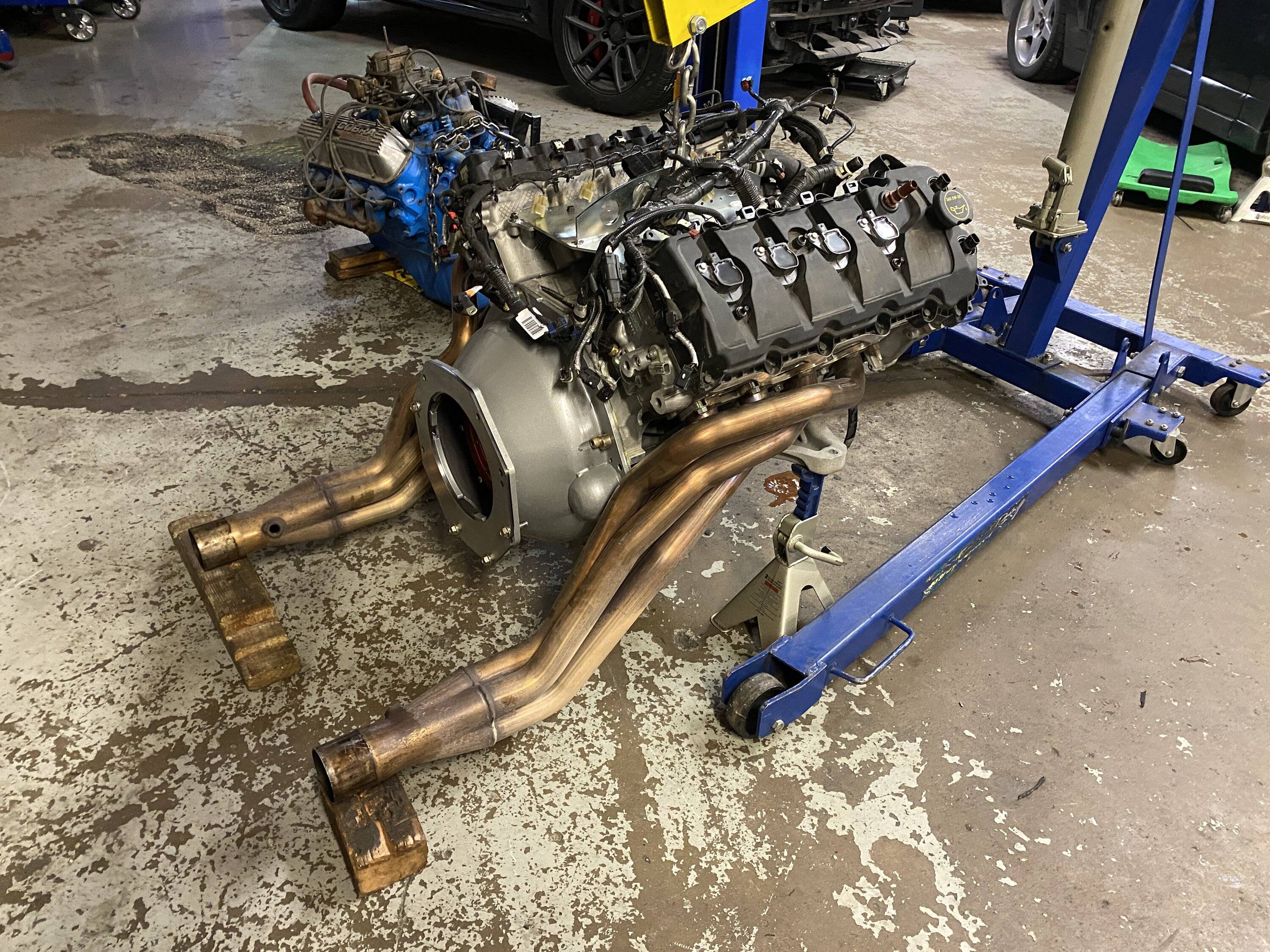

In the mean time I went ahead and pulled my old motor and sold that to recoup some funds.
I did keep my headers but went ahead and sent them off for Cerakote.

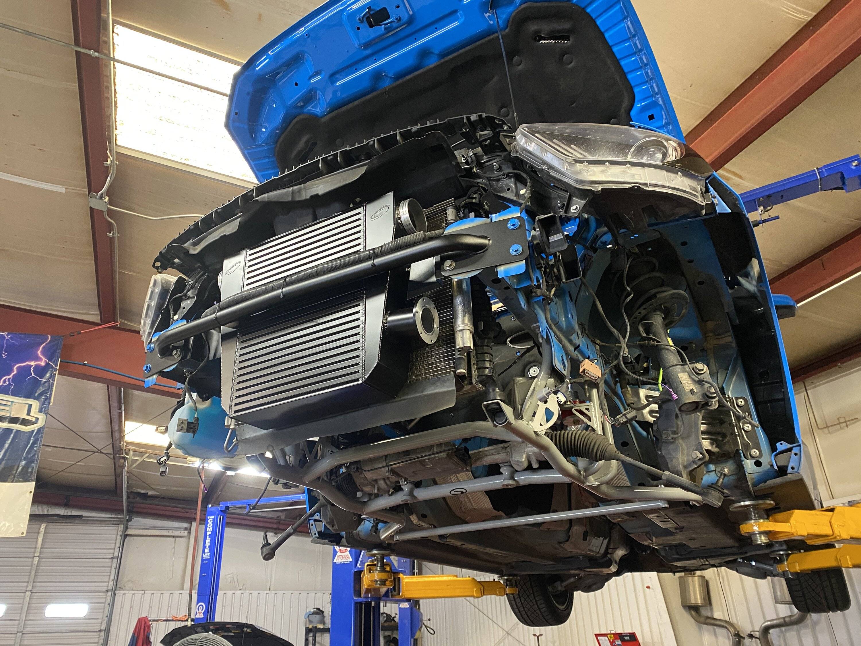

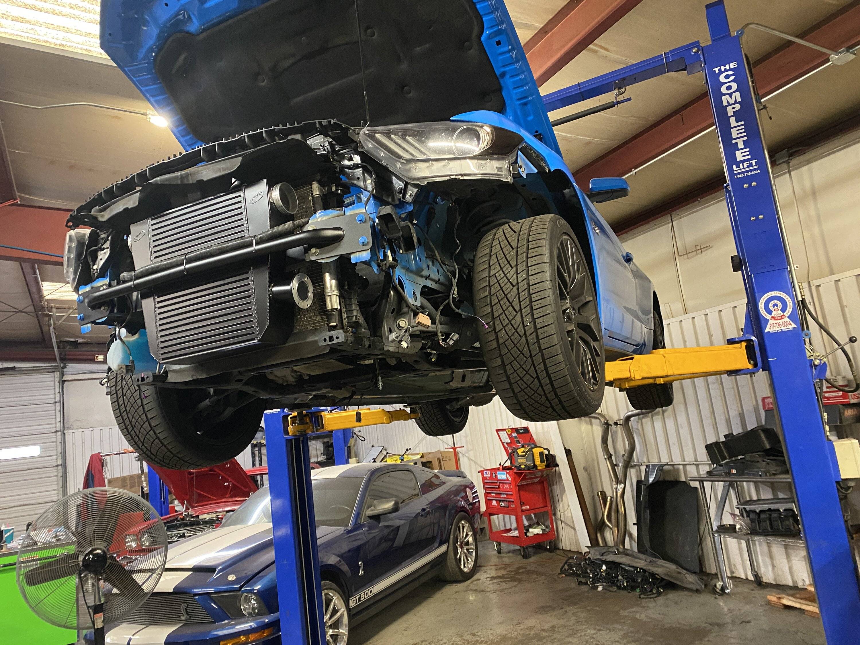

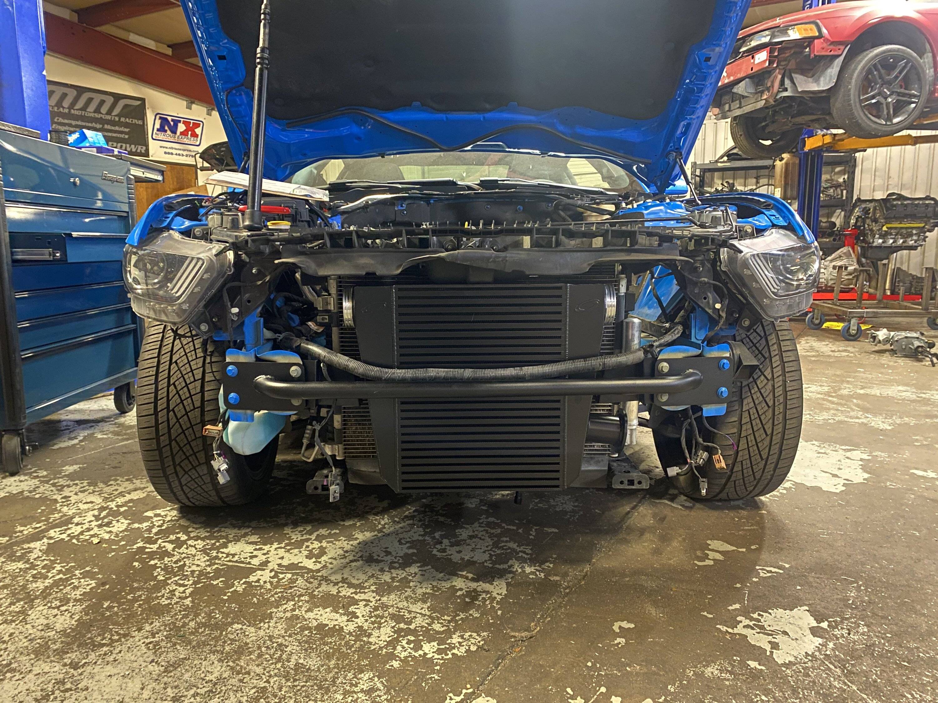

While the car was on the ground i went ahead and got the Procharger intercooler installed, along with a steeda front crash bar.

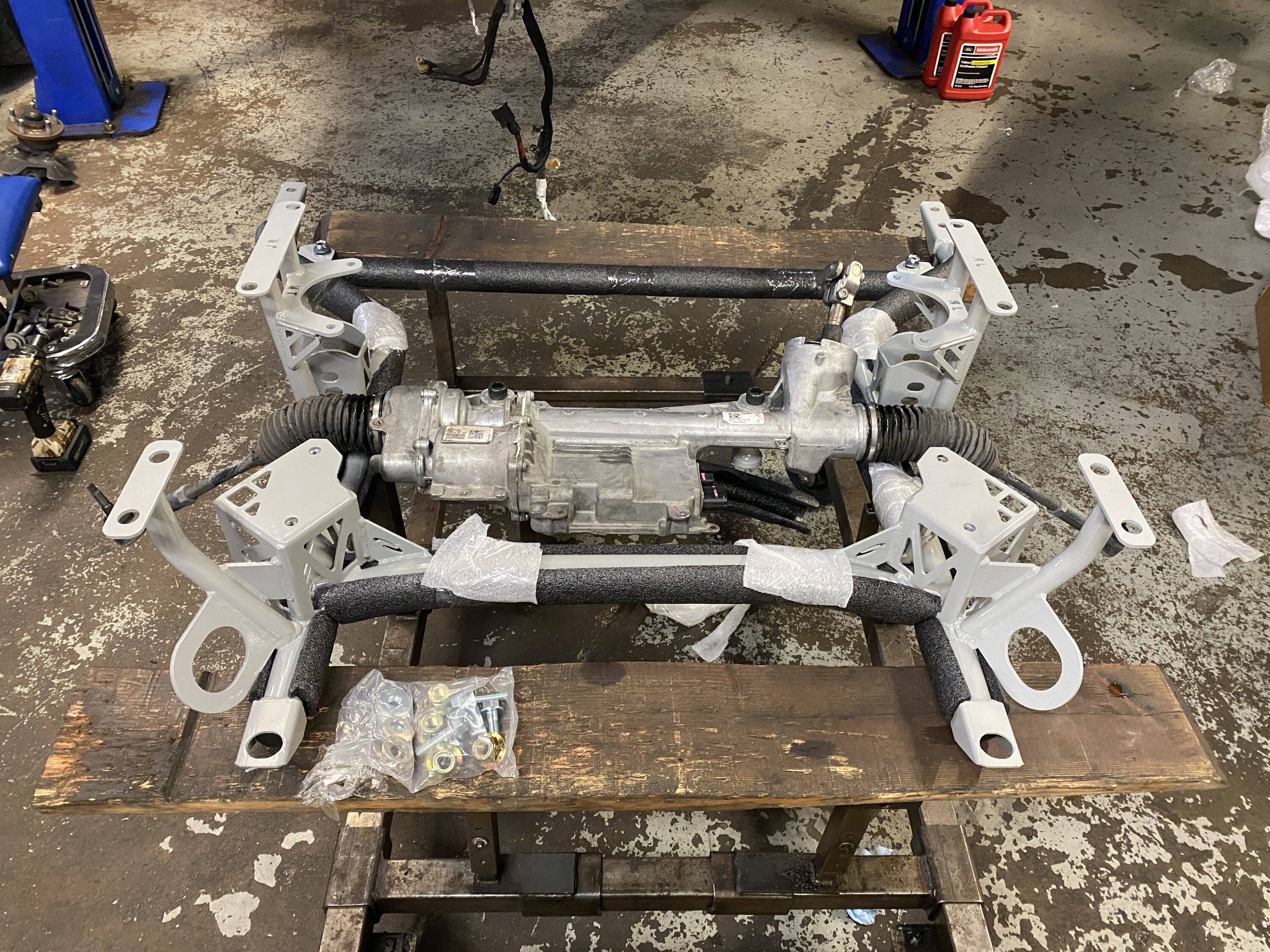

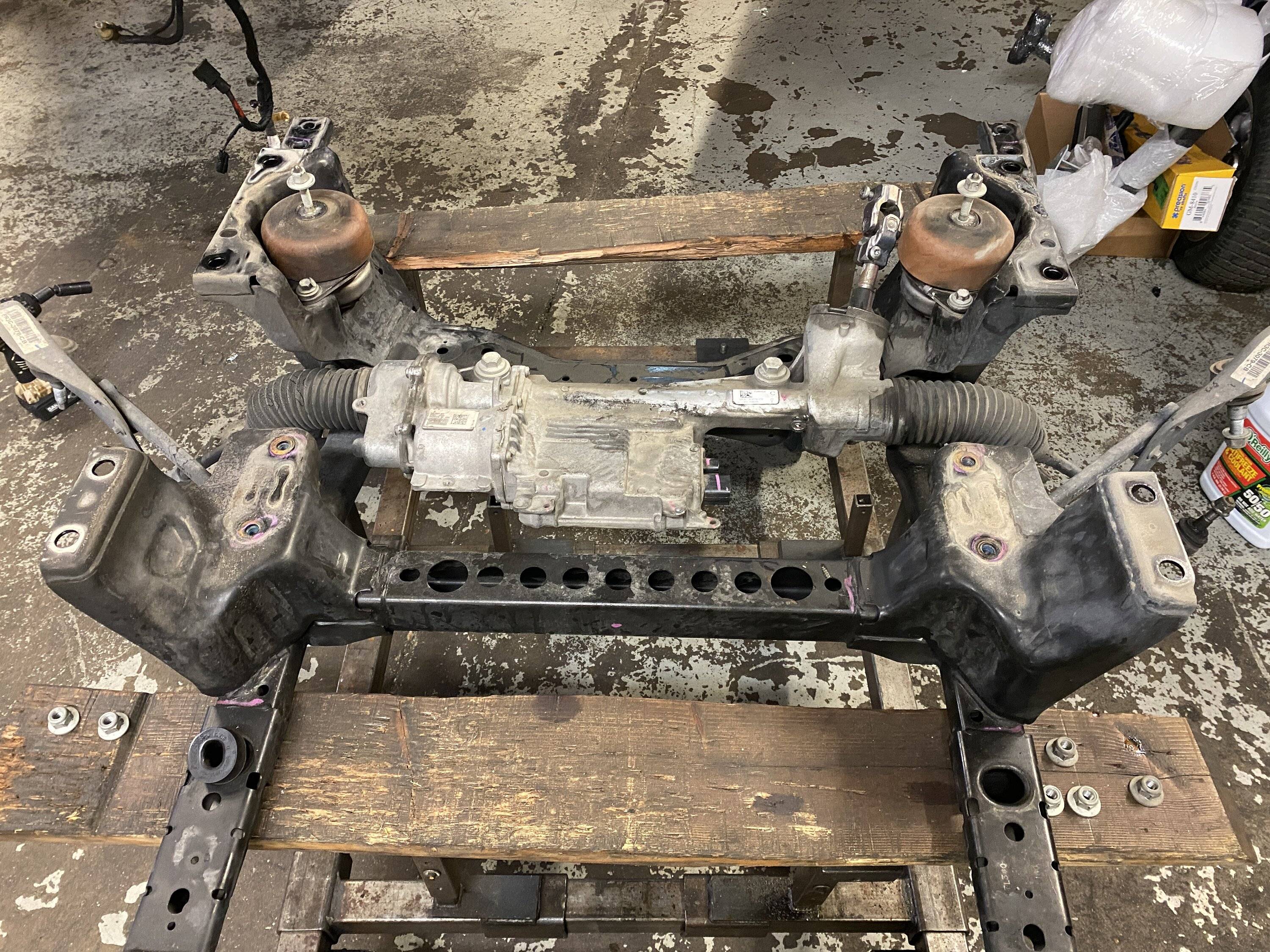

Got her up on a lift so I could drop the factory K member and replace it with a Steeda Road race K member.
Out with the old
In with the new
Looks nice, saves a little weight and if nothing else, gains you a lot more access the the factory K Member doesn’t have.

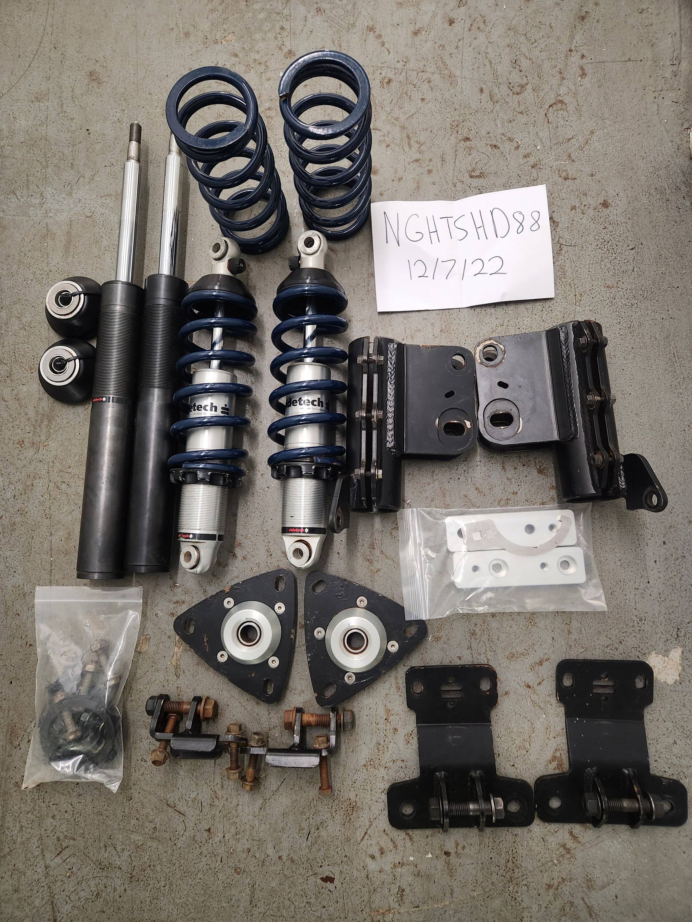

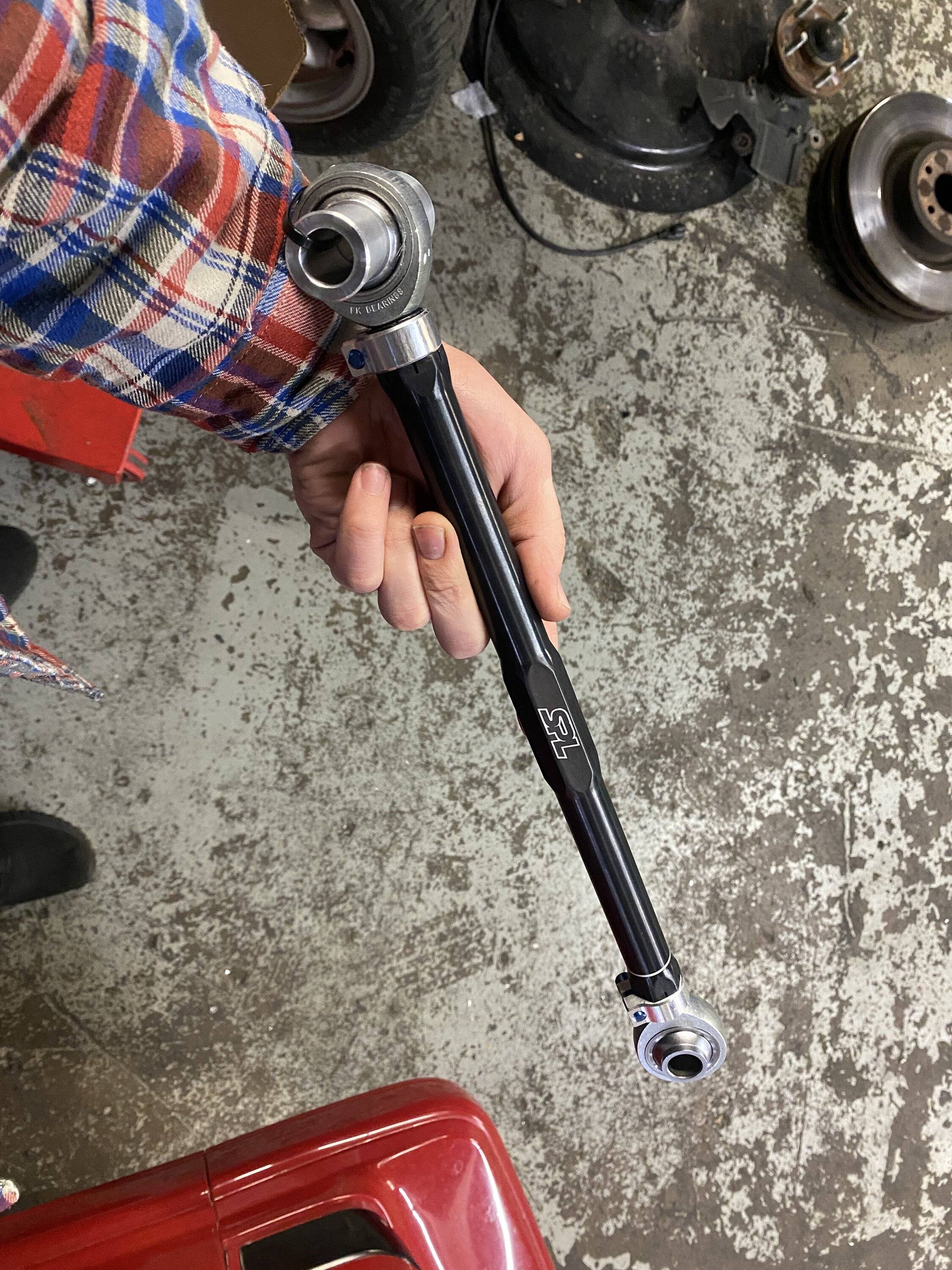

Early Christmas today. Picked up some RideTech coilovers from another member, they came packaged super nice, and were just gone through by RideTech.

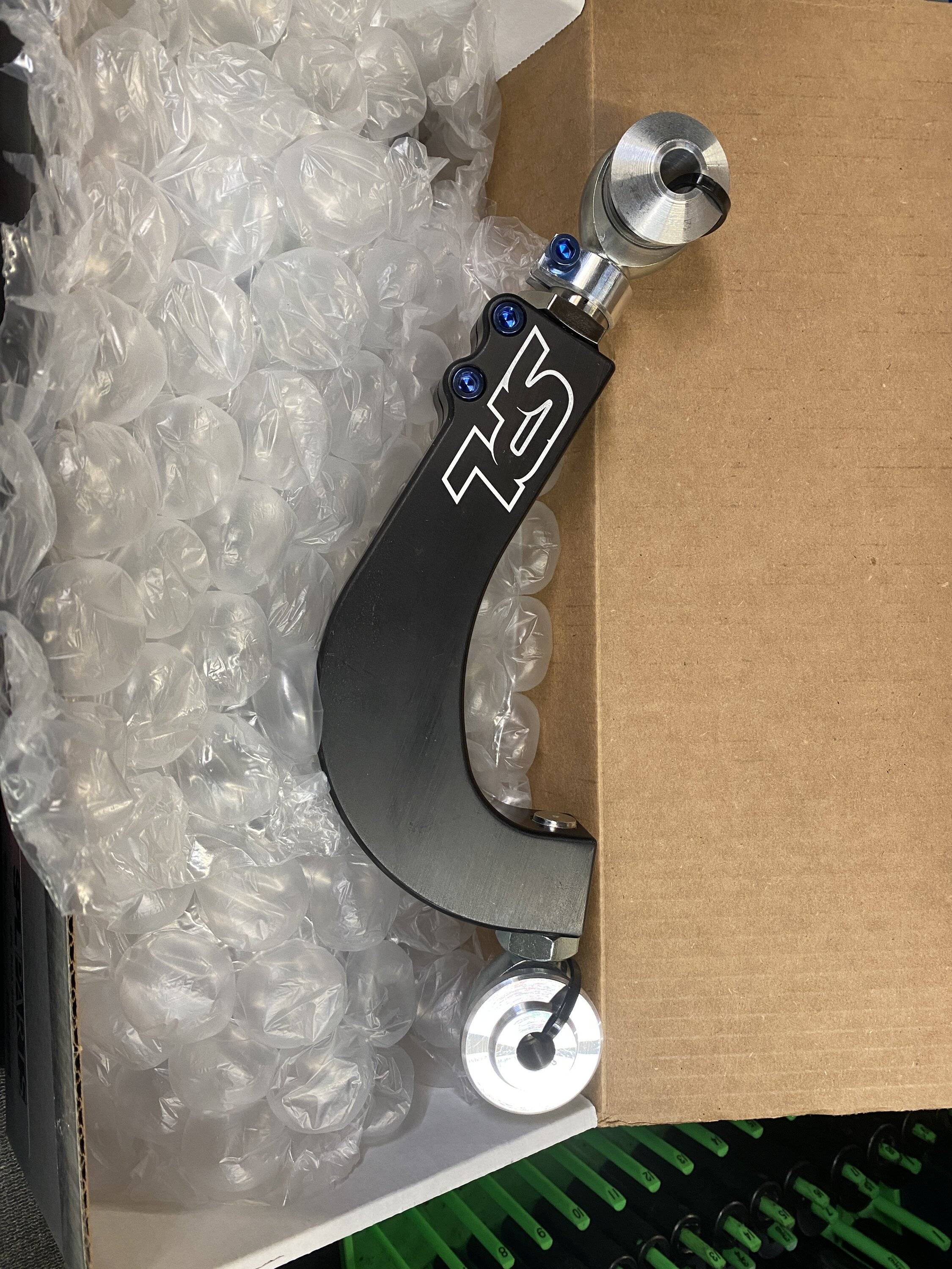

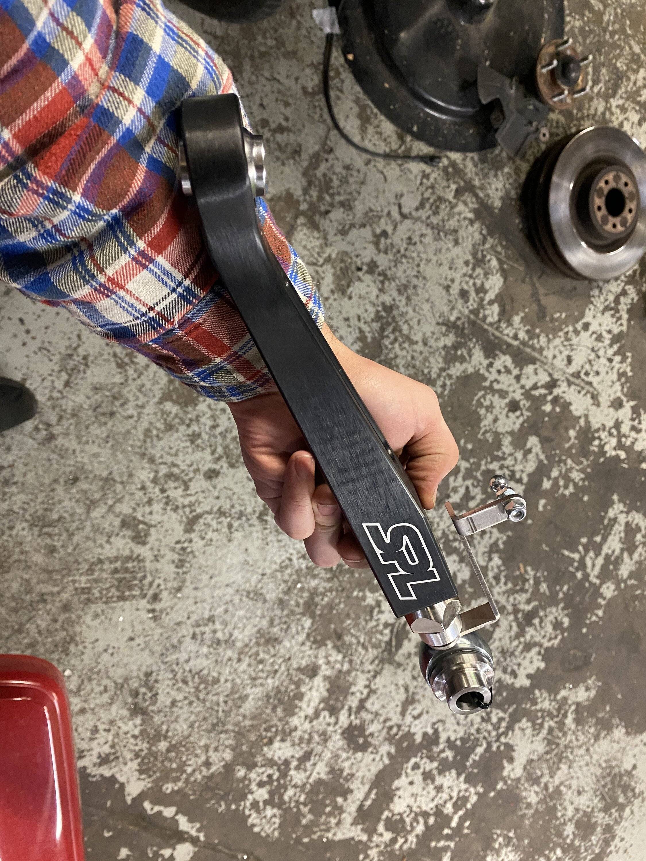

Also picked up some SPL parts front lower control arms, tension rods, tie rod ends, and rear camber arms. They seem to be top notch quality.
