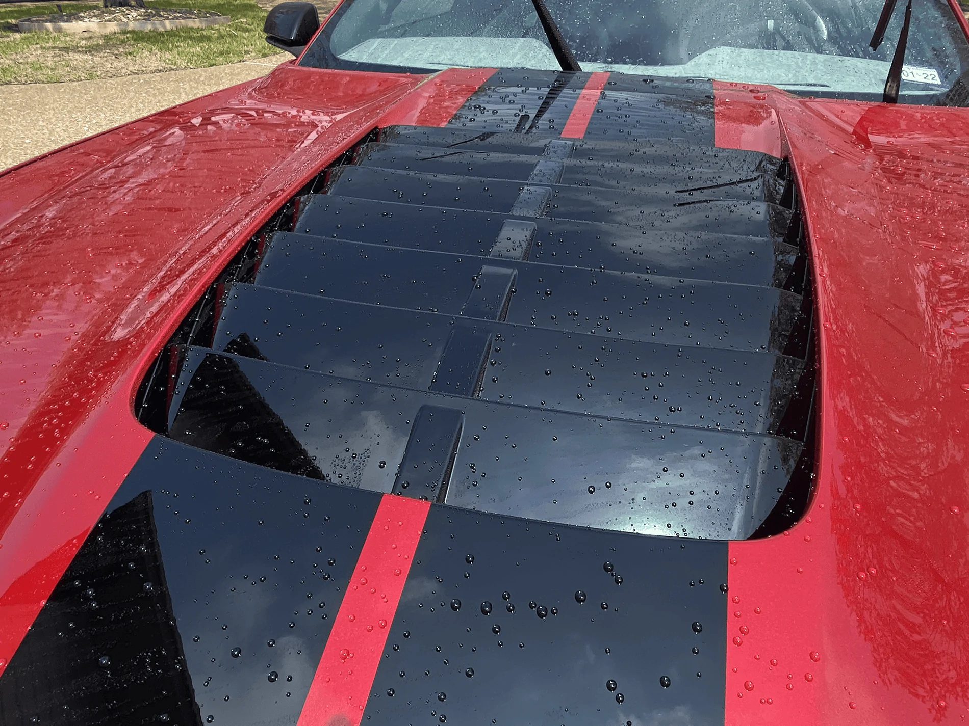

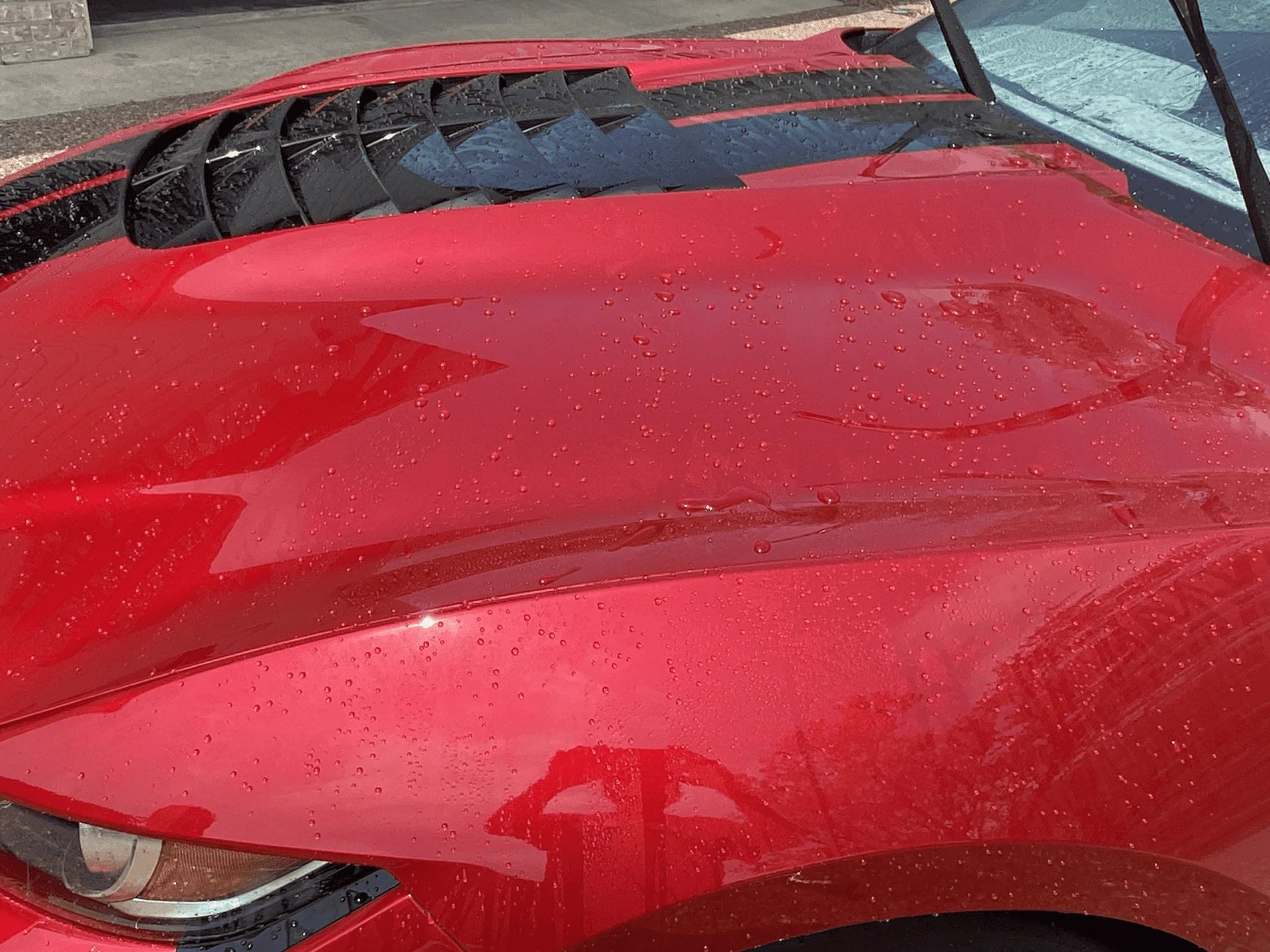

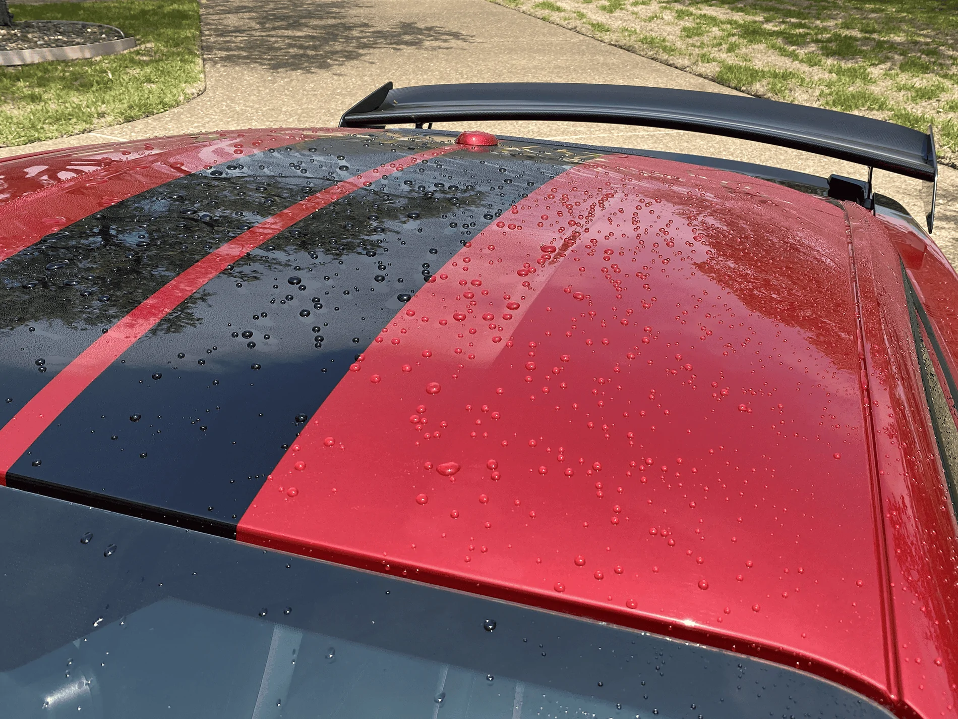

To close out this thread, I washed my girl today for the first time since the coating and here are a few snapshots of the hydrophobic"ness". <smile> Sure was easy to wash, wash mit just glided over the surface. Glided? That just doesn't SOUND correct. :-)

Looks great KB!!!

Looks awesome.
Awesome hydrophobic properties.
