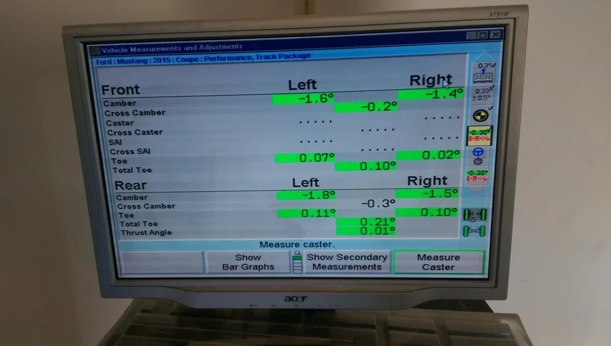

I've got the FRP shocks/struts with the Steeda Ultralights combo and was wondering what the best alignment specs were for a street car that won't see much if any track use other than an occasional drag strip pass.
I've seen different specs in different threads so I thought it might be helpful to see if a consensus could be reached on the settings. Thanks.

I have a ton of Steeda suspension parts on my car. They installed everything and did the alignment.
These are the final alignment specs that I have been driving around with since May 2015. Zero issues and handles great with no odd tire wear.
