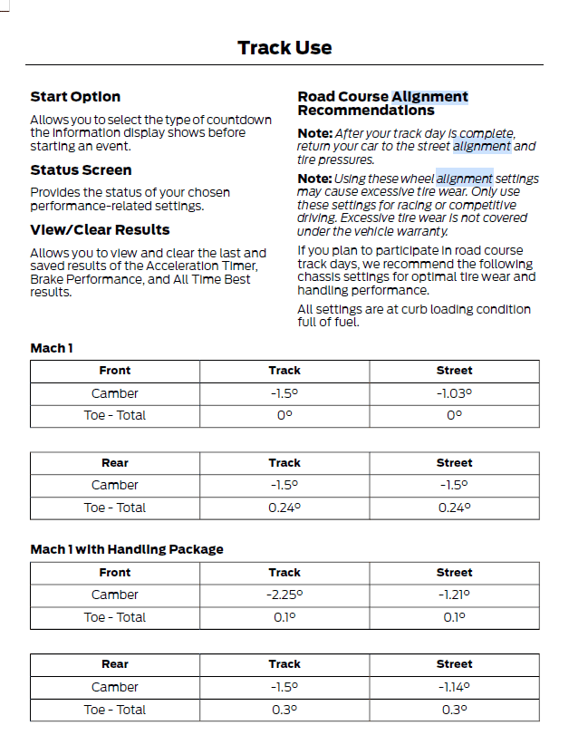

Can anyone give me the correct wheel alignment settings of the Mach1? I'm interested in driving on the road, not the track.

Owners manual gives you what you need, that smaller Mach 1 supplemental book is handy.

NP, this will get you going. Keep in mind, it is unfortunately all too common from all manufacturers, that cars may come out of the factory misaligned so don't be surprised if it is off.
