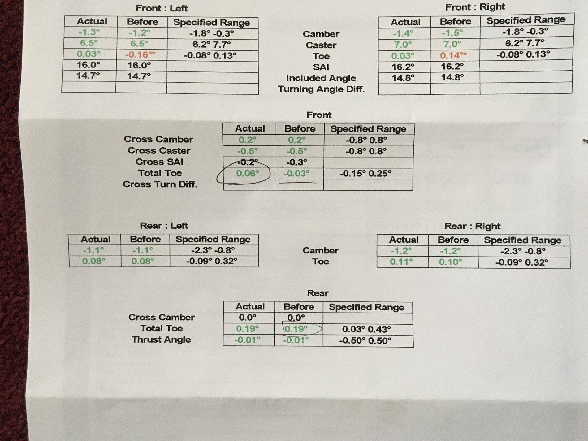

These are my alignment specs that virtually eliminated all tramlining and I still have the MPSS tires.
