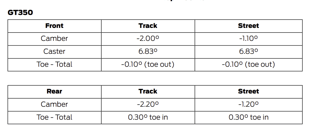

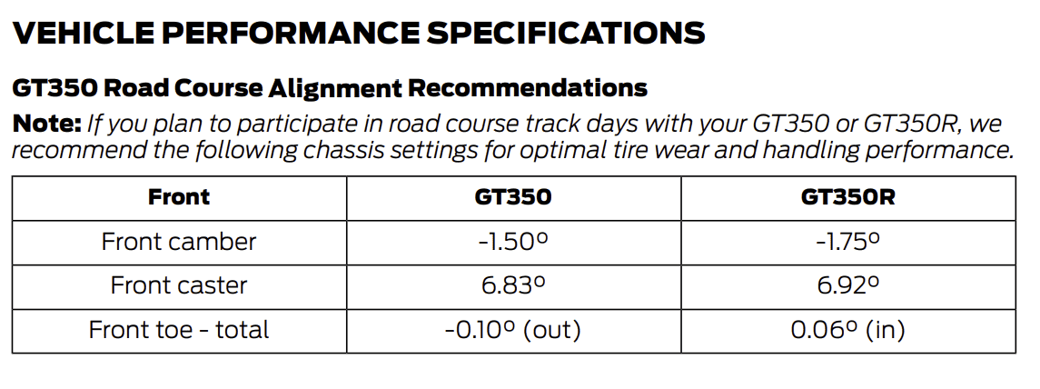

Anyone know why the recommended alignment specs in the GT350 supplement differs so much from year to year?
The 2018 specs have the lowest camber numbers. The 2019 front specs are the only one with positive toe. The 2020 specs are back to toe out but with the same camber as 2019.
Very confusing....
2018:
2019:
2020:

Well first, the 2018's had Super Sports as their OEM tire. Then in 2019 the OEM tires were changed to the SC2's. So that's the obvious reason for the difference from the 2018's. And just guessing here, by 2020, they tweaked the alignment settngs for what worked best for the SC2's.

A couple of thoughts on the issue. First, the more aggressive front camber settings came when the GT350 started having adjustable factory camber plates in 2019. Until then, front camber recommendations were limited to what you could squeeze out of the non-adjustable factory setup.
As for how much camber you need, I'm running GT350R springs, bars, dampers and VDM programming on my 2016 GT350 Track Pack with OEM 19x11 aluminum rear rims all around and the settings in the Owner's Supplement work pretty well for me. I've checked at multiple tracks with my Longacre needle type pyrometer and I've got even temps across the tire face. YMMV.

It's a bit of a hybrid. Front is -2.2 degrees negative camber, zero toe (the average of the 2019 R and the 2020 R front setup). Rear is -1.75 degrees camber, 0.3 degrees toe in. I couldn't quite get -1.60 degrees of camber as called for in the R specs for both years in the back so I settled for the FP350S rear camber setting instead.
