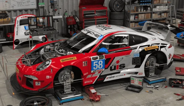

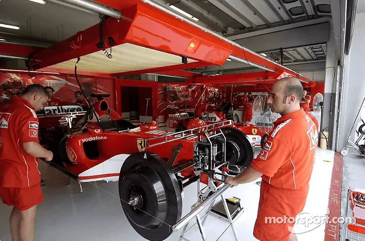

I'm using the Gen 4 pro kit with a few add-ons like the steering wheel holder etc. I've had it for a few years now and it's been excellent every time. I've done lots of string alignments as well, and I get similar results using this kit. My Mustang goes straight as an arrow, even over bumps. I can just let go of the wheel and it just goes straight.

I use the pvc method, a tape measure and ruler. I also use a trig apk on my android. that is for toe and for camber i use a digital meter off amazon for $20. Total cost $60 max. Worked really good i must say. I thought about the Gen 5 because it is slick, but really $950 for a few pieces of aluminum? rather spend it on parts for the car.
I know that is a lot of money, but if you look closely, all of the pieces are machined to be perfectly square. These aren't just pieces of extruded aluminum with holes drilled. I have the Gen 4 kit which was half that and it's been just fine.
