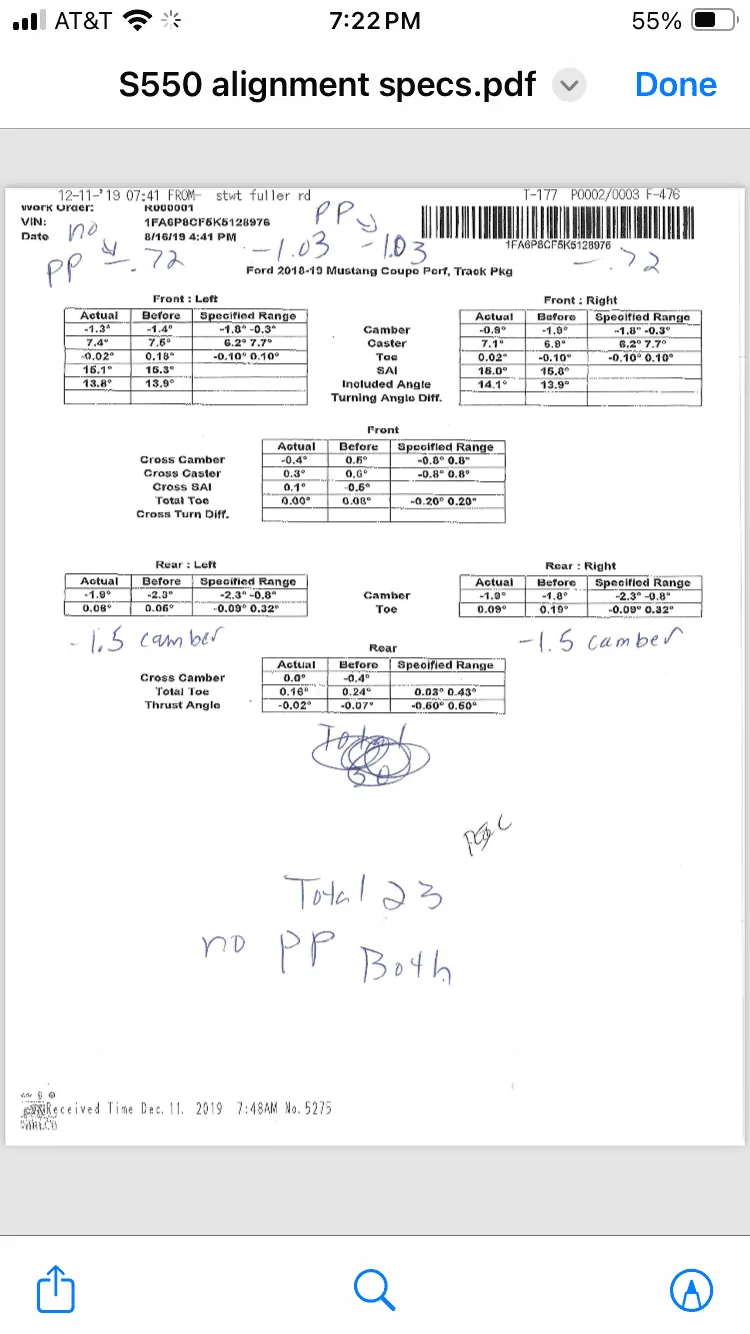

So Steeda send me this and I’m a little confused
I guess you will need to call them and ask for the Enigma Machine to decode that.
