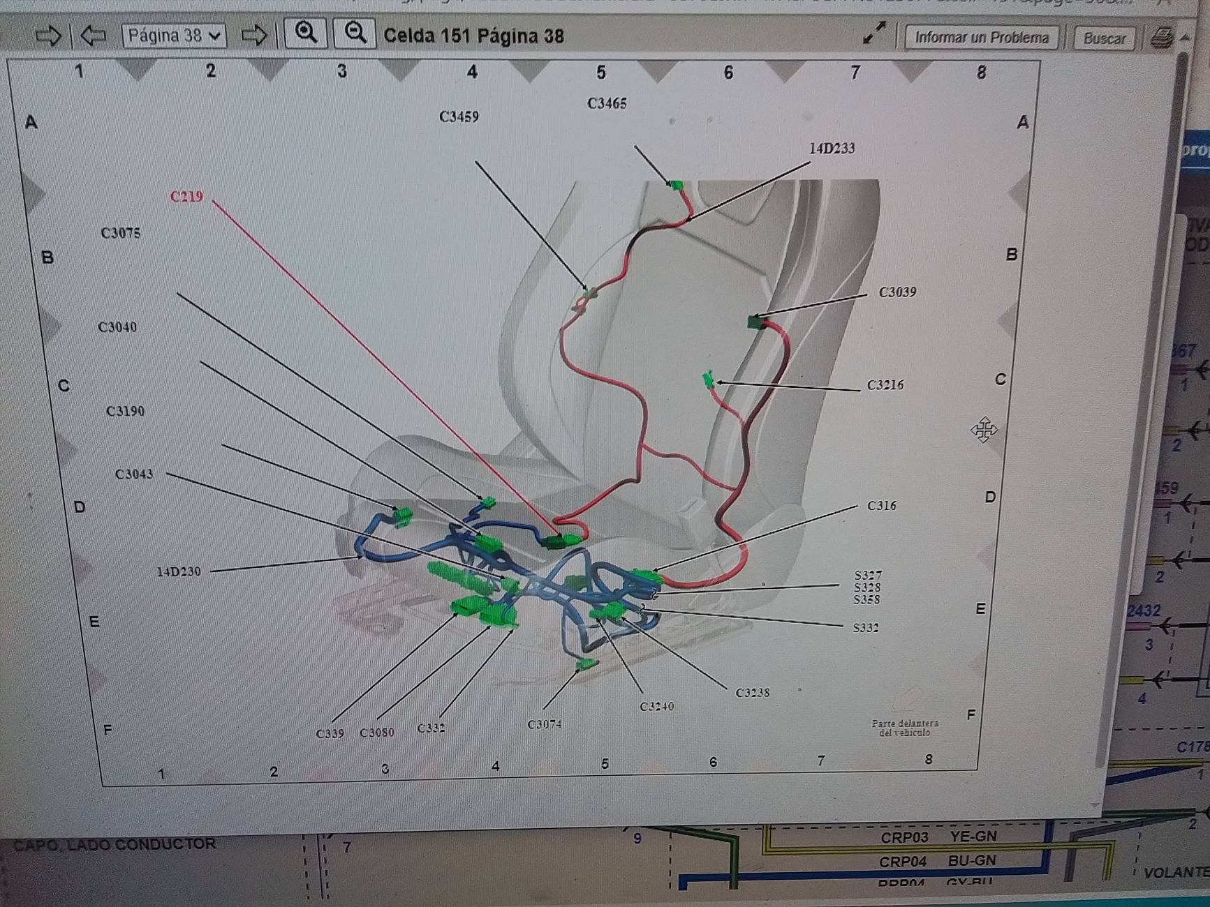

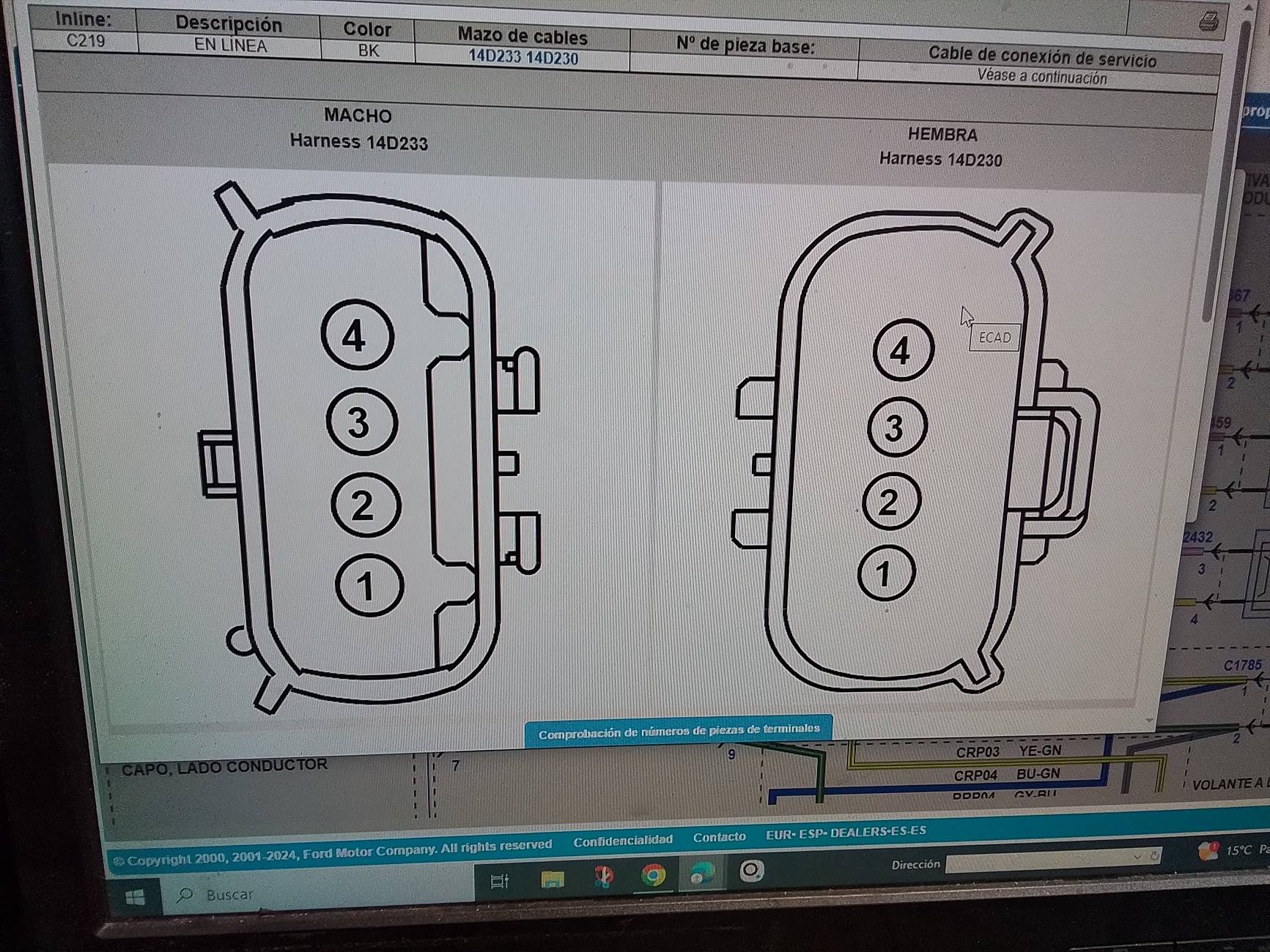

So this error has been constantly on the last weeks. Yesterday I did a deep cleaning, moved the chairs all around so I can pass with the vacuum cleaner. Guess what, the air airbag light is gone for now... 🙄

Sounds like a connection issue around the seats? There are a lot of sensors in the front seats which if fault can throw up a light.
Yeah, definitely suspicious for me. What's weird is that the error code is specifically for the hood latch deployment, which should not be related to the seat connectors.

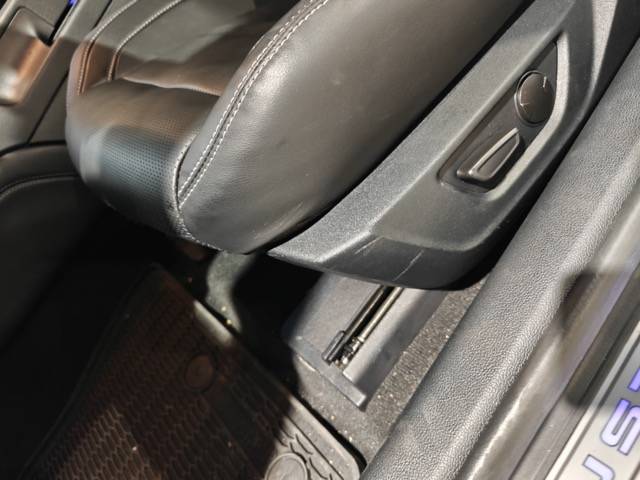

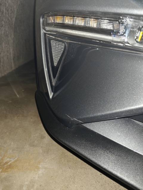

As expected, the more often I went to the dealer, the more chance there was to damage my car and indeed it eventually happened. After the cable checking, I came home with a paint scratch on the front:
Unfortunately this was a few days after Christmas, I didn't even check the car for damages and noticed it only a week later when the shop was closed for vacations. Since I reported the damage many days later, they didn't rush to offer any compensation or fix as I could have been the one scratching it. (Which wasn't the case with the car parked all week but ofc I can't prove it, it's "my mistake" for not noticing it.) I told them to check their security footage, they said it's too low quality to see if there was a scratch before I arrived or not.
So finally I took the car for the last appointment, to replace the RCM, they did it in less than a day. I picked up the car again (this time checking the paint :D) and guess what: there was no seat belt installed in the driver's seat! They couldn't even believe it at first, I had to call the mechanic to try to click the seatbelt: there was nowhere to click it, the red socket part, from the right side of the driver's seat was completely missing. Thank God I found it there before leaving the shop.
They took back the car, "just 5 minutes and will be fixed" and after half an hour I got back my car. Again, no new paint scratches :D, but this time they scratched my driver's seat:

I noticed this and made them take photos, the manager of the shop was busy so he couldn't come but they promised to follow up with me and fix it the next time I'll be there. Ofc they never followed up ever since then, but I'll make sure to remind them when I go for an oil change in 2 months.
So that's my story, the car is permanently fixed, my soul (and my paint) is permanently scratched, it is the first ever damage on this car, until this point, for the last 2.5 years it has been absolutely spotless and scratchless. I won't get this fixed because this tiny scratch would cost 200-250 euros at least, because they have to match the paint on the entire front piece to make sure it doesn't look crappy. I can and I will live with it and if (hopefully never) I will get more scratches in the front, I'll get them fixed all together in the future. When it's dusty or there isn't strong sunlight, the scratch is almost impossible to notice unless you're looking for it...

If I recall correctly, the seat has to come out to replace that trim …
The seats are heavy and a little awkward to manoeuvre out of the door (especially the Recaro due to the built in headrest).
Personally, I would ask for the trim and swap it yourself (I’ve done that exact job with the seat plastic and the base cover).

Glad your car is finally fixed. Unfortunate your car got damaged at the the dealership, that really annoys me. It seems.to be a common thing that the people working on our cars don't give a shit. Unfortunately it's my experience here in Australia too, must be a requirement to get a job at a dealership.

Try wetting the scratch on the paintwork - if it is not visible when wet it will polish out.
