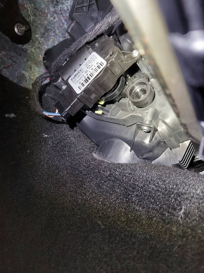

The blend door actuators are what they were talking about I think. It’s up under the dash. They are small electric stepper motors or vacuum actuators. I’ve never had an S550 dash apart, so I’m not sure where they are exactly. Try this thread. https://www.mustang6g.com/forums/th...re-all-three-blend-door-actuators-are.113633/
You could still have an electronic issue. It would be really helpful to get a look at the climate control PIDs to get a better idea whats going on.
Saw a youtube vid....looks like it's a little pack near the gas pedal right where the plastic ends. I'll take a look at it when I get a chance but I'm not sure how to manually test it or how to tell if it's functioning.
I'll take a look at the link you shared in a bit.
Thanks

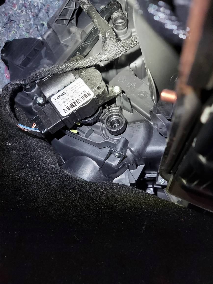

Took a pic of the blend module....not sure if anything can be seen (timing/etc.) looking at it but here it is....
If nothing can be seen, thoughts on how to test it? Right now, this is the ONLY thing I can think of that may be stuck/broke. Nothing else makes sense.
Thanks!

Another update....
I looked at and tested the actuator (drivers).... also called the tech. He said those actuators are for the blower and interior/exterior air NOT the cold. He said the cold air actuator is on the box and I need to remove the dash to get to it. He also said the over charging of the refrigerant line is a concern because it may indicate a problem with the....
