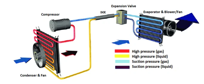

There's 3 things that I know of that should cause a properly working AC system to cycle off:
1. If the cabin evaporator reaches 37F. This prevents the cabin evaporator from freezing over .
2. If the cabin temperature setting is met. The AC will cycle off to maintain your chosen temperature.
3. If the static AC system pressure is less than 40psi. This will not allow the AC system to cycle on.
Sitting for a half hour after a long drive probably got the engine bay super hot which would boost AC system pressure.

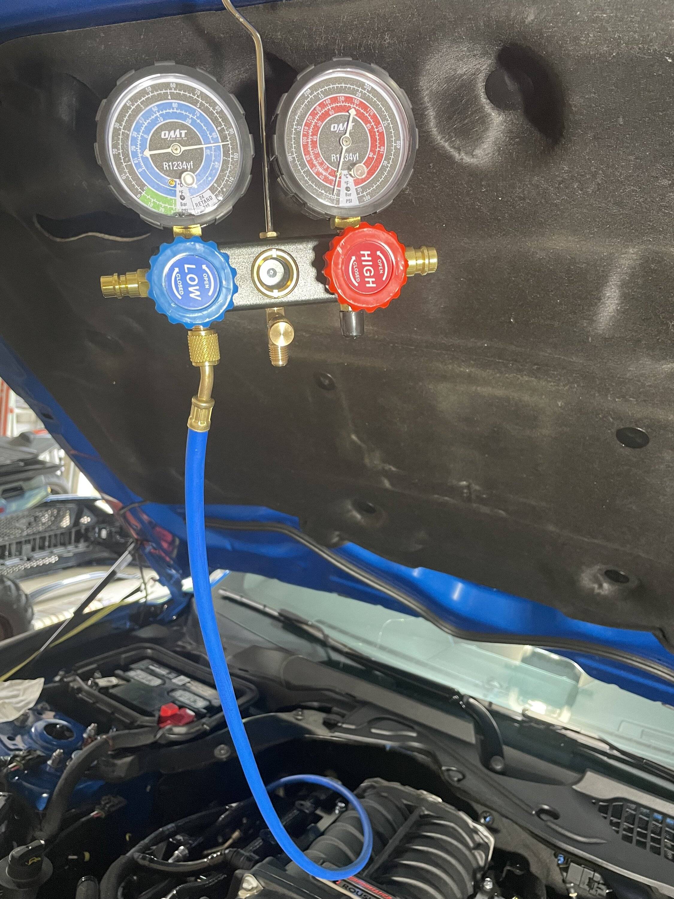

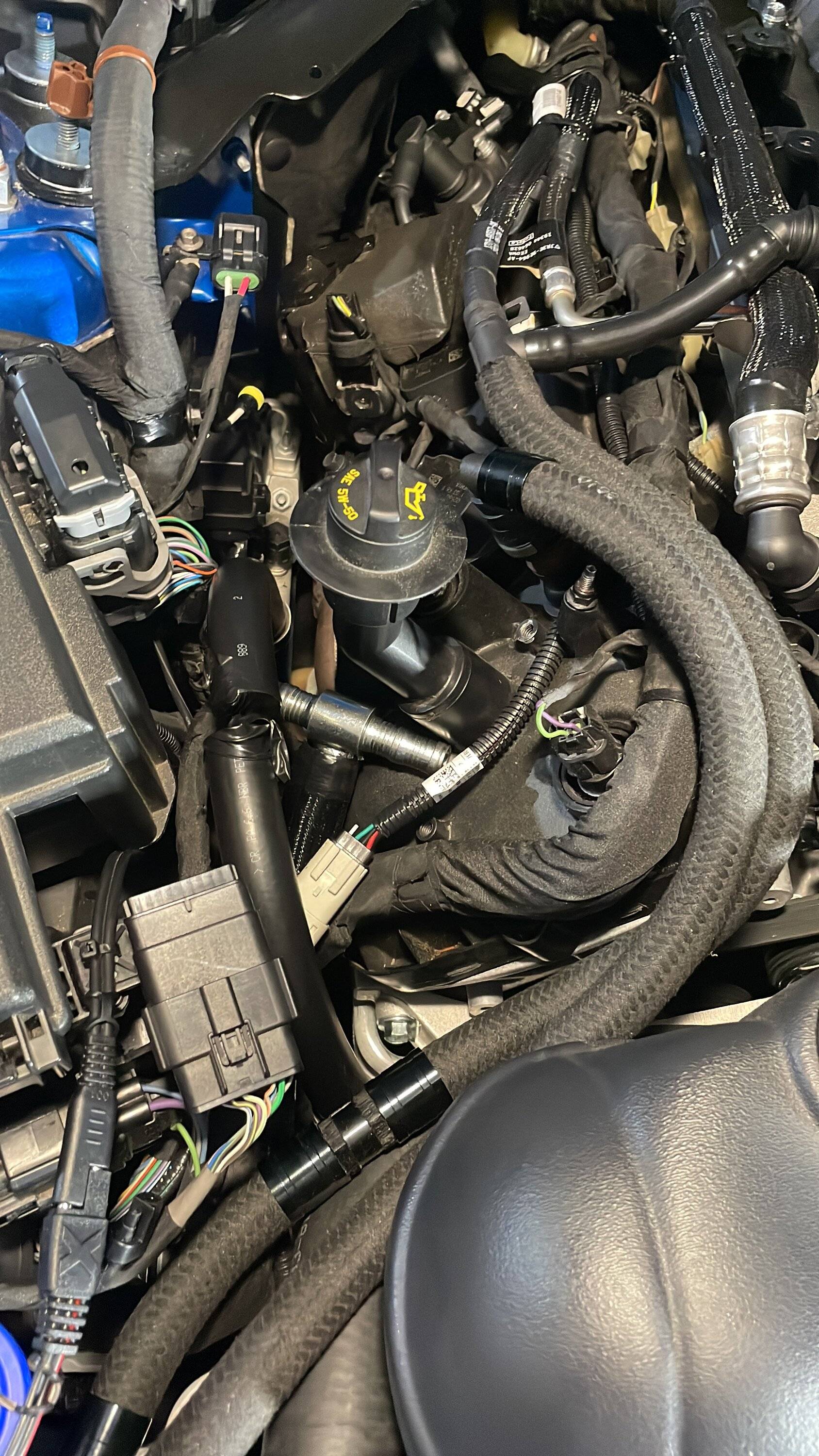

No problem. Just did some AC work so it's fresh in my head. The suction line that should be getting cold is the hose I have cut by the fuse box in the pic below.
If the system is still cooling, move on to flow as @sk47 has recommended.
If you find it's not, you can check the pressure by connected a gauge to the low side. The pressure between the high and low side will equalize once the engine cools. The gauge should be purged of air before opening the valve to avoid introducing moisture to the AC system. My factory charge was 95 psi on a 92F humid day. The 2020 mustang is R1234yf refrigerant. I envy you if the 2017 R134a. Good luck!
