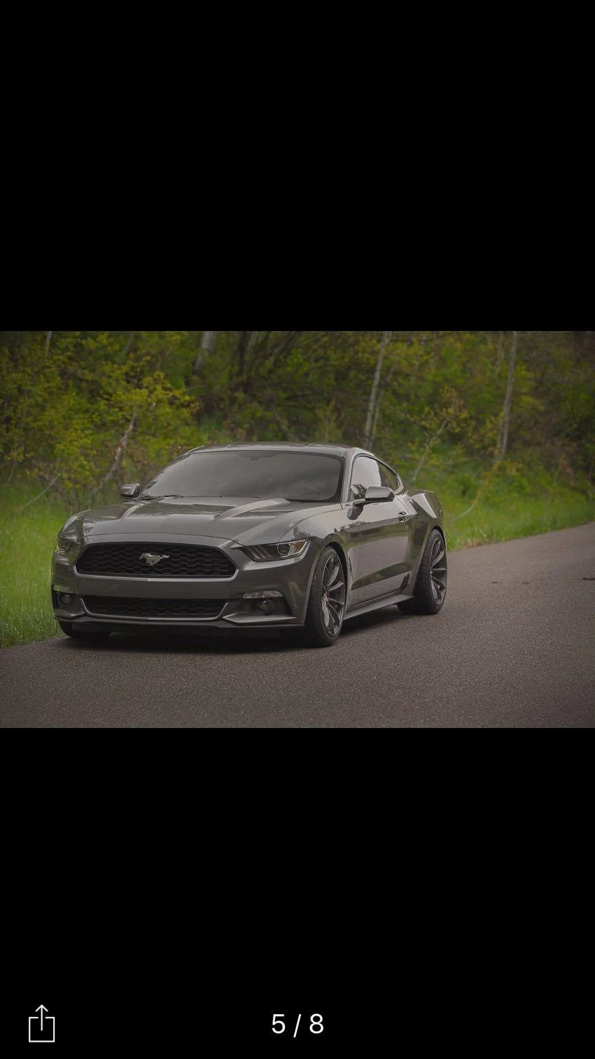

This is pretty aggressive. Does anybody know whose this is or what those rims are? (I don't remember, I may have screenshotted that from here for ideas on my own car)
SheStang
Apr 9, 2015
331
188
AL
'16 GT Oxford White
I think they are Rays gram lights, believe the rear is 19x10.5 +35 with 285/35/19.
