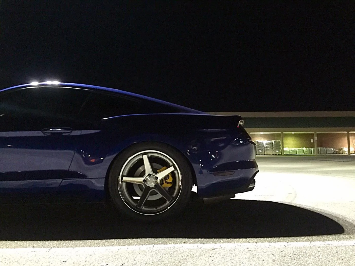

Ferrada FR3 Wheels 10.5 Square ET38
275/35r20 front
315/35/r20 rear
Has anyone attempted pulling fenders or something of the sort in the rear? Having some unwanted scrubbing issues and running more camber then I wish too
P.S. Sorry not the best pics, car is filthy and Im not a good photographer. Iphone pics for the win

Oh yes thats sexy right there.
Pulling fenders currently no sir. But running a tad more camber will resolve the issue.

Thanks man. Yeah I mean how much rear camber you think? I read that -2.0 is max on stock hardware. And PM me some pics :cheers:
BigEasyGT
Aug 10, 2013
530
99
New Orleans
2015 GT PP
I think the -2.0 is on stock suspension because I'm on sportlines and my alignment sheet shows -2.7 for my rear right wheel IIRC. Rear left is -2.5

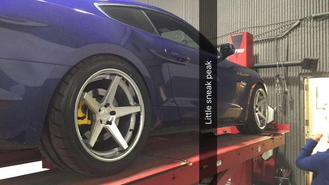

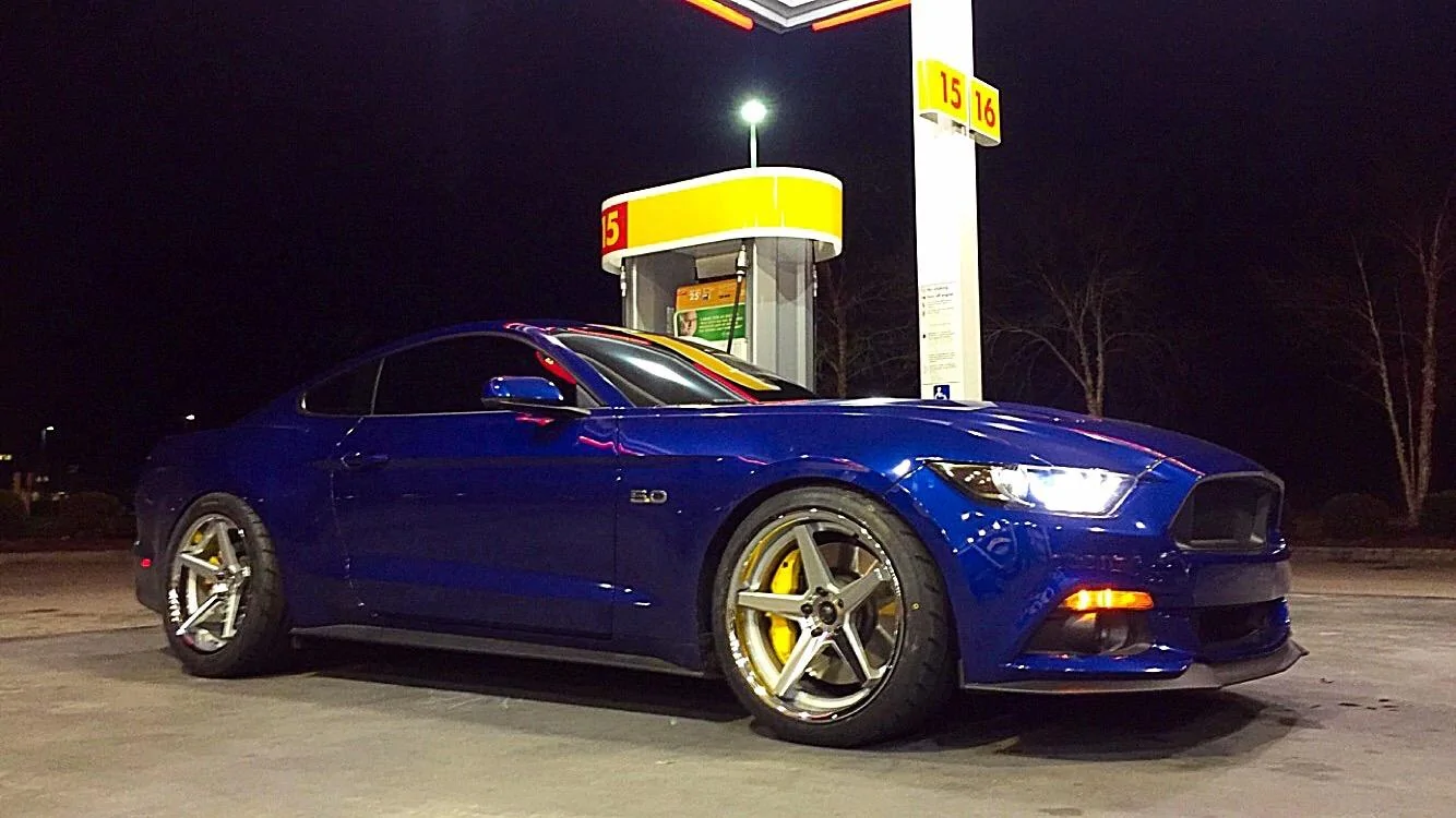

Little more eye candy for yah
