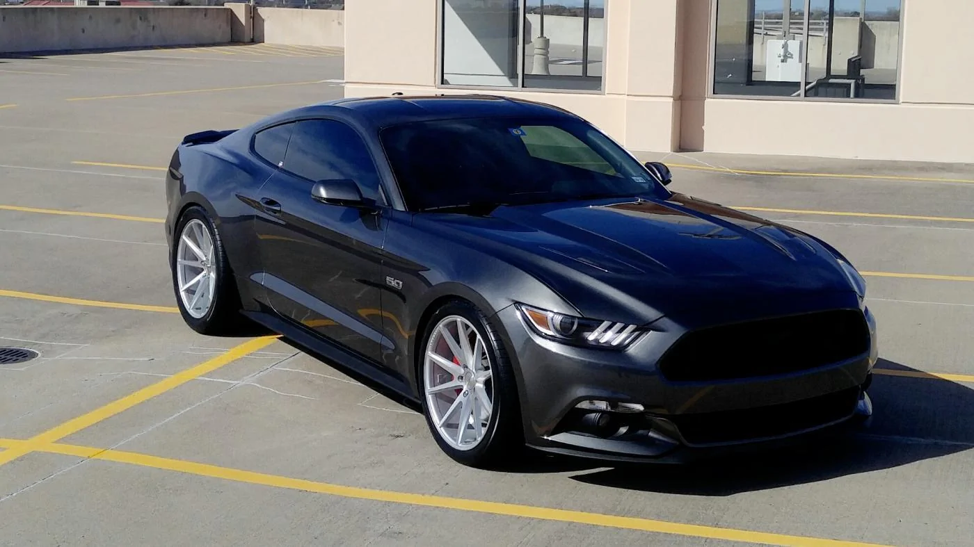

Rovos Durban 20x10 et.+38 all around with a 3mm spacer up front to clear Performance Pack brakes.
255/35 tire all around
BC Racing coil overs lowered about 3.5 inches all around.

Once I get adjustable control arms I can make the rear fitment a little more aggressive looking by adjusting the camber.
Rovos Wheels by Zachary Pounds, on Flickr
Garage Light Painting by Zachary Pounds, on Flickr
These wheels won't clear pp brakes without spacers?

No it needs the 3 mm spacer to clear properly

Let me clarify this. 20x10 will not clear the front without a 3mm spacer on a car with the Performance Pack brakes. I have 20x10's in the front and rear of the car. If you get 20x8.5's they will clear the front without a spacer as far as I know.

Well. If your running 20x10 +38 and the 3mm spacer that. would make it et35. So then if you ran 20x10 +35 then you'd be ok? I was lookin at 20x10 et35 but I think I'm gonna run 20x9.5 et28 instead. And a 20x11 et39 rear.

that's not how it works. it all depends on the wheels spoke design. if its deep dish it doesn't matter, and you will have to add a spacer

Every wheel is different because of the following
Vehicle caliper sizing
X factor ( distance of space between back of the wheel to the caliper ) based on the wheel
The Wheel itself
So one fitment may work in a certain setup that the other wheel will not in the same specs.

meh.. it is nice but not aggressive by the definition of this thread.
The only way a car will be aggressive in this thread is if it has one or more of the following:
- offsets of the wheel that push the limits of fitment on the car. ie: sticking past the fender or needs camber to fit.
- tires so close to the fender that it goes beyond the standard realm of fitment
- lowered so much that even normal tire and wheel specs become so tight that you can't fit a finger through the gap.
