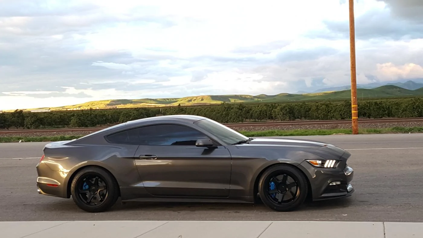

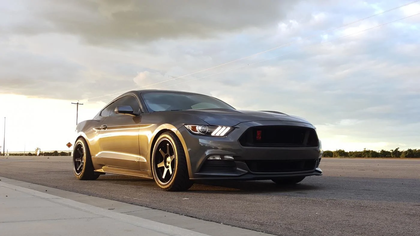

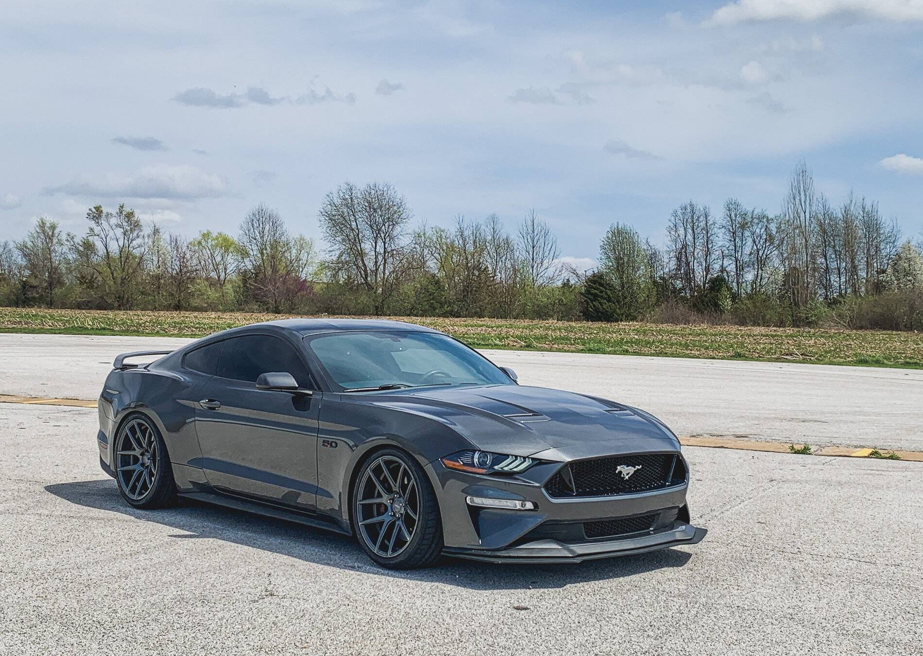

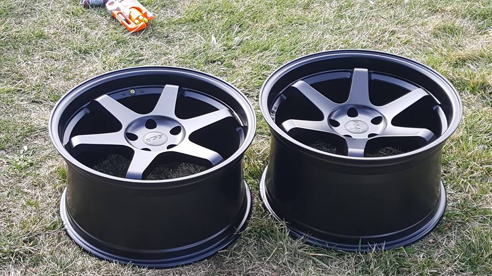

Finally got everything installed and dialed in.
20x10.5 +45 Square Velgen VMB5 w/ 16mm spacer up front (yes you read that correctly)
ARP Front Wheel Studs
295/30/20 Bridgestone Potenza
Fortune Auto Coilovers
Max Rips
Yesss! It's like I am looking at my car but with other wheels. lol Was such a thick spacer necessary to clear the coilovers? Wouldn't 10mm clear? What's the camber on the front? What about a taller tire - would that clear the coilovers? I wish you did some photos from the inside to see these tight clearances.
another important question is the ride quality.

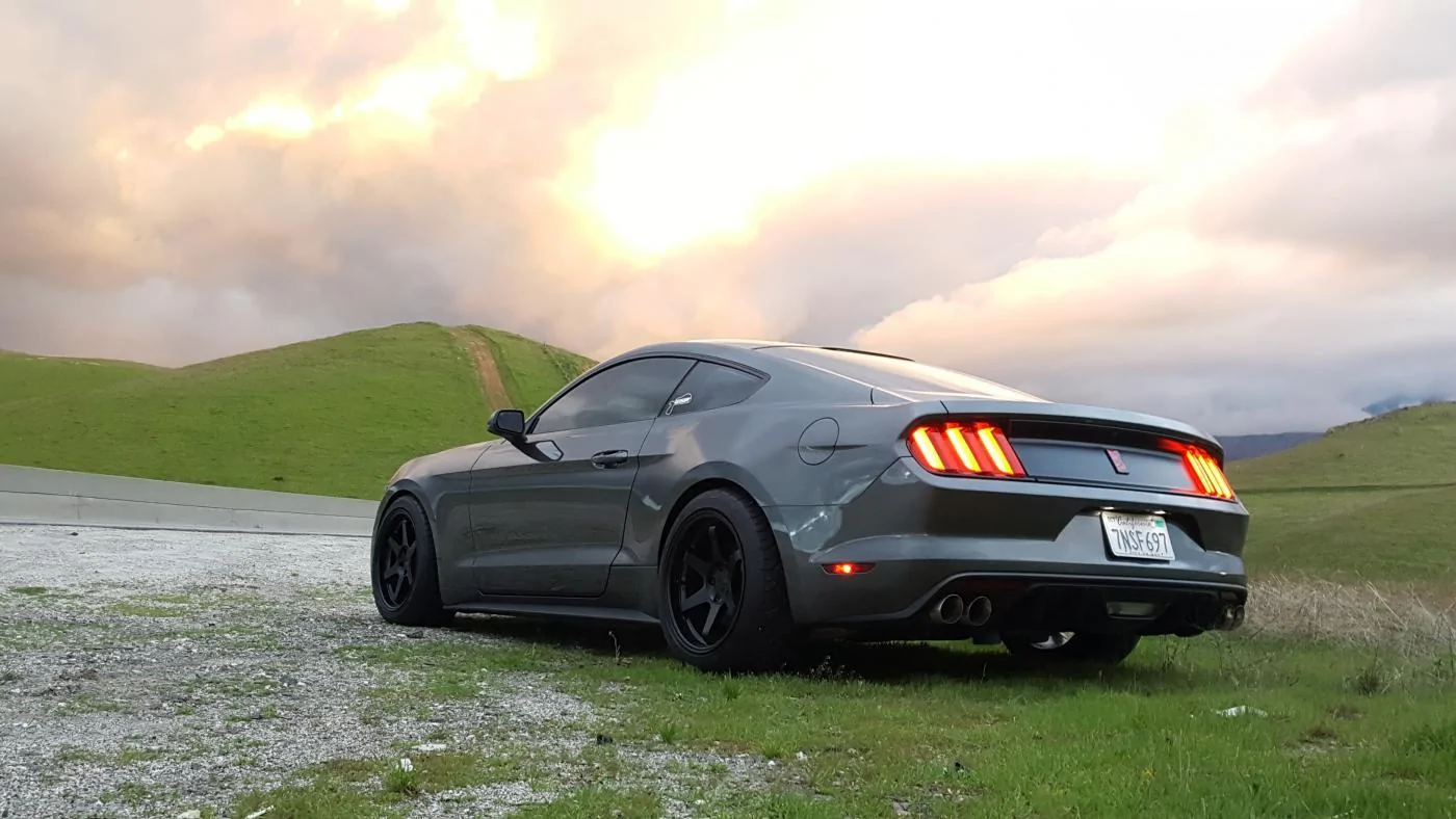

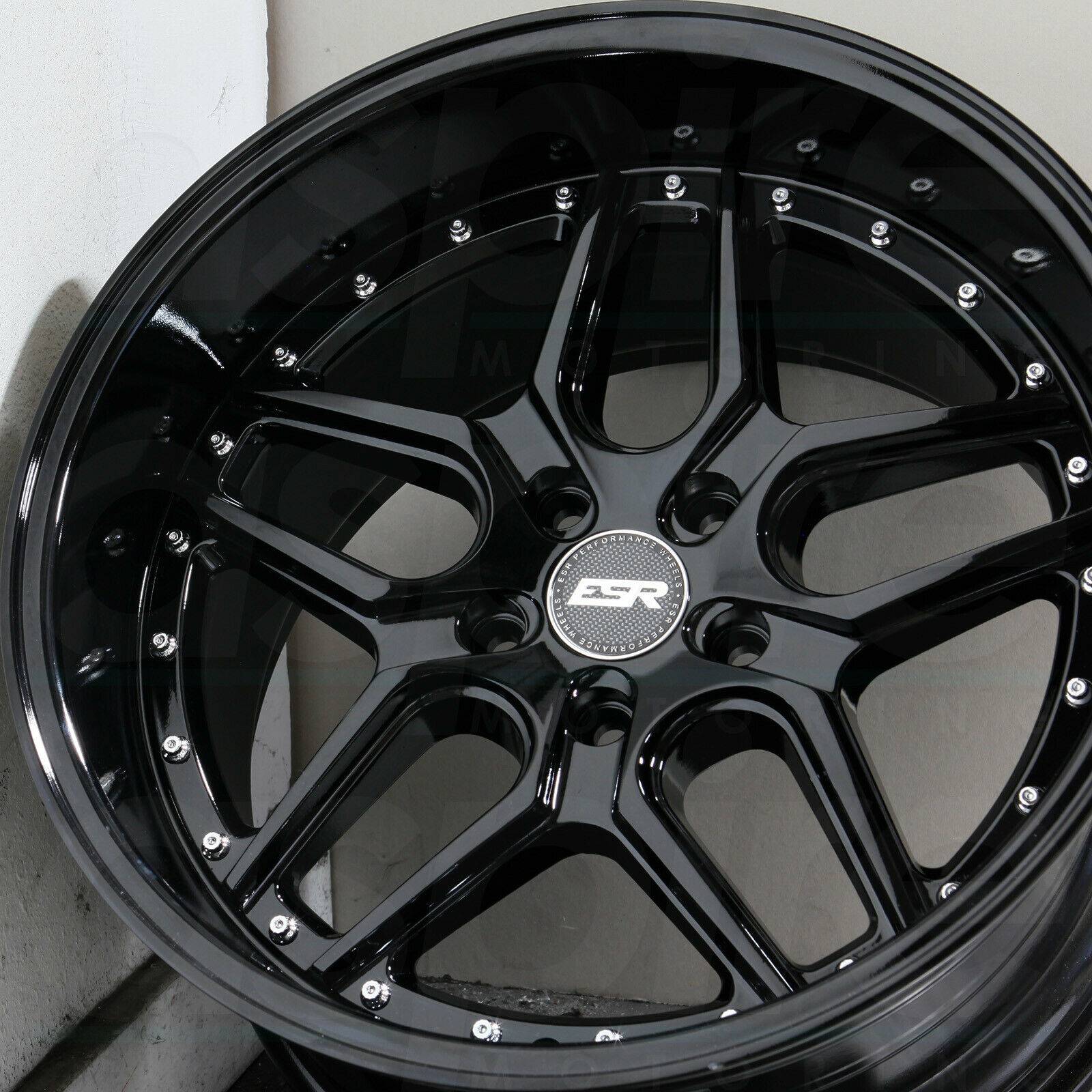

heres my new setup. ESR SR07 18x10.5 et22, and 18x9.5 et22, with a 6mm spacer. tires are federal SS595 275 40, and 255 40. I absolutely love how these fit. could have probably used a little less offset up front, but they are pretty close to flush. but overall, I love how it looks. there is some poke out back, but 0 rubbing. this is on pro kits. I was thinking of going lower, but in person it looks pretty damn good, and this is literally my commuter car lol to me this staggered look just really fits the body lines well. im loving it
Nice looking wheels and got my ESR CS15's about a month back but was undecided on getting the 19X10.5's ET22 because I was afraid of the poke! Did you make any changes to the rear end like camber adjustments or anything or is that how it would poke out just like it was stock? Right now I got a squared setup with 19X9.5 ET35 running 285/35/19's all around. BTW is that like a 3/4 inch poke on those rears and with the 22 offset did you have room to go wider or was 275 the max you could go with ET22? Attached are the 19X10.5's I really want with the 3.65 inch lip as mine are just 2 inch lip...

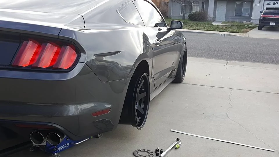

When we first installed the Coilovers in the air, the tire wouldn’t fit, wouldn’t even sit flush on the hub. So we threw all the shop spacers at it we had laying around until it fit. Once we put it on the ground we realized it was lowered almost 4” and completely useless. Before the spacers it was hitting the upper lock ring near the spring. After setting the ride height I’d say I would have been fine with a single 5mm or 8mm spacer. Currently the car is 26.9” ground to top of fender arch on all 4 corners. I left the spacers because I honestly like the fitment. I could probably go down another 1/4” in front with all the room I have. However, I still need to have it aligned and getting rid of the camber is going to bring the tire closer to the fender. I’m planning on running -2 or -2.2 up front and -1.8 rear.
I’ve had 3 lowered s197s. One on Ford Racing shocks/struts and Sportline springs. My track/autocross car on ST-XTA Coilovers with tons of aftermarket goodies, and a for fun car slammed on BC racing BR series. I’m not joking when I say these Fortunes are the best riding coilover ive had out of all my setups. My brother and I noticed it right away. It feels way better than stock at my current settings over bumps and harsh street driving. I have no data on track performance yet. The build quality of these are insane and for the price, you get a digressive valve setup which is great tech to have. Retail for these is about 1500 but I can get them for right around 1100.

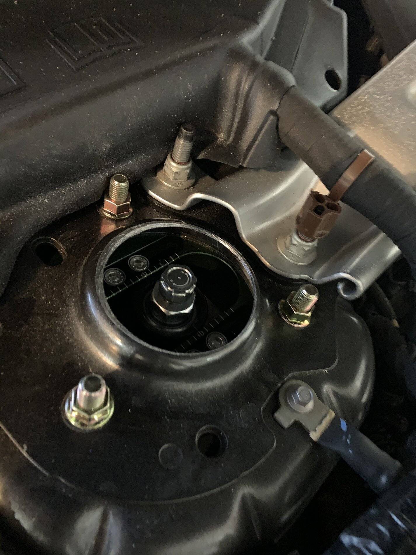

what front camber did you set? 500 or 510 series? Is it correct that you can't adjust camber on-car with their 'camber plates'?
I’m awaiting my alignment. A rough garage estimate tells me I’m at -3 or more up front. I plan to be around -2 to -2.2F and -1.8R if I can get there.

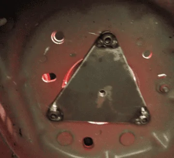

I used the Vorshlag design to modify my strut towers so it’s adjustable. Eventually I plan to have a street and autocross setting.
You gave me hope with the 5mm spacer. I suppose you got the 500 series coilovers? Did you get it with the default springs? It's 10k front and 12k rear. How harsh is the ride compared to what you had before on the car? Is the 1100 price a one-time deal or you can replicate it?
Didn't know that Vorshlag cutting thing existed and having to take off coilovers to adjust the camber really bothered me. Now I know there's a solution. Thanks for that.

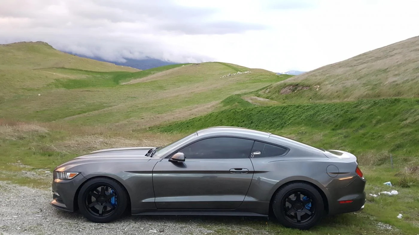

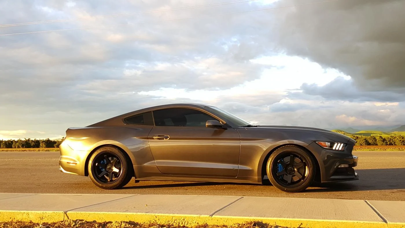

Is this yours? It looks plenty low man! It looks good!
Yeah that's mine. There's a gap in the front that I hate. I want it to have no gap at all same as the rears. And the worst part that the other front side is even higher.

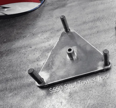

I would highly recommend at least the Steeda strut tower cutting kit. Its a bit easier to use than Vorshlag's write up option which requires fabricating a plate. I didn't want to wait on Steedas cutting tool to come in so I fabbed up my own solution. Its impossible to just use a hole saw as it dances around too much, you need something to drill into or a guide. I'd also reccomend buying a cheap corded drill from Harbor Freight to use. You'll kill an 18v quick.
https://www.steeda.com/steeda-555-8...MIprnX89Ho7wIVPvDjBx21xwzKEAQYASABEgLM0vD_BwE
14,608
12,098
I use a hunk of Delrin I turn on my lathe as the centering guide.
Yep thats essentially Steedas model. I used a wood closet rod that I made to fit and use it. It was less than ideal but got the job done.

I don't think you need to fabricate anything for the Vorshlag version. You use a drill bit to center the drill with this hole.
Focus RS (3rd gen) Strut Tower Cutting Fixture (Tool) - Vorshlag - Brave_210406085545.png
I just read about the digressive pistons in the coilovers and they say they don't go well with small bumps and imperfections on the road as they respond very stiff at the initial compression. How are yours on small bumps?
Yeah, I didn't have the time or patience to purchase and order the kits since my coilovers were already here and we were in the middle of the install. I had a buddy who could have CNC'd a plate for me, but it seemed easier with what I had in the shop to use Steeda's design to make my own. Either will work fine, my guess is the Vorshlag option would have been a LOT easier and more precision. But the job is done.
