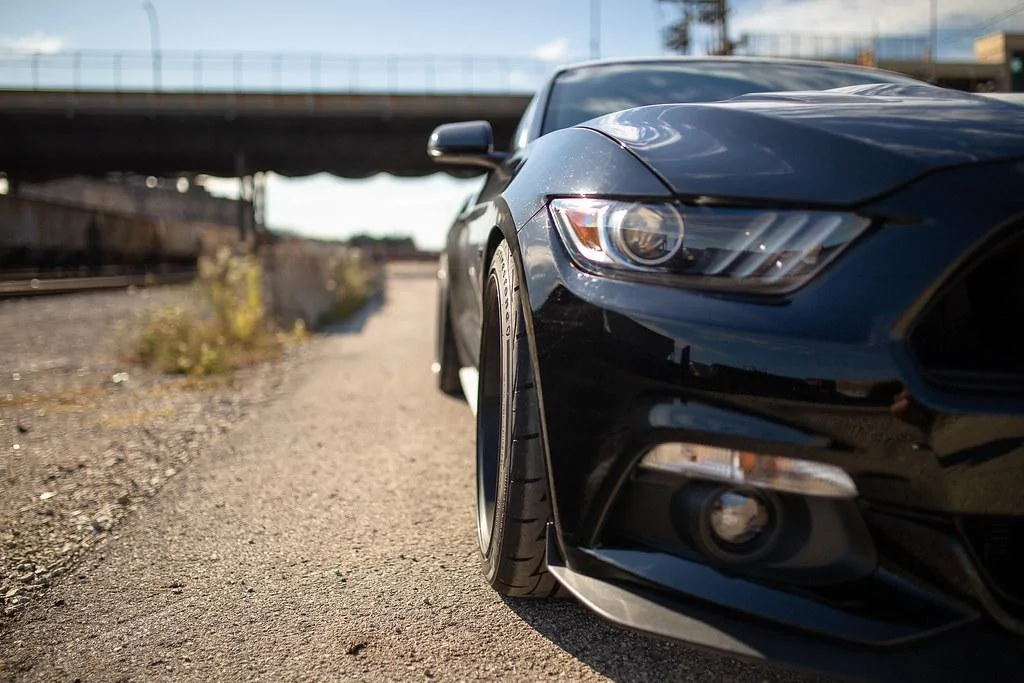

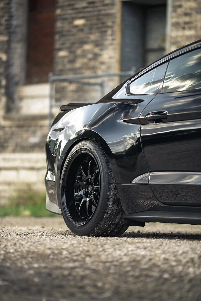

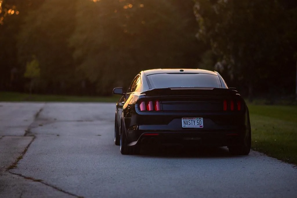

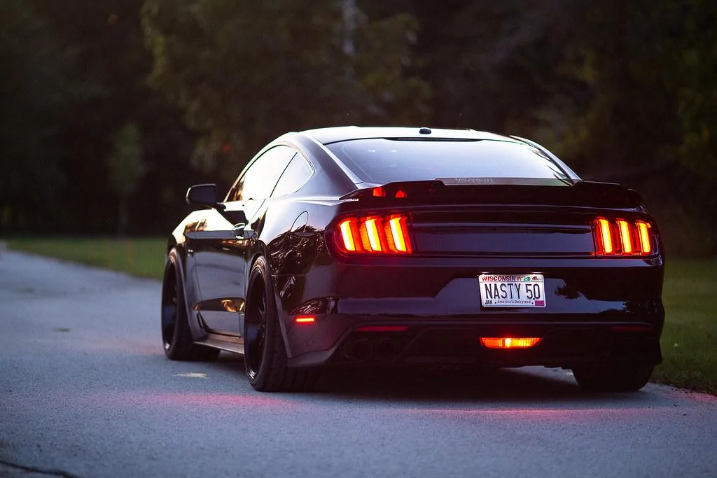

I'll try to get some better photos eventually, but here are a few. Front definitely isn't aggressive, but I cant go any more before rubbing fenders on springs. Rear is decently offset, but still sits high. The ride is too nice currently to go coilovers, so I'll just be happy with the current fitment.
Work Emotion D9R. 19x10.5 +30 (Square)
285/35 Firehawk
H&R Super Sport Springs

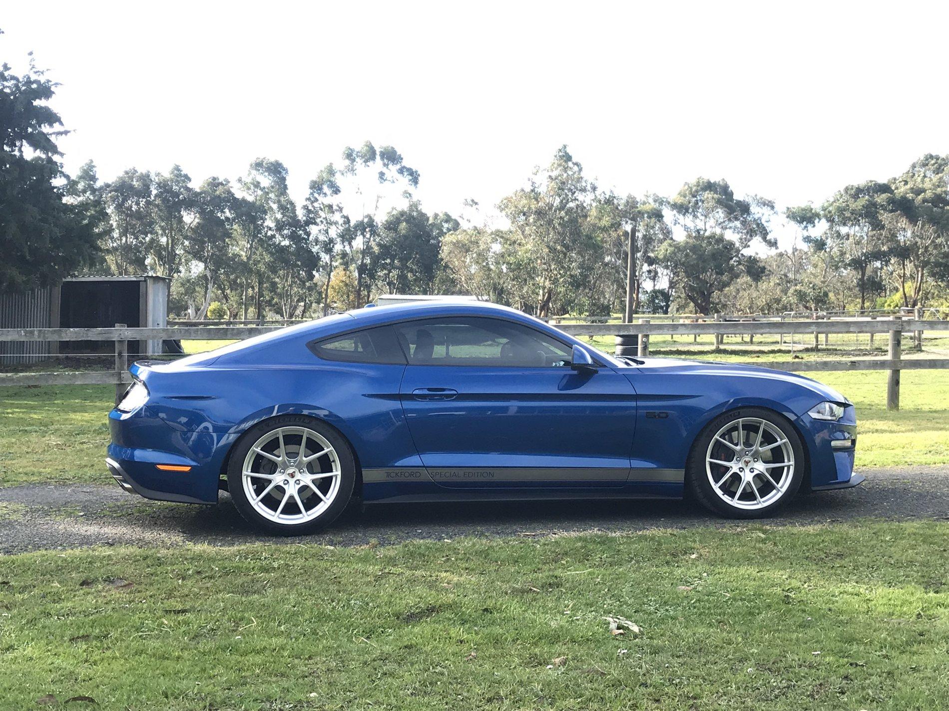

Hey guys 151 page thread reader, first time commenter.
I’ve ordered a set of Work wheels
20x9 +30
20x11 +41
Will the rear factory camber bolt be able to adjust to fit these in?
I will also be fitting BC coilovers at the same time so does this provide camber without touching the bolt first?
What tyre sizes do you think will be needed?
Thinking 255/35/20 and 295/35/20?
Also realising after reading this thread that that front will need a 10-20mm spacer to be more flush which is annoying

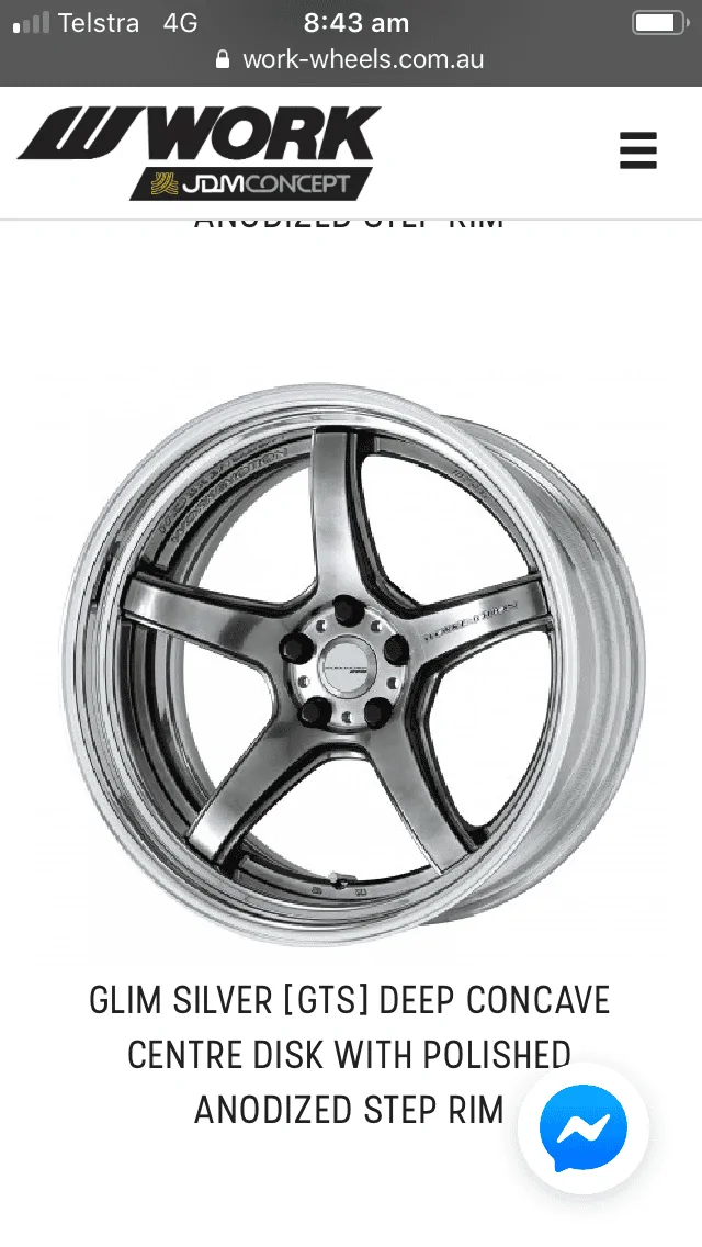

Thankyaa. Yeah they make heaps of 20’s il supply a pic of the ones im waiting on

G'day Tim

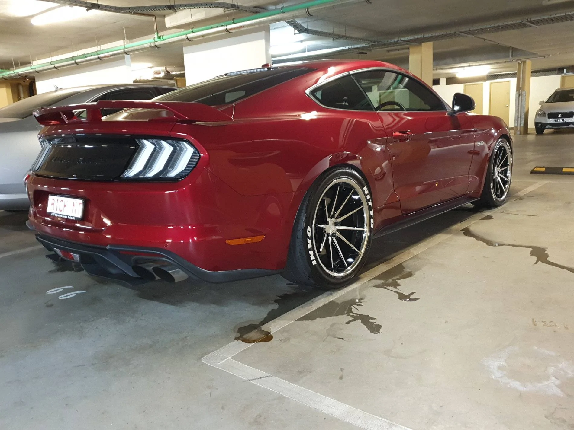

I see you liked one of my posts so you may have seen the wheels on my Ruby Red GT in my posts. I have 20 x 10.5 with +38 offset on the rear with 295/35 R20s and the camber is at -2.0 deg but the tyres still touch (very lightly) if It bounces too much, such as the down side of bigger speed humps. But I'm also running Steeda 1 inch lowering springs. I do believe I could make the camber more negative with the stock camber arm but I do a lot of longer drives on almost dead straight roads and don't want to wear out the inside of my tyres. I think you should be able to achieve what you want with the standard camber arm but it will need about -3.0 deg camber to clear the guards (just guessing).

Based on the fact that your rims will be 1/2 inch wider, therefore 1/4 inch inside and 1/4 inch outside, by my calculations your wheel would only sit out about 1/4 inch further (6.35mm) subtract from that the extra 3mm offset your wheels have and you're only left with about 3.35mm more sitting outside. but the fact that you're going to use the same size tyres will be further in your favour and you shouldn't need to have much negative camber. I still think -3 deg would be the maximum it needs, you may even get away with the same as mine (-2 deg). Ford spec is about -1.5 deg and Ford Performance spec is about -2 deg. So if you're not deviating too much from those you won't wear the tyres too badly.
