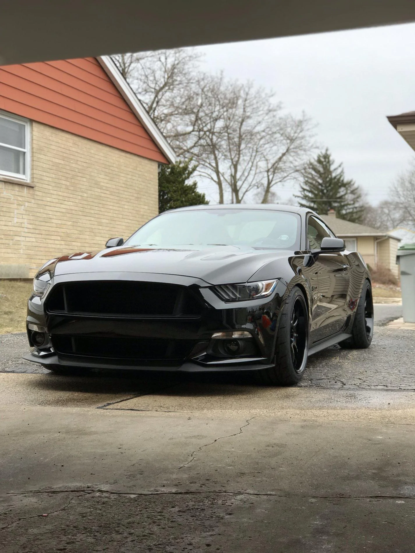

Still waiting to get out with the DSLR, but grabbed a few phone photos. Put about 30 miles on the setup, no rubbing as of yet. Still need to put it through some hard corners to confirm it won’t rub at all. Have to setup an alignment and then I’ll go shoot it.
how did you figure out your issue with the clearance?
