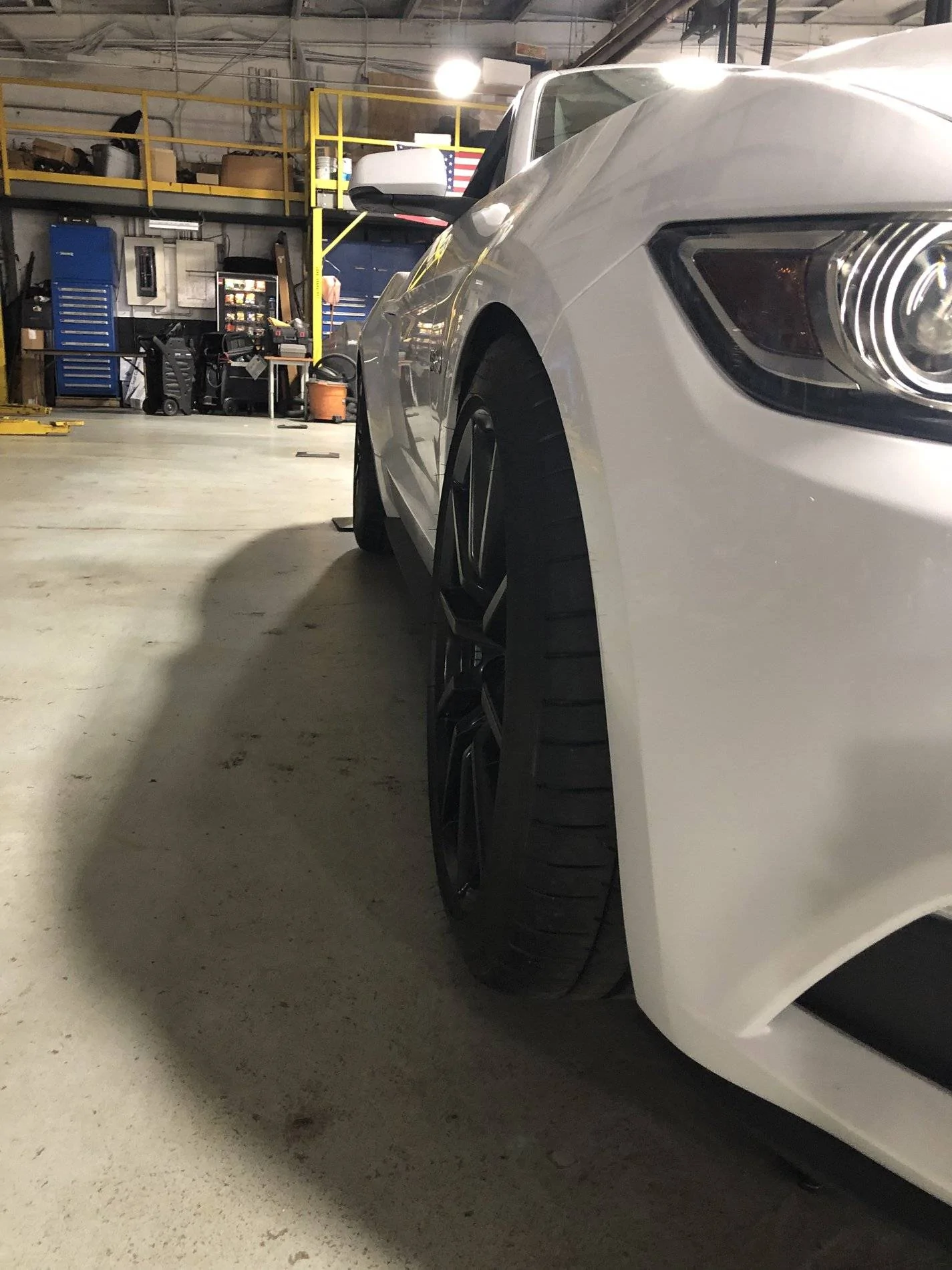

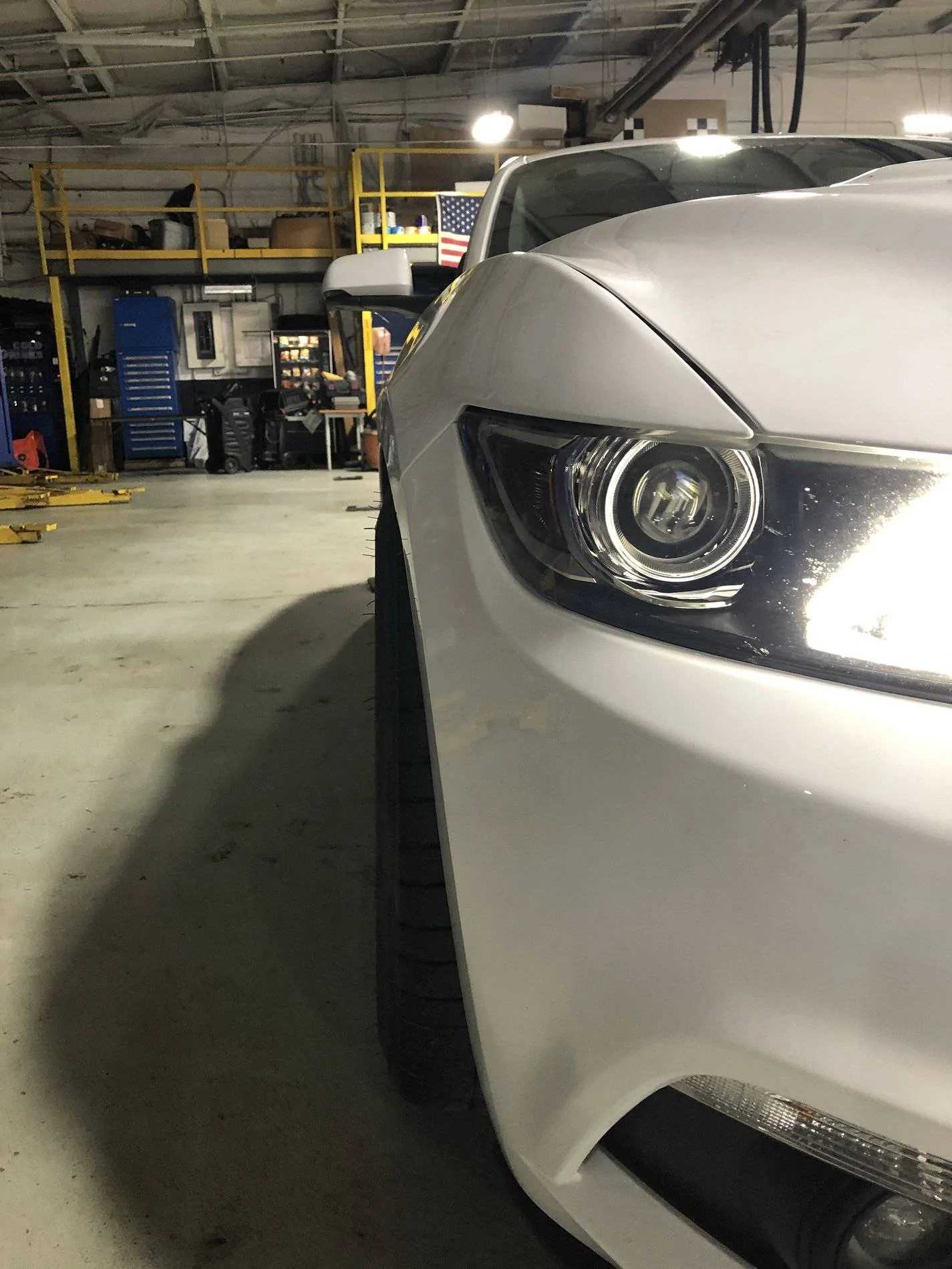

You’d be fine. I had 19x10.5 +30 wheels on the front of my car and I think they fit perfect. Pics below. A +35 would sit 5mm more inward. Only thing you’ll run into potentially is tire rub on the strut. If you go with a 285, you won’t have that issue. You’ll also need some camber in order for the rear to be flush. I’ll link you to the aggressive fitment thread where a couple guys have done this
That looks good. So basically the higher the offset, the more sunk in the wheel will be and the closer to the strut?
