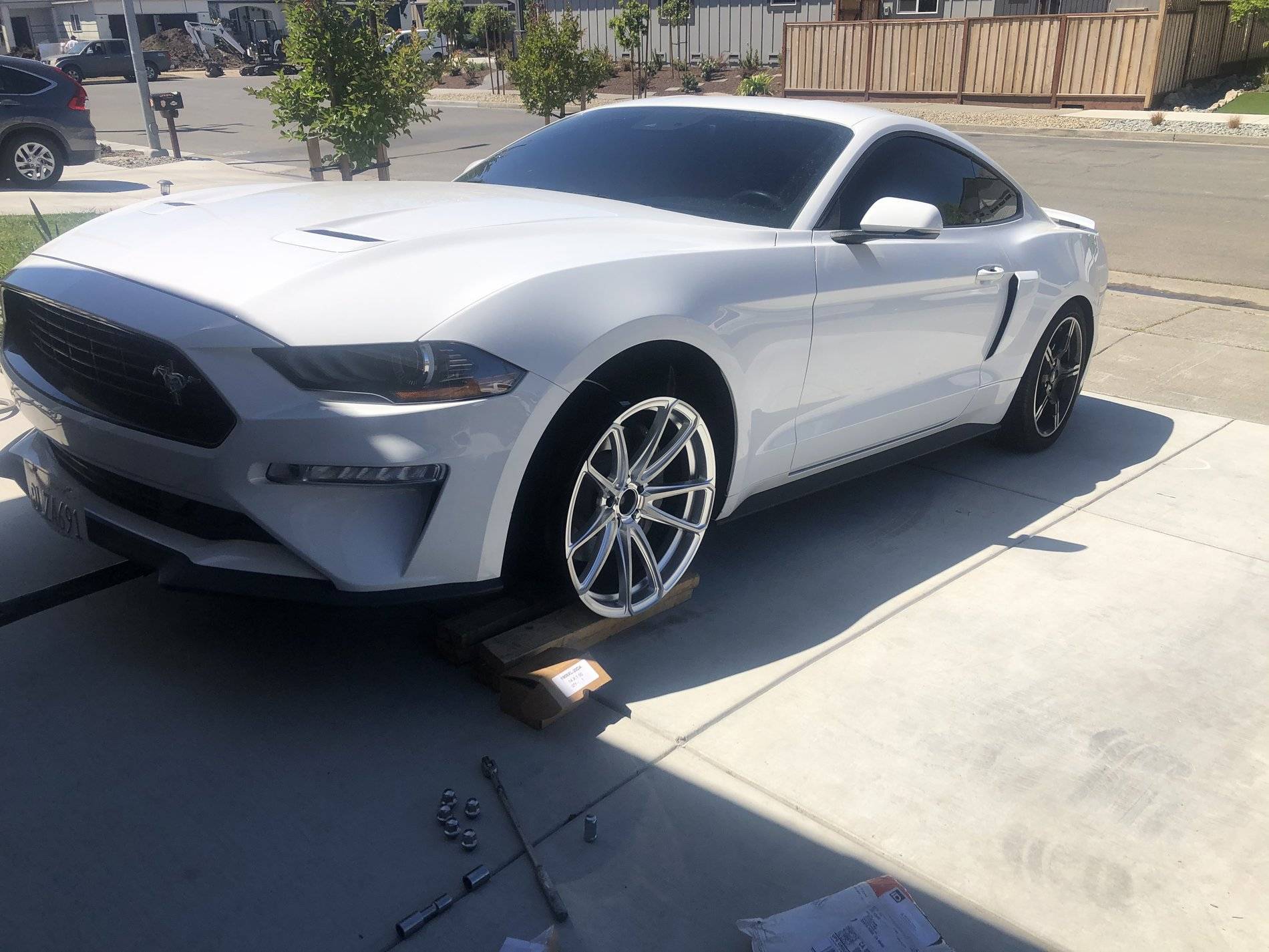

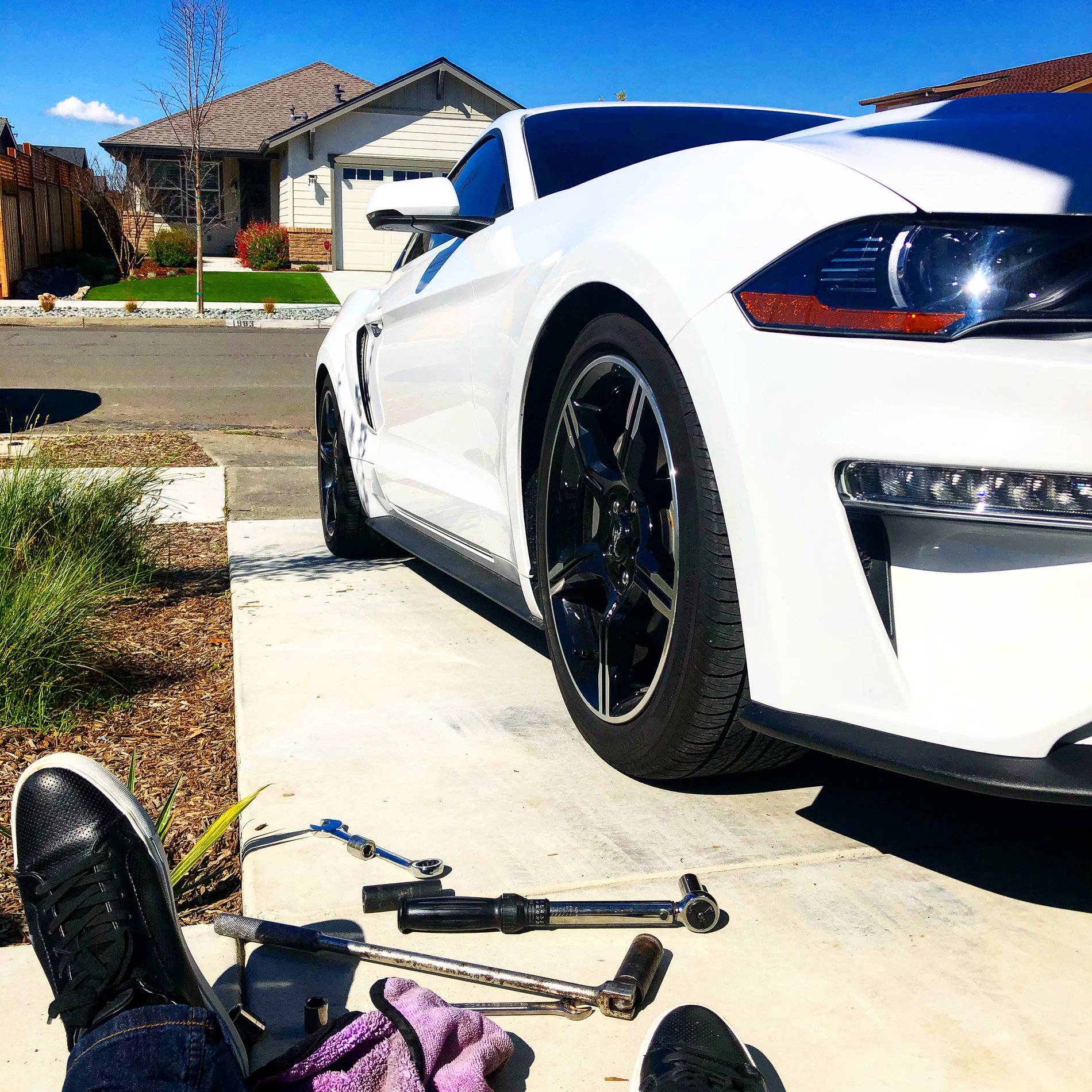

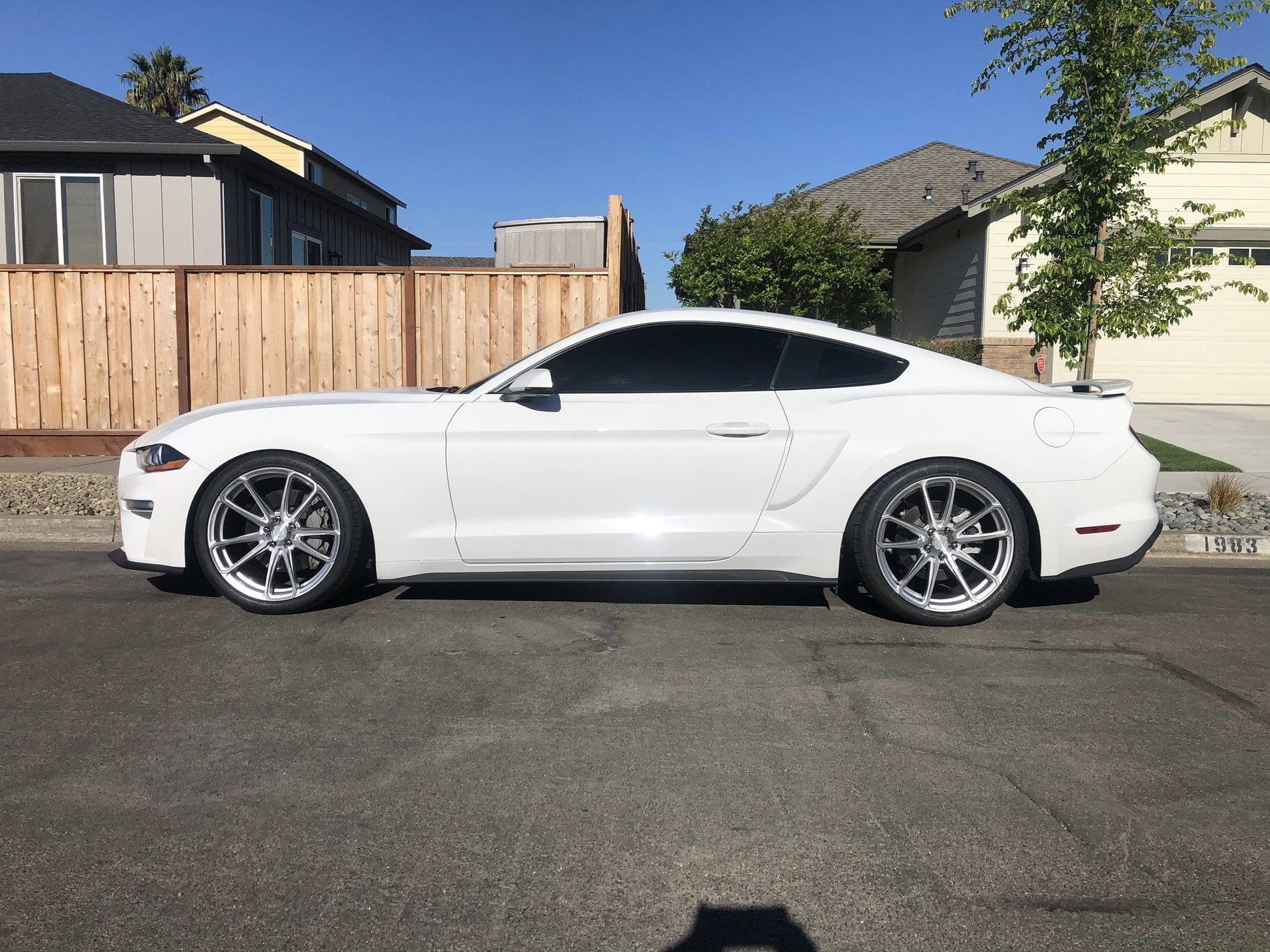

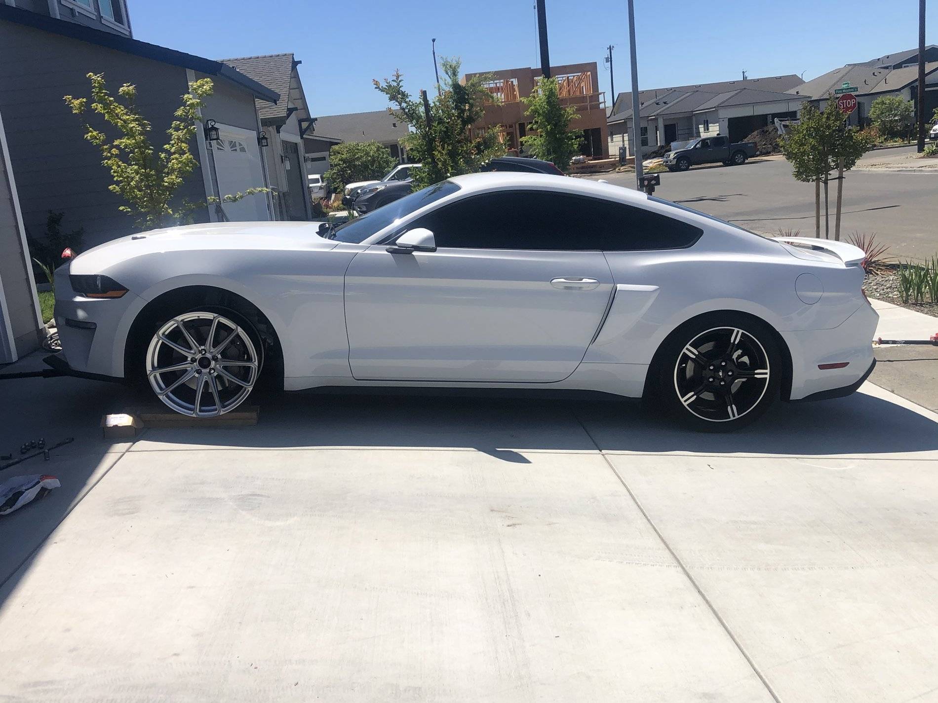

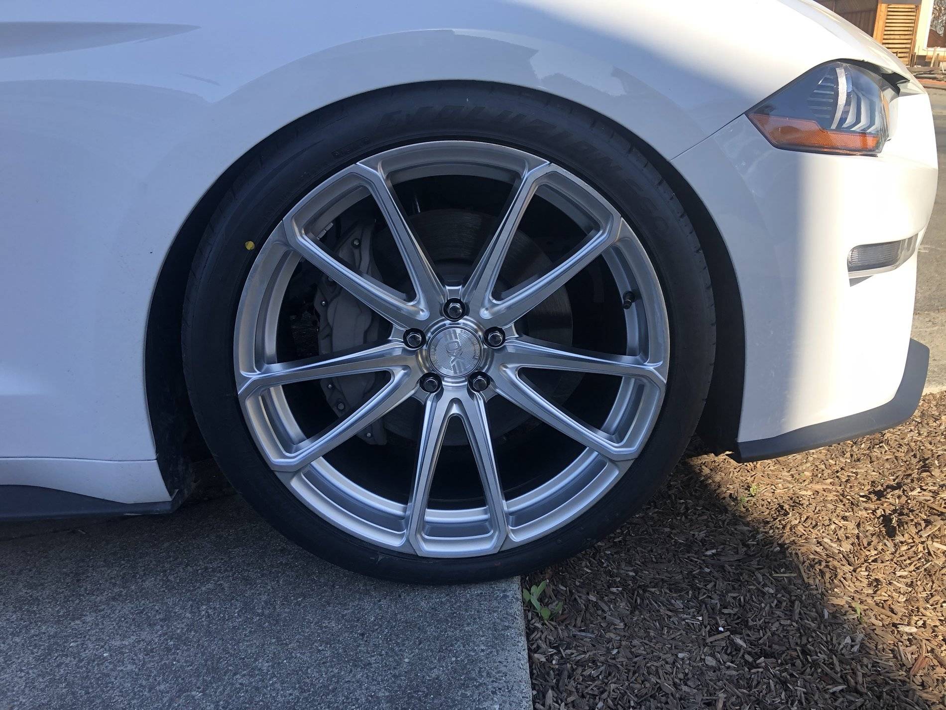

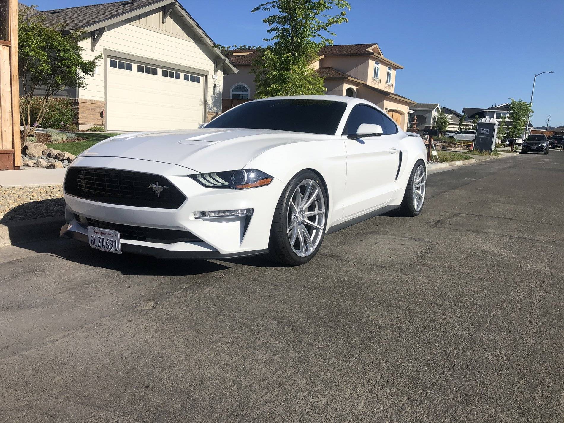

So happy with them!!! They rub just a hair in the front and I’m pretty sure its the inner fender liner when I hit a bigger bump, but more time and driving will tell.

That looks awesome. I’m surprised they rub in the front and not the back. Did you go with the 305/30 and 315/35? I had 10.5’s on my car and they didn’t rub at all. I wasn’t on sportlines though. A 10.5 +30 gives the car a killer stance. Did you go with the

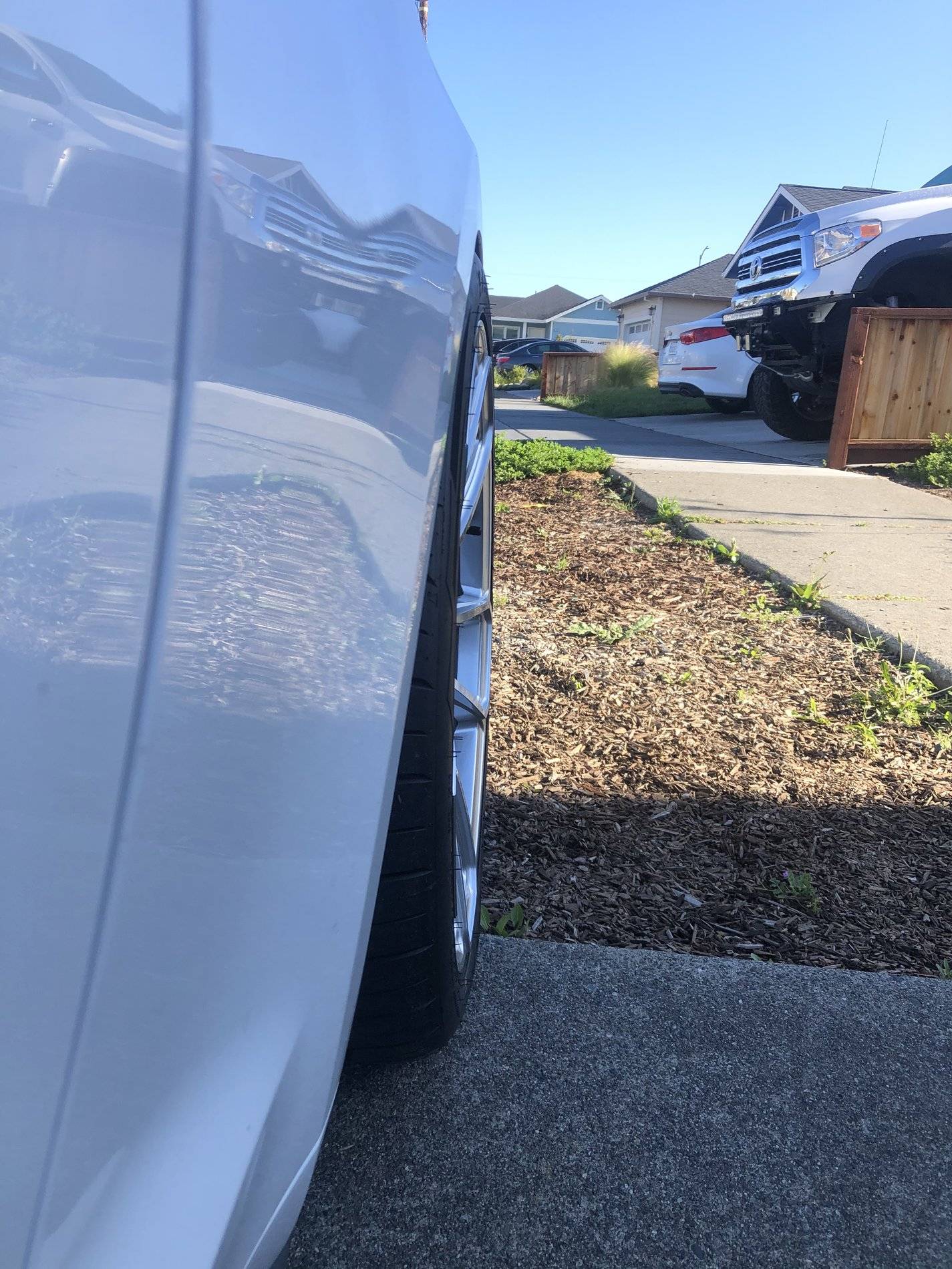

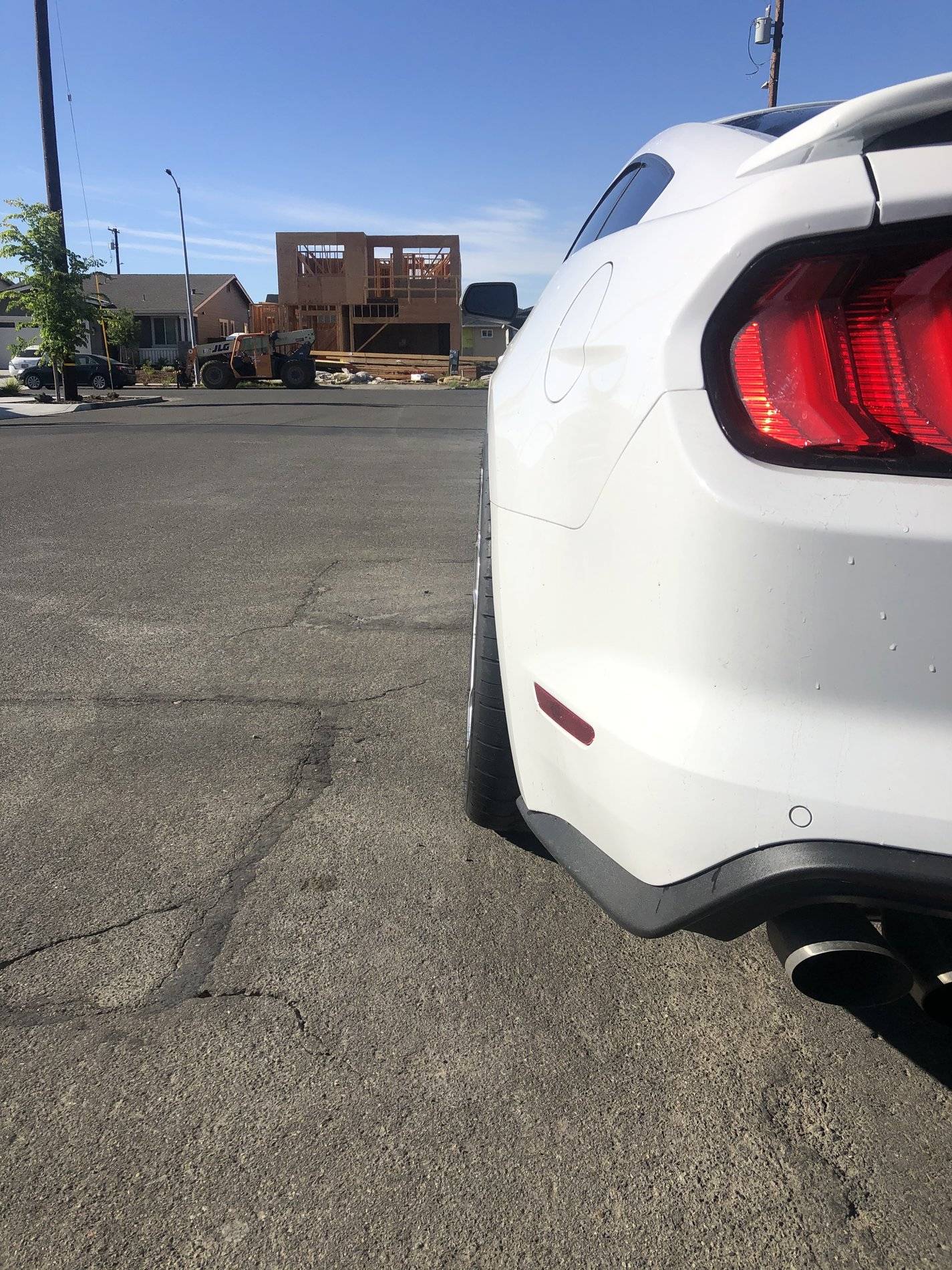

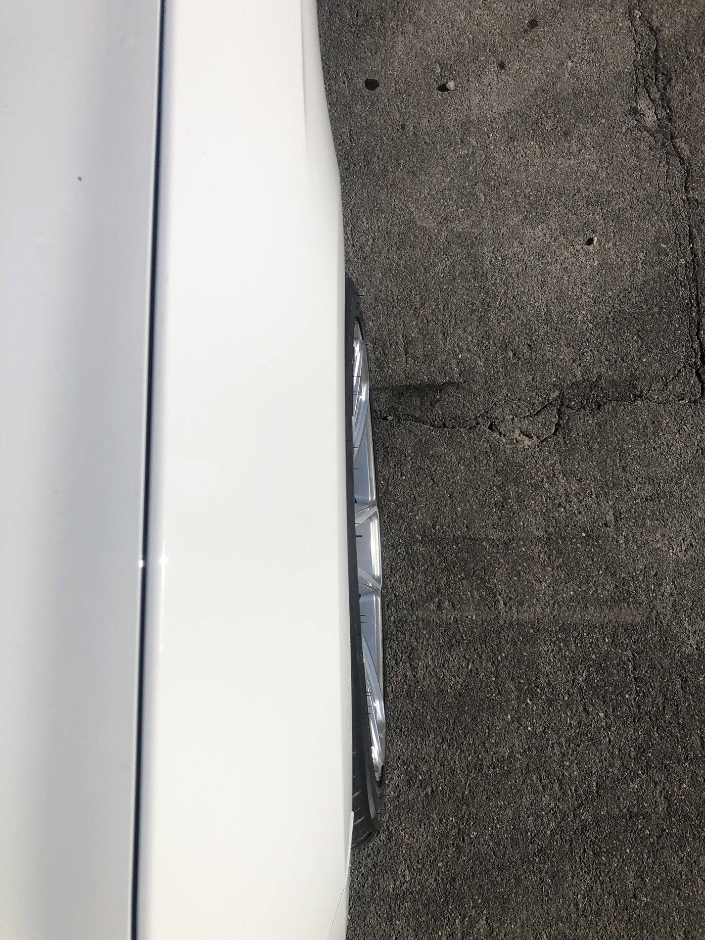

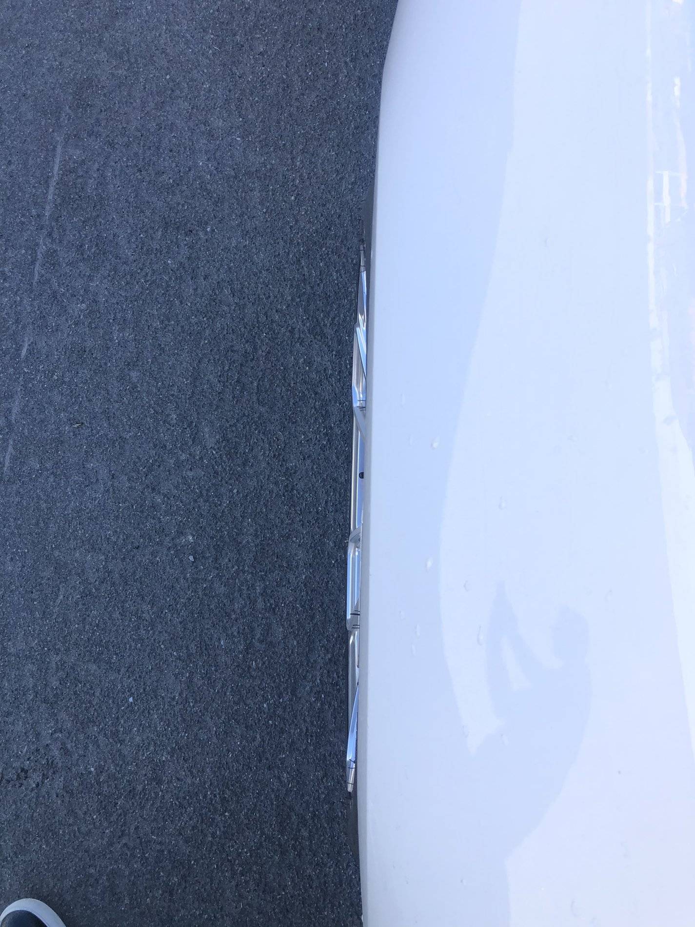

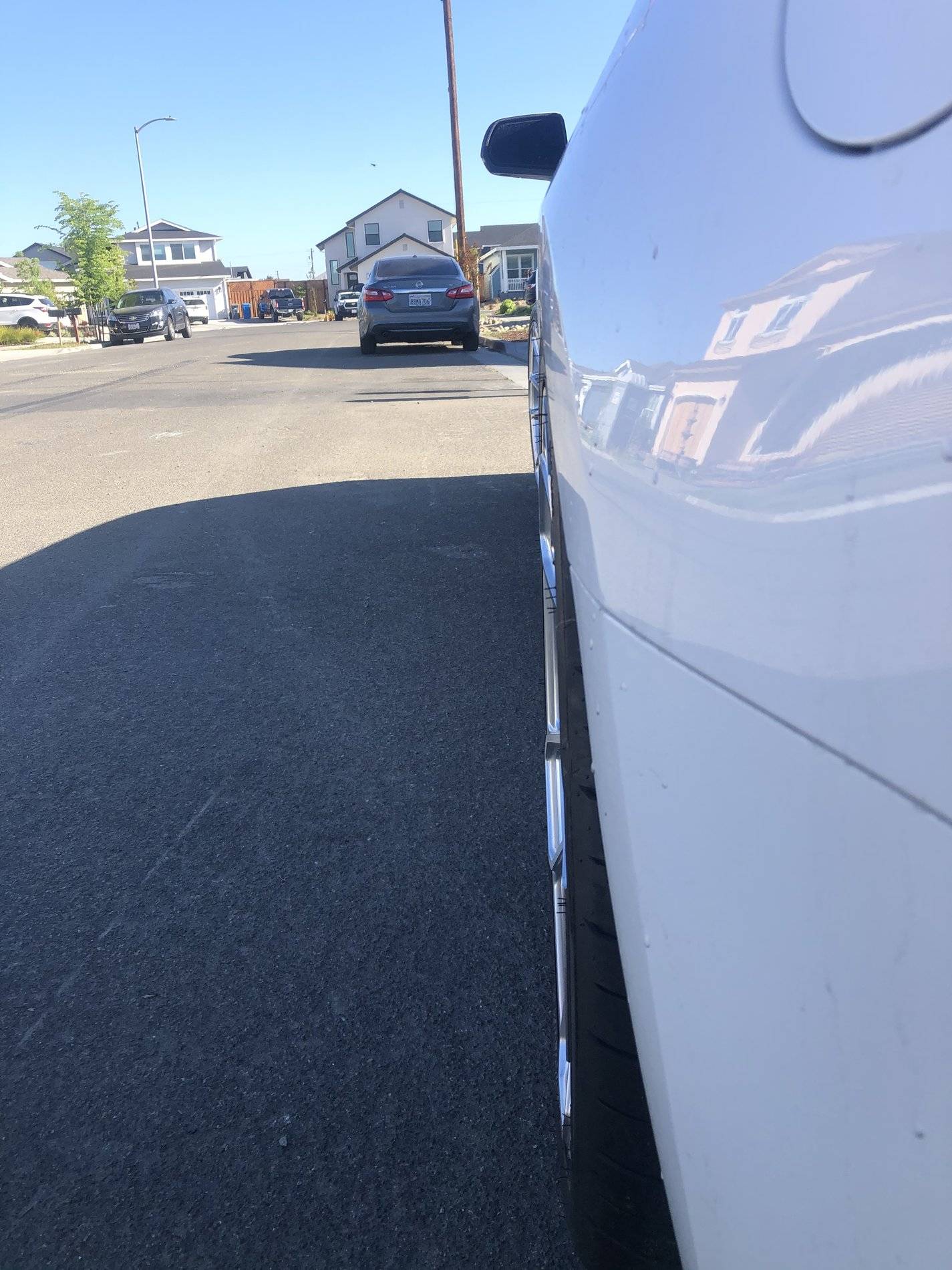

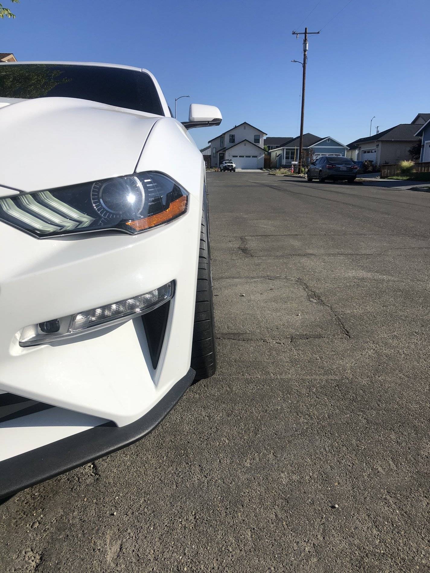

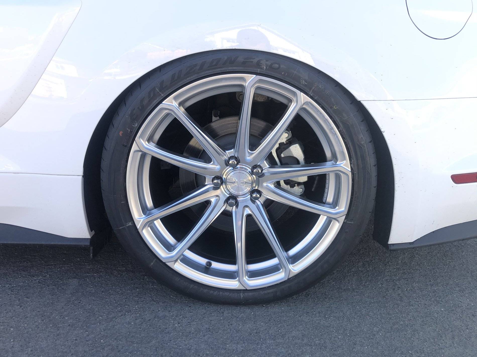

I ended up running 295/30/20 on the front and the rim is a 20x10.5 +30 and the. The rear I went with 305/30/20 on 20x11 +50. Everything clears well, but I can hear it rubbing hitting a speed bump (not a bump lol) at 35 mph in the front. The roads near my house are pretty decent though so I need to find some tougher roads to see just how much they are rubbing. I’m debating if I should invest in camber plates or not before I take it down to get aligned. Here are more pictures of it parked up on a curb to get it to compress more. The rear tucks perfectly.

Going with a 295/30 and 305/30 was a good call. If possible, I’d try and figure out where you're rubbing before getting cc plates. If you’re rubbing on the front of the fender liners, cc plates won’t help you gain any clearance there. And it doesn’t really look like you can go any more positive camber wise front or rear. Glad you’re happy with your set up
