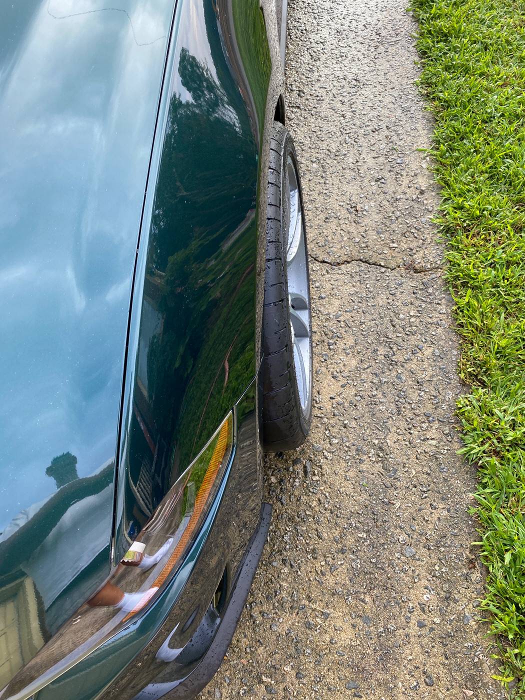

See nothing about extended studs for front in your build; just staggered 19x10/11. I run Steeda camber plates and have just under 3* of negative camber with 305 goodyears on 19x11 50mm offset wheels with opmustang extended front studs and 25mm spacer. No rub, no issues with alignment

Thank you! Mine are 52mm offsets and I have 25mm spacers as well. The extended studs will be going on when the new wheels are tires go on.
Do you have pics?

If you need another type of picture, let me know. Wheels are currently mounted on car
