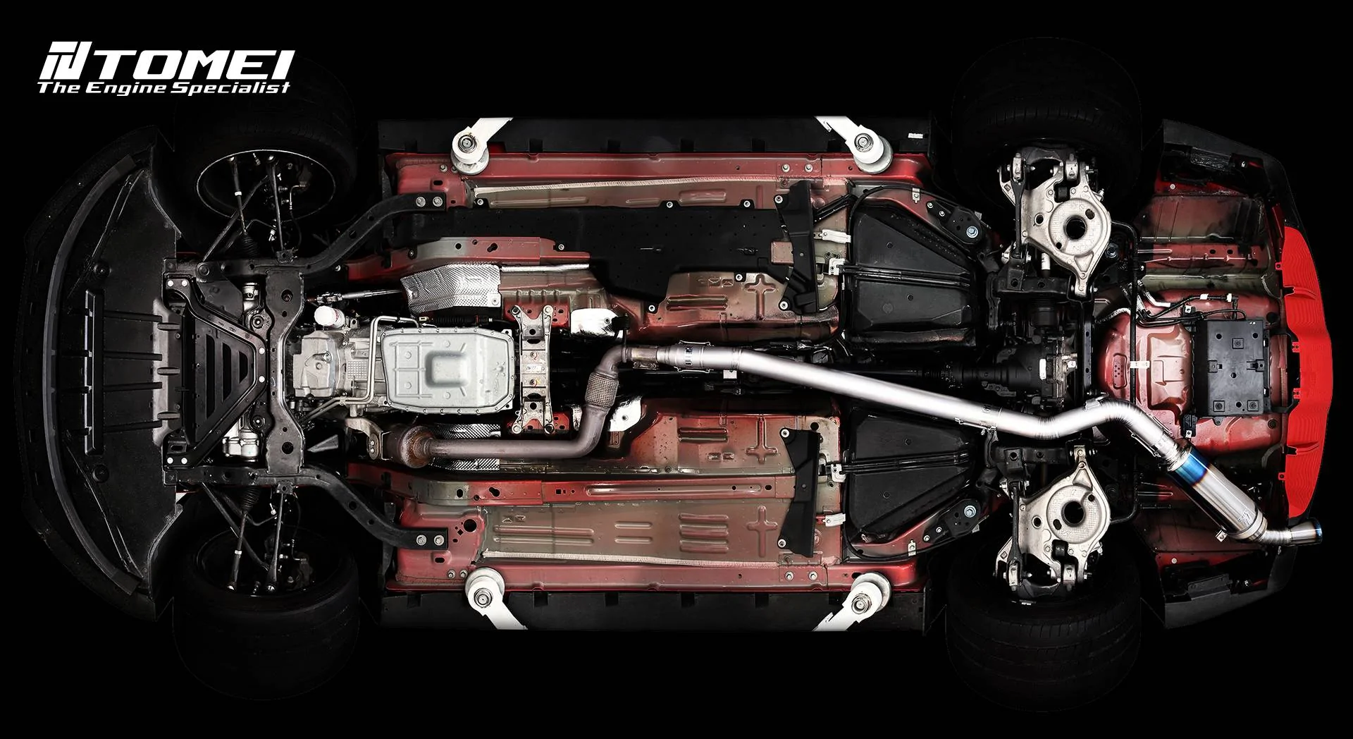

I have actually seen one (1) single exit system for EB's. See here.
Likewise, not sure how or if it would work on a GT. Almost seems like it'd choke the exhaust more than anything.
It for sure would. There is a reason Ford put duals on from the factory. I still love seeing people do unique stuff to the s550 platform, and would love to see a super jdm-esque build.
