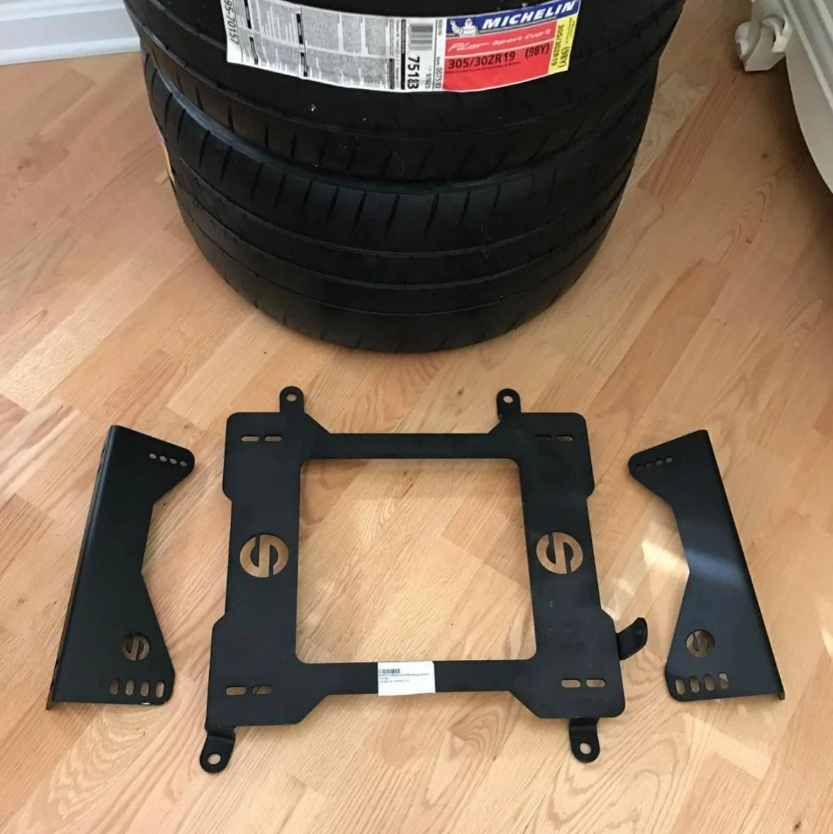

Looks like Sparco makes a set with sliders for 15+. Ill let everyone know how fitment and quality looks.

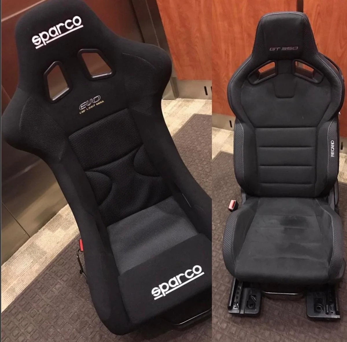

I have the sparco evo with sparco base, slider and side mount for more than a year. They fit beautifully.
