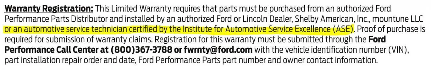

The concern about a third party solution or a Ford solution installed by a third party is warranty support. Hence why people want an official Ford solution that will maintain their warranty. Usually that would need to be installed by a dealer.

I don't think you'll ever see a solution that declares it to be "official" either from Ford or Ford Racing. If there is a warranty, it'll no doubt be of the limited variety. And as to who would need to do the install to qualify for any FR warranty, there have been certain parts that can be installed by qualified individuals outside the dealer network. For example, the Trackey/Track Cal engine calibrations from FR have a limited warranty that reads as such...
