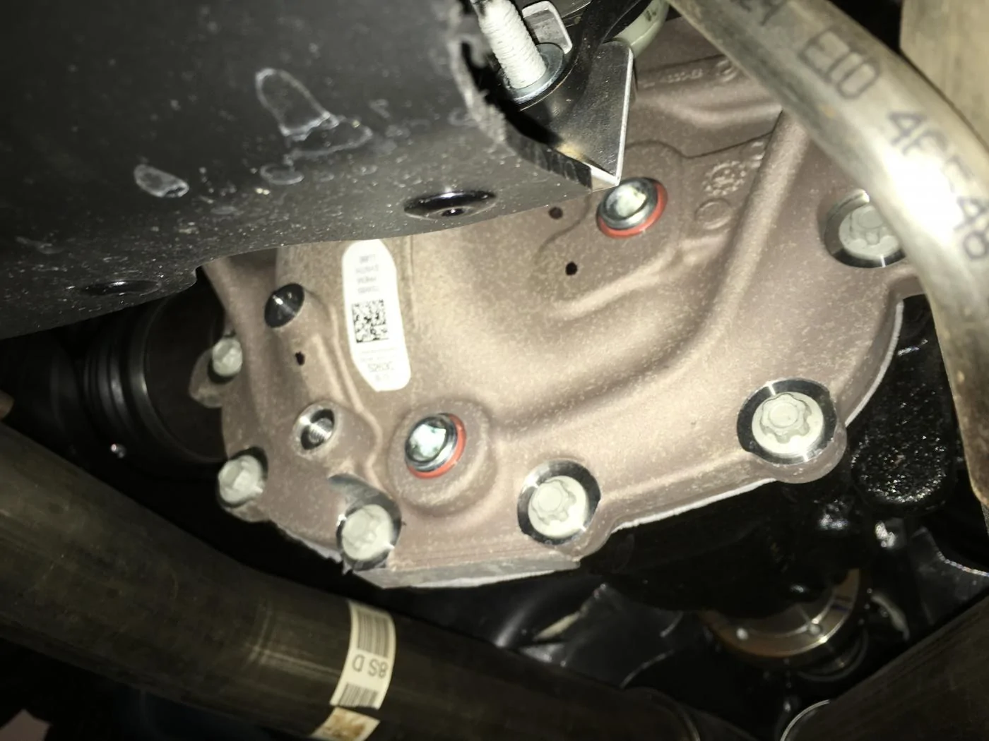

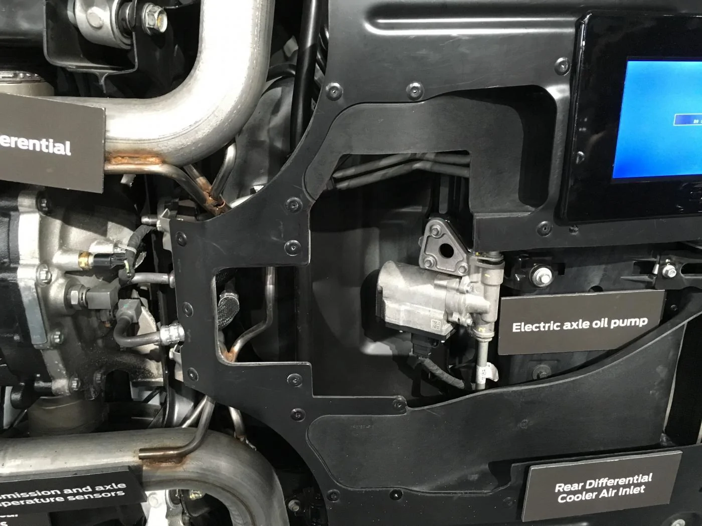

Considering the diff cooler is driven from an external electric pump and the covers are the same, the diff cooler shouldn't be hard to add aftermarket. Though I'm not sure about the wiring up of the temperature sensor which is definitely absent on the tech package.
Transmission would be harder given the integral pump, but at least the temperature sensor is already there for that. Ford Performance hasn't ruled out the availability of these as aftermarket kits, but its early days. I'd expect it to take a while before we see these in the catalog, probably not this track season.
Attached pictures show the underbody of the R prototype diff shows the cooler plumbing and temperature sensor. There appears to be something also on top of that sensor... perhaps a pressure sensor?
The other is a picture of my Tech package diff I just took. Clearly the same cover with a bunch of plugs.
