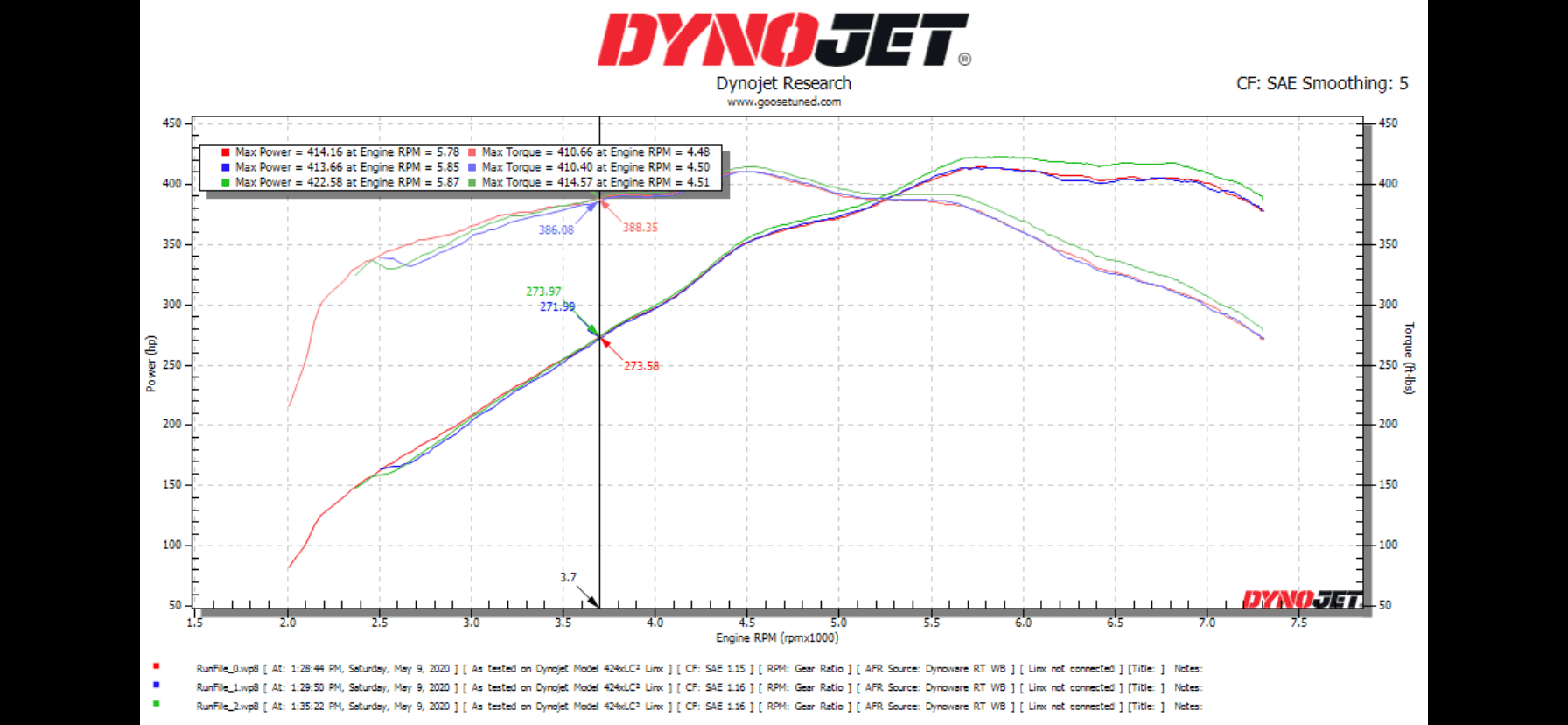

Ran my 2019 PP1 M6 on the dyno yesterday. Car has an H-Pipe and e85R tune from lund.
2 runs were the stock filter, 3rd run was with am AEM Dryflow. All runs were back to back.
Hot day yesterday in Texas and it seems the car was heat soaking considering the power tapered off fairly quickly up top. Timing was pulled more than likely.
I'm sure with a cooler day the difference would be more noticeable.

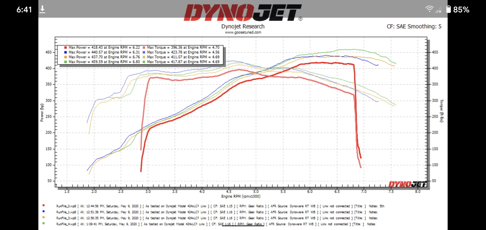

Did the same thing with my buddies car. 2019 with Headers and e85 PBD tune.
One of the runs was in 5th gear. Not sure why they did that.
The rest are in 4th gear.
2 with stock filter and 1 with AEM Dry Flow.

Wow that's some nice comparison. Glad to see positive results and runs back to back. Especially with the drop in being at the end of the runs

Yup. The guys spectating the dyno runs were shocked with 20rwhp on the car with headers. My buddy ordered one instantly since the filter came off my car.

I'd think his buddies car with E85 tune and headers would be closer to 500 whp? just curious if the number discrepancy due to a different dyno.. also stock GT makes around 420 whp on most dynos i've seen and a E85 tune would put it somewhere close to 450 whp ?
