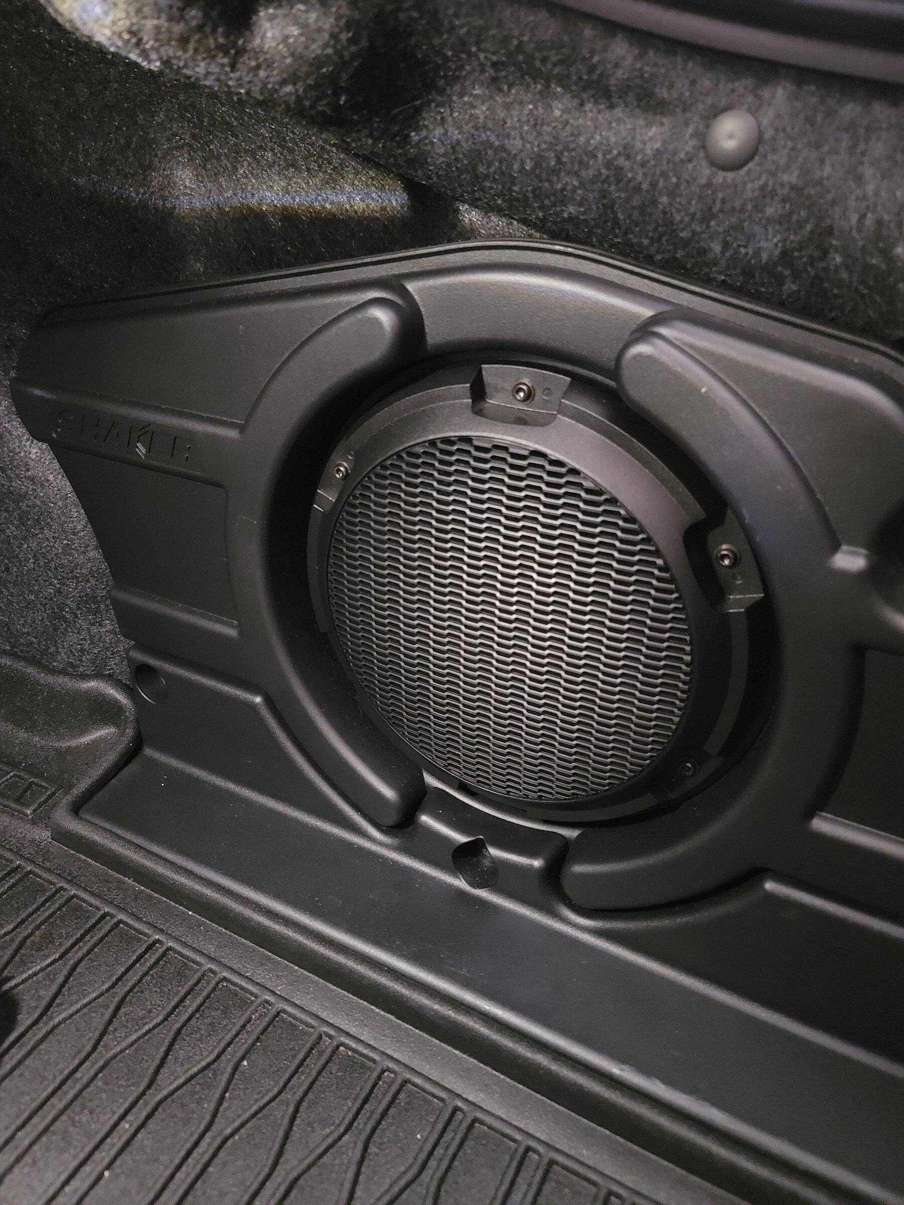

Looks stock doesn't it? It is but didn't come with it. My car came with the 9 speaker system as well. I replaced all four door speakers with the factory speakers from a car that came factory with a subwoofer. This is key for it to sound correct as the factory amp you'll replace under the dash will drive those differently. Also got a good deal on a stock subwoofer with mount and paid $50 for the correct amplifier in the front. Yes it cost me a little more than some but if you can find a good deal on stock parts then it is very possible. There is a thread buried somewhere that shows a small harness you'll need to buy for the back if you have the blue plug behind where the stock subwoofer goes. If you don't have the blue plug you'll need to run the power wires as well as the 3 signal and amp turn on wires from the amp in front. My car is a 2019 so it would have had the B&O had it been ordered with it but the older stuff (back to 2015) works just fine. The amplifier you'll want to look for has a part number that ends with a C(x) Mine Has a CP in it but most will work. So, stock C(X) amp, stock subwoofer with mounting bracket, small harness that connects to the stock sub amp and several different colored rolls of wire. If interested in going this route know that you will need to insert 3 pins in the stock amplifier harness under the dash. As long as you can crimp correctly I can mail you some of the pins for free as the ones Ford sells are insanely priced. I'll get more pictures and try to find a few links to how to do it
if anyone asks.
if anyone asks.
This is exactly the type of thing I’m looking for. Any links/guides would be great. I think I’m capable of doing this. I have general soldering experience and have installed radios before in the car. I know it’s a bit more taking the interior apart and adding amp/new speakers. At the very least I could always take this info to a shop to show what I’m looking for. Thanks
