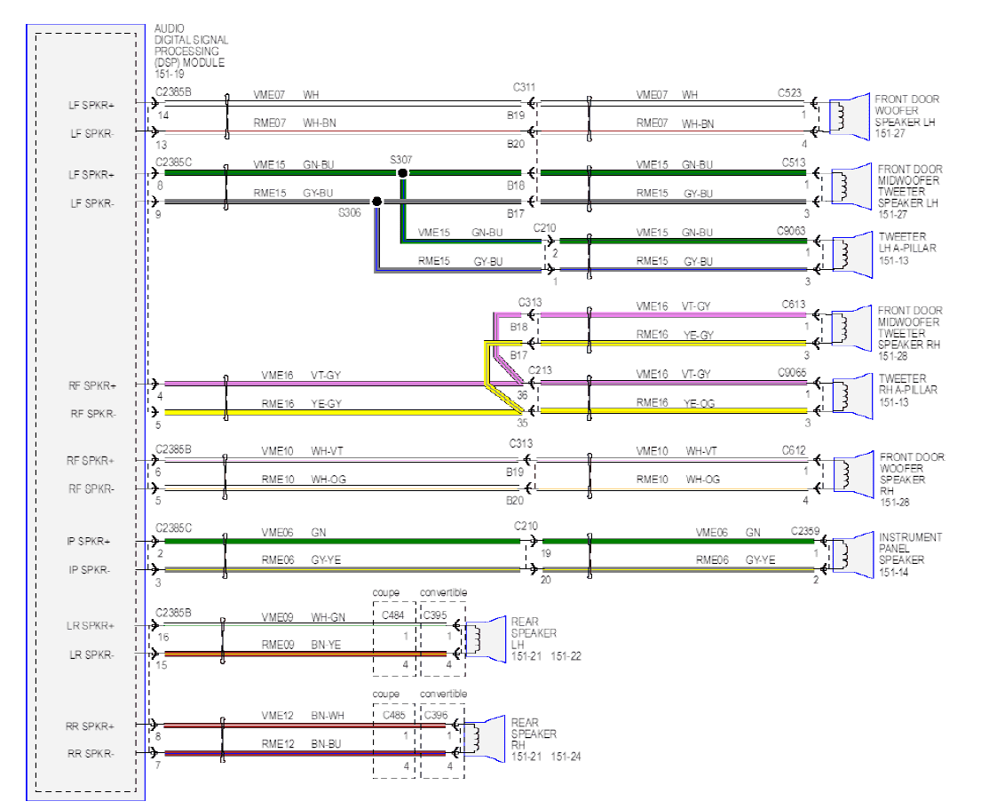

The tweeters and the 3.5" door midrange are wired in parallel. If you skip on the midrange thus doing a 2-way system then you can use the existing wiring in the A pillar to power your new tweeters. It won't matter that the wiring is still running into the door, just unplug the connector at the midrange. I also recommend you just remove the midrange all together and seal the hole. The design is terrible from an audio quality perspective. The back wave from the 6.5 bass driver exerts pressure on the midrange cone because there is no separation of those cavities.

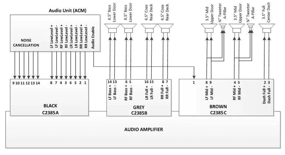

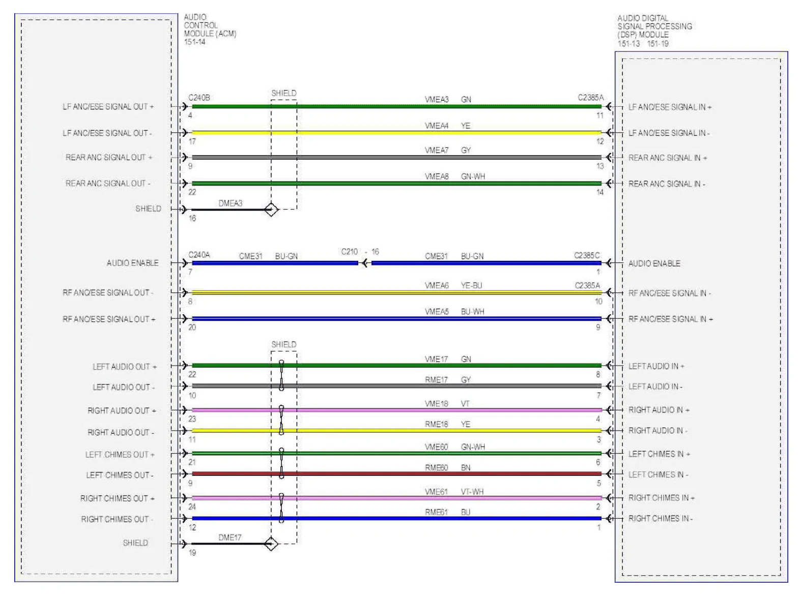

These should help (note ACM is the head unit and DSP module is the factory amplifier):
Low level signals are on the black connector (C2385A). (ignore the noise cancellation ones).
You are going for Pins 1 through 8. Observe the numbering they are not sequential on the diagrams but they are on the physical connector itself.
If you are going to run the signals to the back of the car make sure they are twisted pairs and shielded for noise immunity.
Speaker returns from the aftermarket amp run back up to the grey (C2385B) and brown (C2385C) connectors, regular speaker wire "zip-cord" or Metra 9 conductor speaker cable work well for this.
The door midrange and the A-pillar tweeters are wired in parallel at who-knows-where under the dash. Best way to handle this is to use factory wiring for the door midrange and run new wires for your tweeters back to your amplifier.
Note that the "Audio enable" from the ACM is only 6V. Many aftermarket amps have problems turning on with anything less than 7V. (Thanks Ford!) You will need a PAC TR4 to give you 12V from the 6V enable, or grab the BLUE/WHT wire in the trunk lid harness that provides 12V to the rear camera circuit when the car is in ACC or RUN mode and use that to turn on your aftermarket system.
If you buy the idatalink HRN-AR-FO3 harness, it has all the necessary plugs needed to interface with the car without cutting the original factory wiring.
