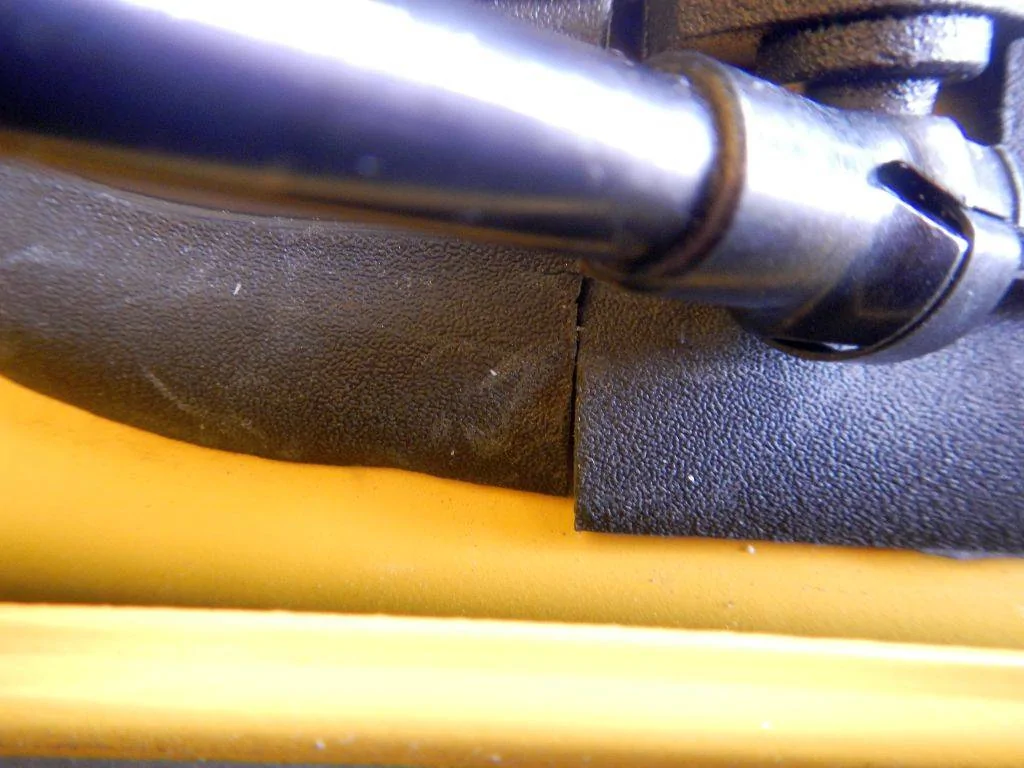

My "V slot" took the shape of a razor-thin split; the rubber lies flat, likely not seen unless you're looking for it.

"My "V slot" took the shape of a razor-thin split; the rubber lies flat, likely not seen unless you're looking for it."
A picture would be nice.
Sorry to be so tardy. It seems that a couple of heat/cool cycles caused the battery cover to reshape itself: the rubber still lies flat, but is no longer aligned well. Maybe let it be for a few more cycles and trim?

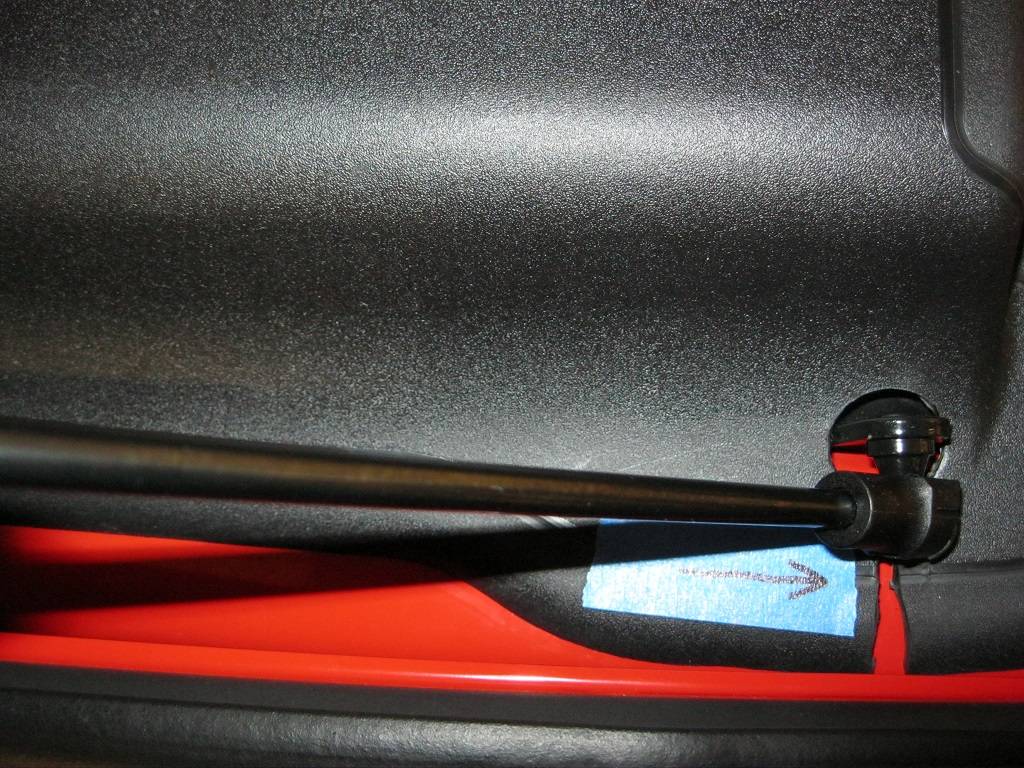

I installed the Steeda hood struts and couldn't be happier. The beauty of Steeda is that you can do the job without any help as no one is needed to help support the hood during install. I was hesitant to cut the battery cover to allow for the battery side mounting clip to be installed but I used a tapered drill bit and drilled the hole to about 1" diameter. The hole in the battery cover looks like it came from the factory. The hood struts work very well and I'd do it again. Steeda knows Mustangs.

Good idea to cut away the battery cover at the strut base instead of drill a hole; much easier to check the battery.
