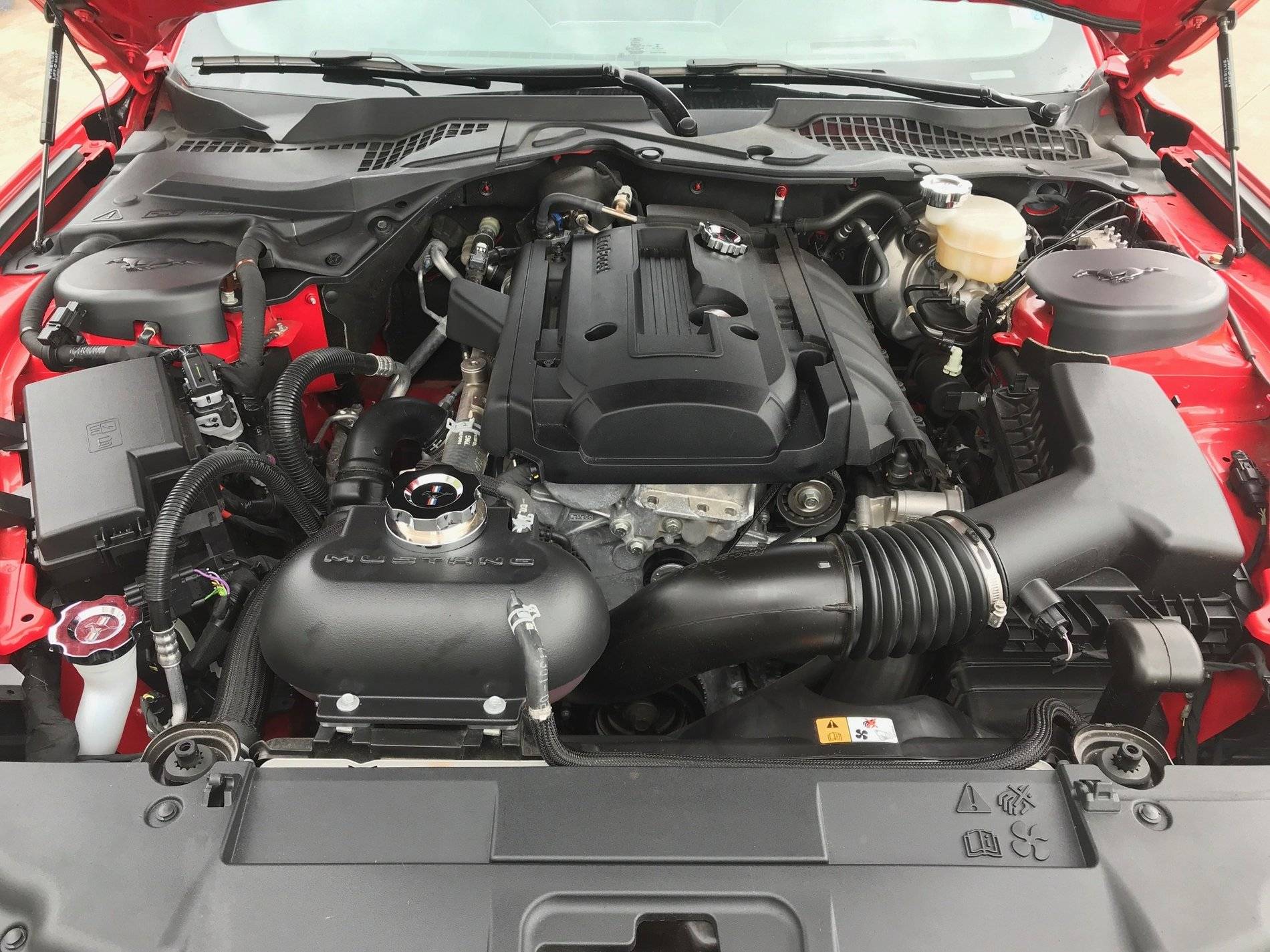

Was the first mod I did as soon as I got the car.
The FP struts rusted, replaced with redline and no problems in 3 years.

Looks great under your hood! nice work! I love the engine cover.....

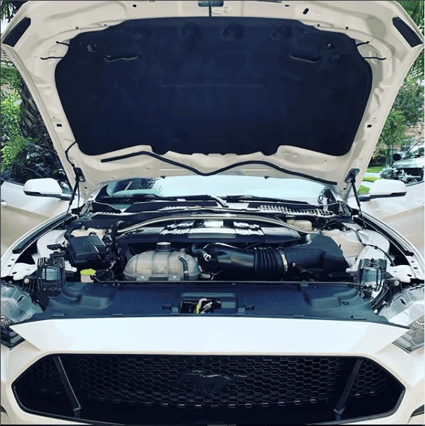

yup I went with the black redline tuning hood struts on amazon, instillation was easy and these hood struts are great. One thing I recommend is when u install them go to Home Depot and get some of the thin rubber stuff u put under ur shower when ur building ur shower its gray and about 1/8 of an inch thick and it protects ur car from the brackets chipping or removing the paint underneath and stops rust. I got the guy to cut me a strip for free but I highly recommend that
and yes I know one of the brackets at the top of the pic is crooked and I fixed it lmao

My Steeda struts came with a couple strips of neoprene to put under the strut brackets. I think it also helps keep the brackets from rotating any.
