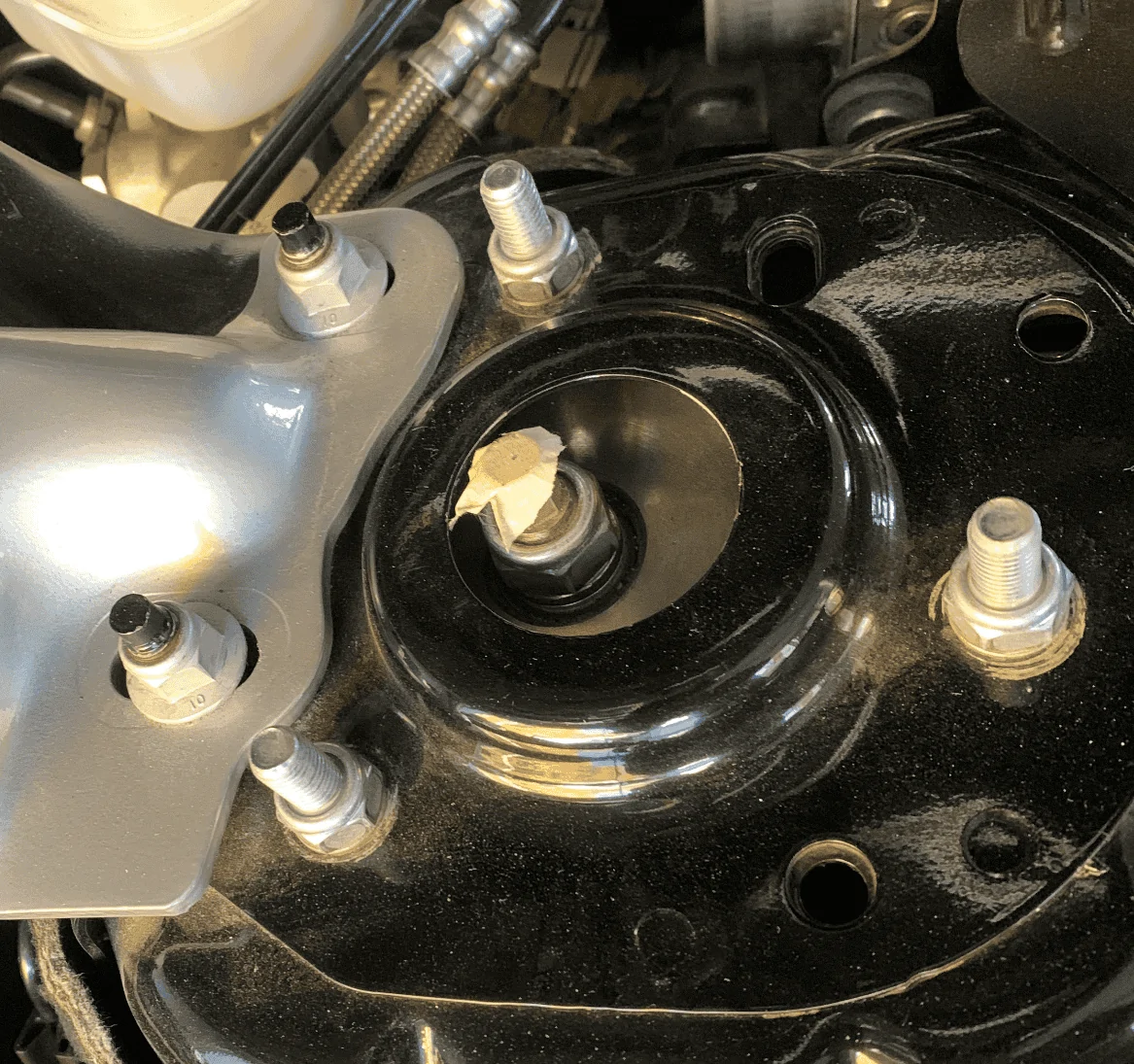

So, this is what 2.2 degrees looks like on my 2016. It's the same on both sides, so the crossmember is centered:
I'm using the Steeda camber plates. The tape with the dot on it is part of my adjustment toolkit. I put a piece of tape on the fender and make reference mark on it. From there, adjusting is just a matter of measuring - a 0.1 degree camber change is almost exactly 1 mm of movement inward or outward.
