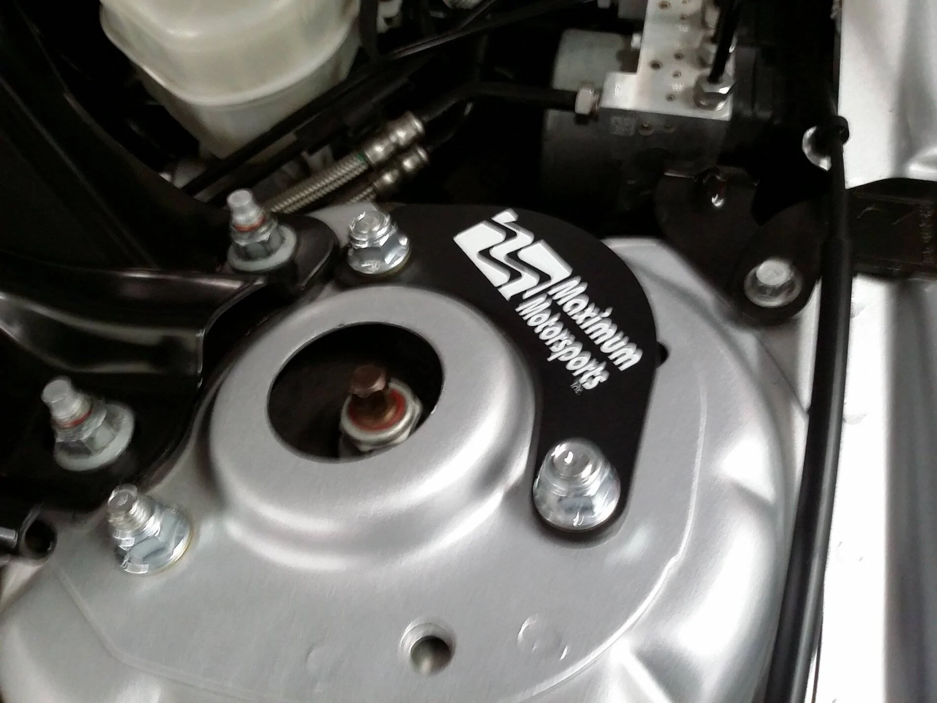

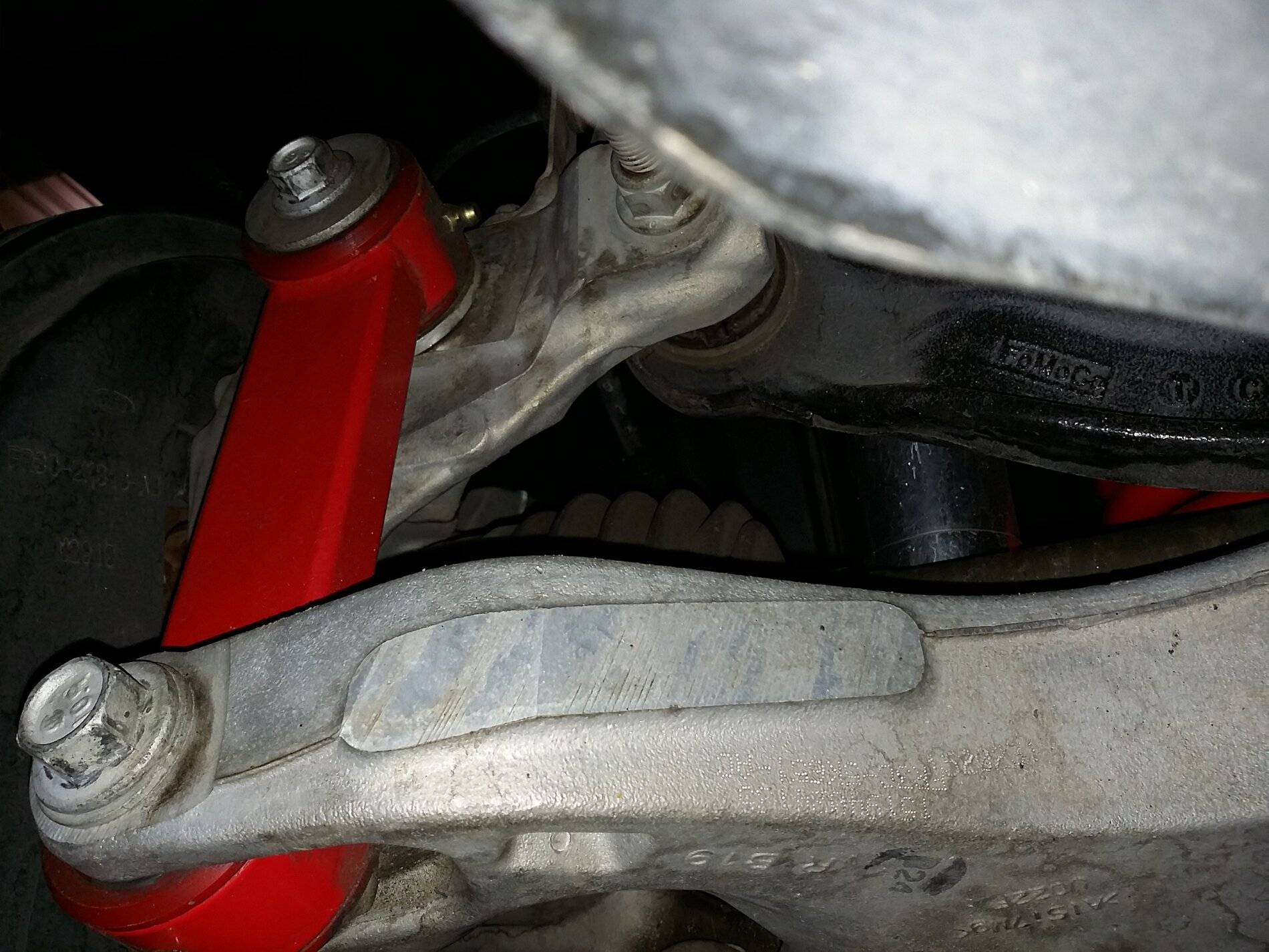

I have a 2015 on eibach sportlines. 1.5 drop at all four corners . The fronts I installed maximum motor sports camber /caster plates . There is enough adjustment in the rear to get everything back to spec .

For the rear comber - none of these things will have any impact on "dialing in the camber". If you want to make it easier for the shop, you have to replace camber arm with the adjustable one (as stock camber is adjusted by sliding the inboard mount of a stock arm).
Not sure what camber numbers are you looking for but with rear you might be able to hit the spec without any modifications to the suspension - like said above.

The only pain the ass is the left side , hard to get to the adjustment point due to the filler neck being in the way .

I was more talking about having to go back and forth between camber and toe adjustments to have them what you want as one changes with the other - and that sliding inboard mount of stock camber arm isn't really an accurate way to set it - that's why it's pain in the ass. But certainly doable.

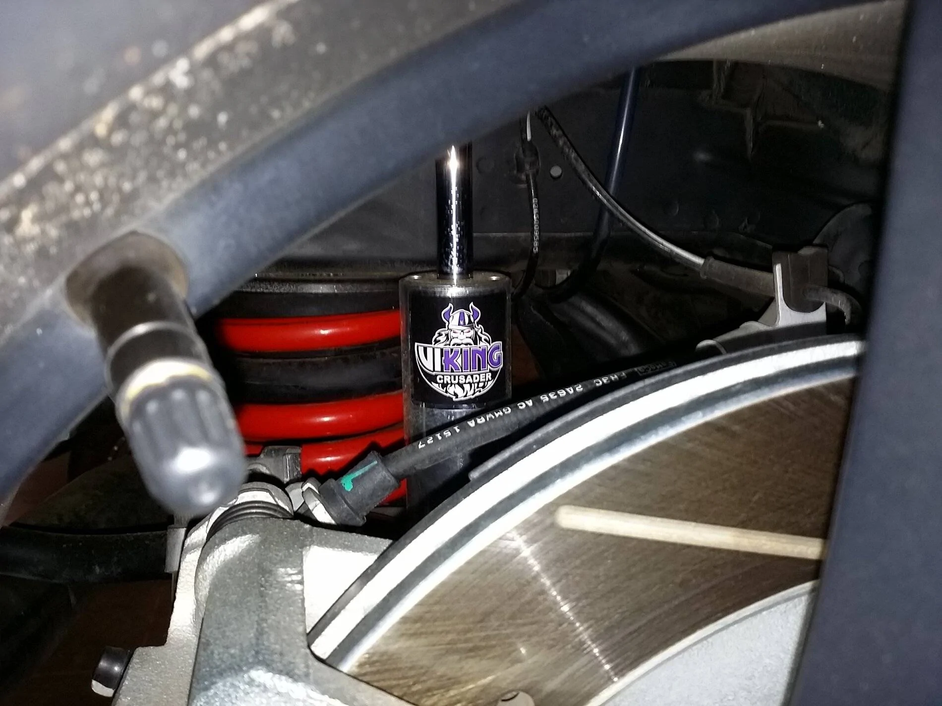

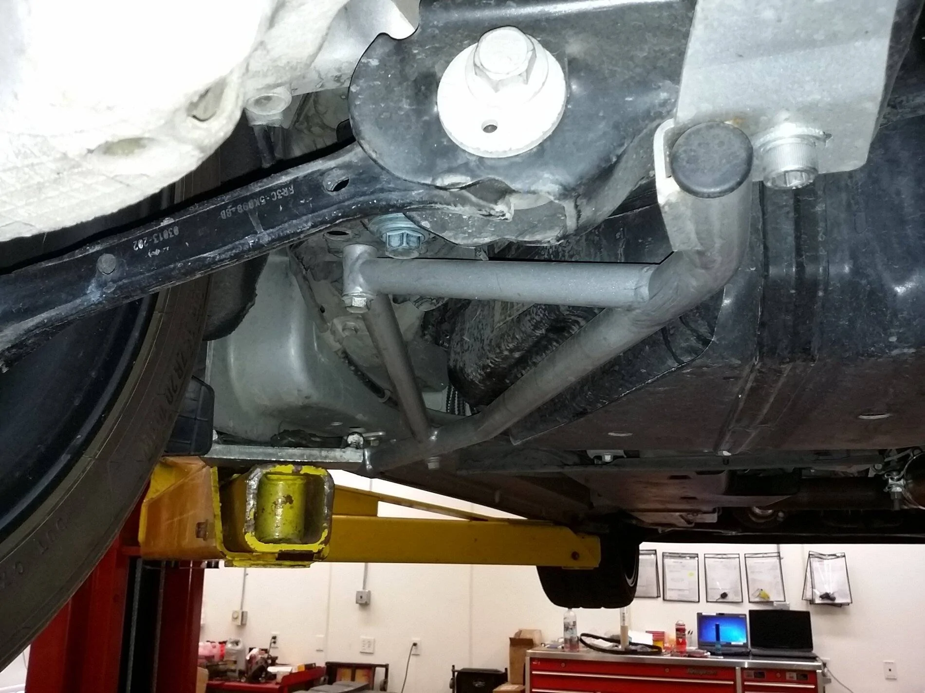

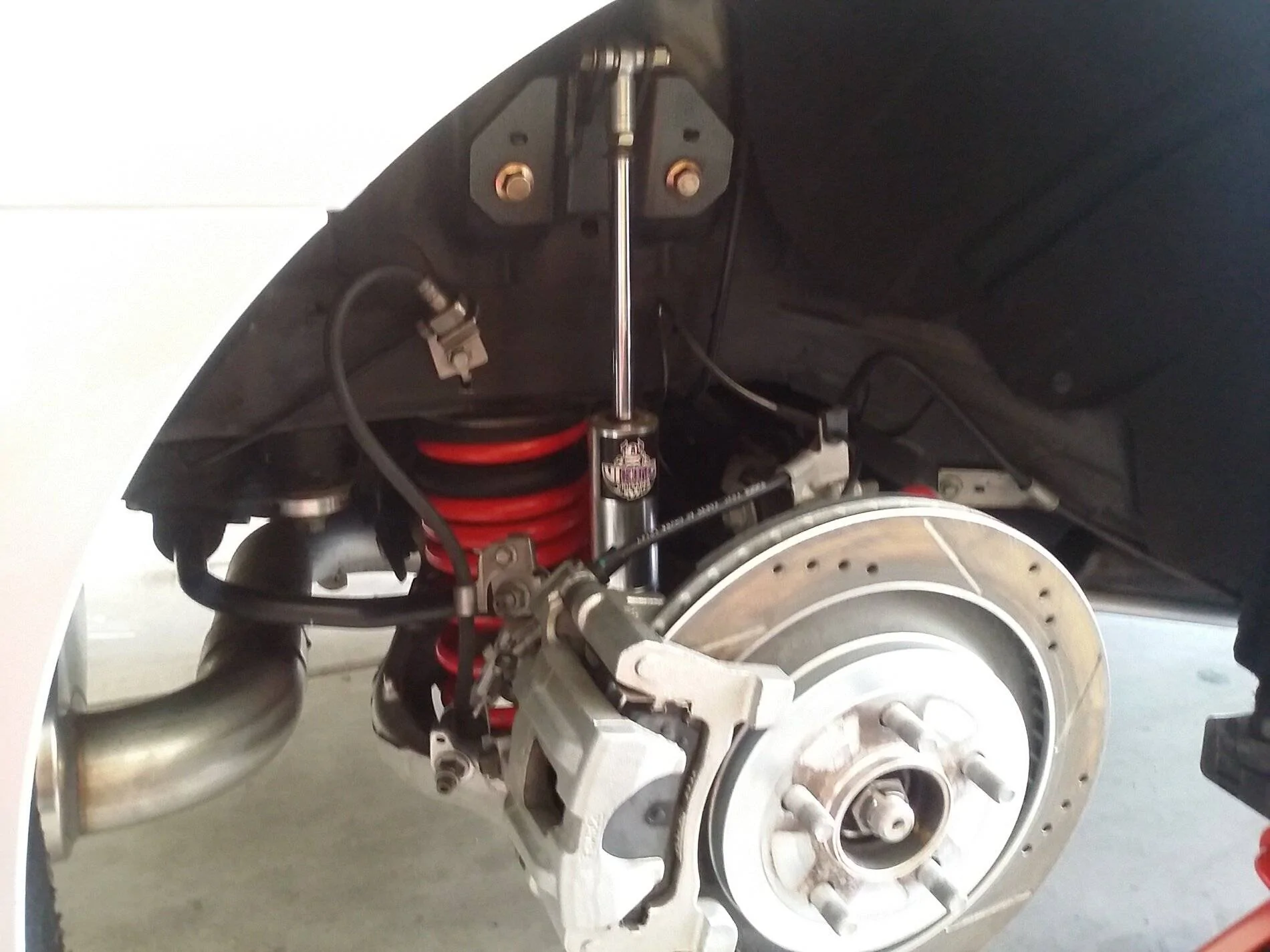

Right now stock shocks , as for the rear there have been some upgrades . Viking shocks , basically a stedea stop the hop stuff , bmr shock mounts and vertical links . I'm boosted so was working on get the rear to hook .

If your going to change springs that is good time to update the upper strut plate on the fronts , you will want an adjustable one so you can adjust camber and camber . Also if you want to change the front struts this is the time to do it . Struts and shocks control coil oscillation, hence will bounce if there is no damping , strut , shock . A strut is also a suspension component as compared to shock .
