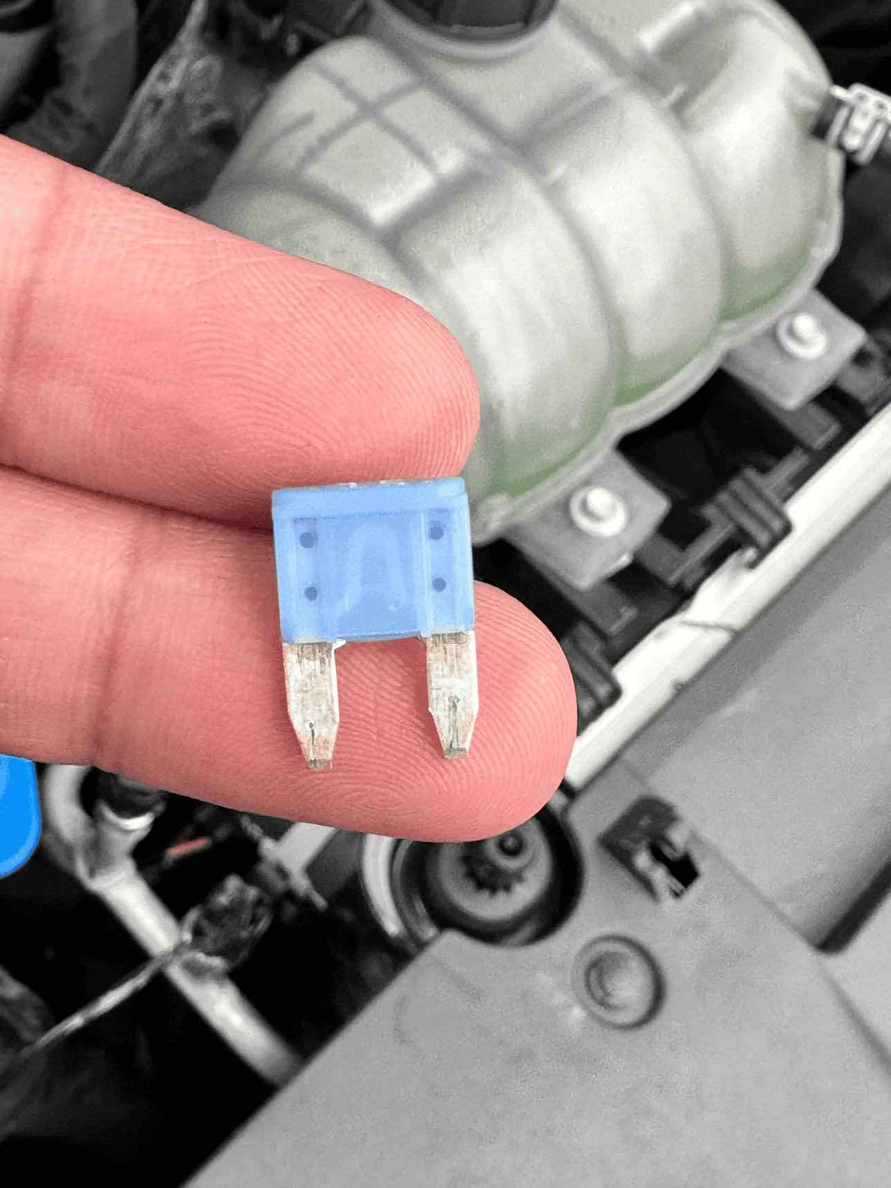

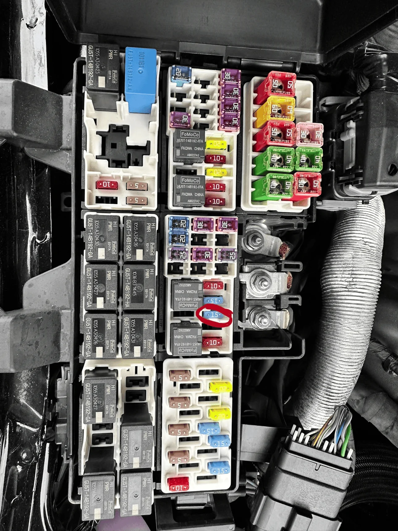

I checked the fuse today and it seems to be fine. I am also not getting any error messages like some other folks have reported.
Do I have the right fuse identified above? That's the one I pulled and it seems fine.
Any other suggestions?
